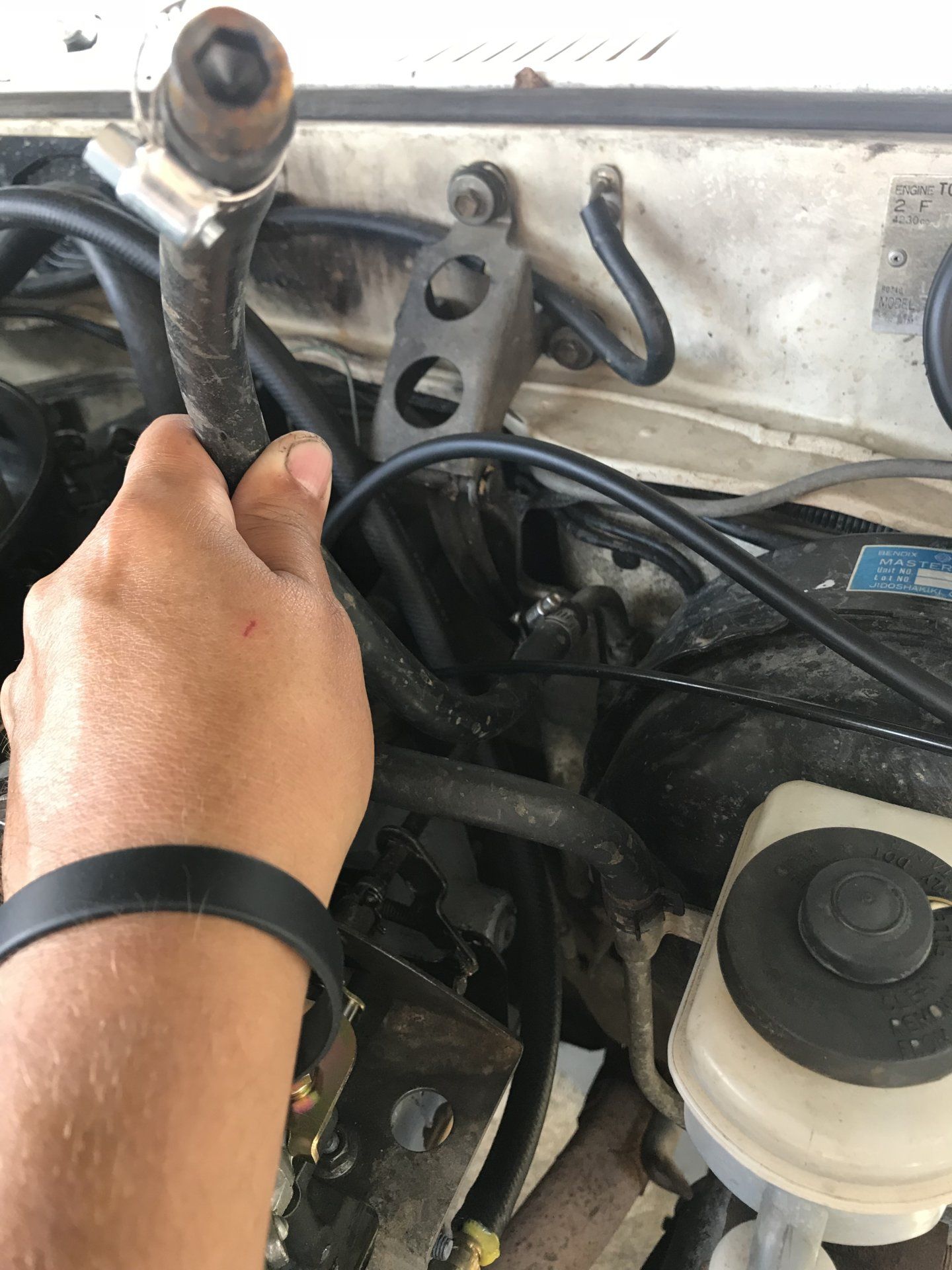

So where do I go from here? All that stuff is no longer on my truck. I’m assuming I have a vacuum leak, or misplaced hose somewhere which is why I have low vacuum.
Once you hook it up ...listen for vacuum leaks on the other side of the engine at the firewall or coming off a loose hose.
Did you say you have no (edit) charcoal canister? See if you can plug and unplug the vacuum lines and tell where this is pulling vacuum.
I don’t have that port on this new carb.
I have the port on the front shown plugged with a red cap and a port on the back that is attached.
What is the vacuum canister?
The vacuum is coming out of the top of the carburetor. Is that normal? I cant hear any other leaks over that one. If you put your hand over it, it will suck your hand to it.

I sprayed carb cleaner at every spot I can find and the engine never rev'ed up.
I did unplug that red stopper on the carb shown above and the vacuum improved, but it went up to around 15 vrs the 11 its running around now.
No. It's wrong. the vacuum line on the outer port of the dizzy vacuum advance is for HAC system and goes to the vacuum line hard line behind the t-stat the one that has a small vcv on it. It should not be going to the vacuum charcoal canister. The vacuum canister hose that goes there ( the middle port on the canister) is hooked to the hard line on the firewall but I can't see what if anything it is attached to on the other end...you are zoomed in too much. Come out and video 1/2 the engine bay and pan around slower.
The second line you put your hand on...the inner port of the dizzy vacuum advance is going over the valve cover and under the air cleaner ...it should hook to the advancer port on the carb pictured here:
