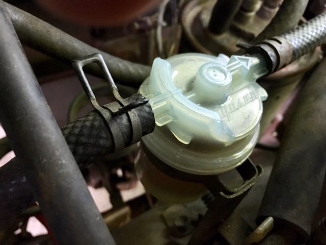

Gonna guess that material was from the fuel hoses. I’m glad it worked. Check out your fuel filter too. And maybe start working on replacing the soft fuel lines. Just buy a roll of 25’ and do a section at a time.
Fuel filter is new.
What kind of fuel line? Anything specific?
Fuel filter is new.
I’m not the one to ask specifics. I just know I bought a roll at one time of 25’. But you could look up in the fsm or just take a few pieces to a auto parts place and have them match it to stuff on the shelves.
I also meant look close at the filter, see if you can see any similar debris in it.
Felicity, you’re talking about the filter inside the carb, right? Not necessarily the filter near the passenger firewall...
If you are doing new hose be sure to get something that’s rated for ethanol. There is a clear reinforced fuel hose available that can be nice to use as you can see through it enough to tell if it’s flowing and is clean. It’s good for low pressure applications and just have to confirm it’s rated for ethanol in todays fuels.
