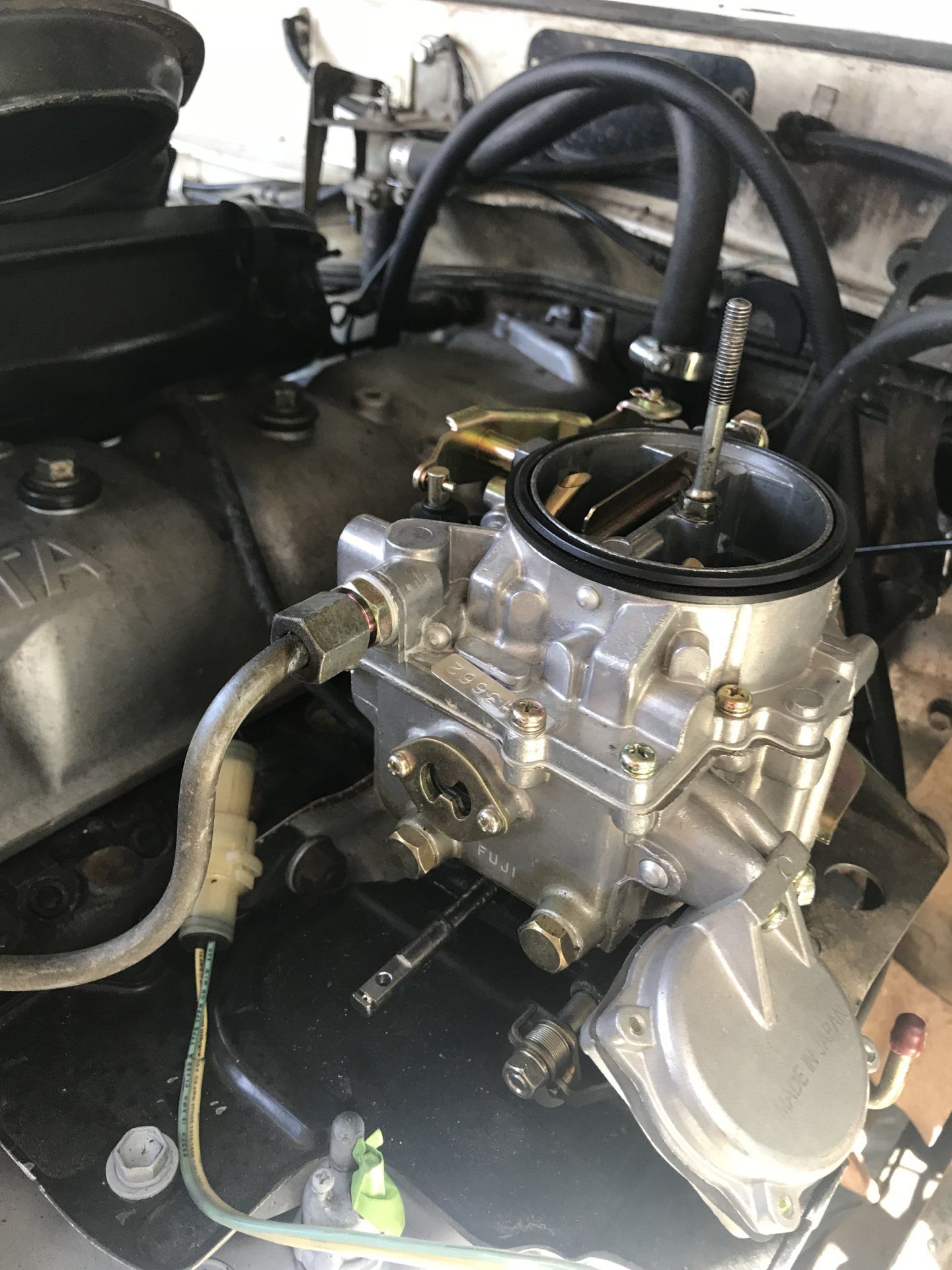

Tonight I did the idle mixture screw adjustment. It was straight forward enough and helped but I think I’ll be doing a carb rebuild anyways and getting some propane to check for vacuum leaks. Also need to check my valves too. Depending on how they are I may do the lean drop again. Didn’t have a vac gage handy this time but next I’ll have one.
I’m working on the truck now. I have the carb adjusted some and the idle is around 700 ish on the dash. I have black smoke from my tail pipe though.

That’s above my pay grade I think. This is a brand new carb. Maybe I’ll call cityracer.
He can tell you the jet sizes installed in the carb. You're probably OK because I would imagine the default jet sizes would be appropriate for at or near sea level.

When I hooked up my City Racer the first time the truck was idling so low I was barely able to distinguish it was running. It was around 300, I was blown away.
How much black smoke? And yeah you need a vacguage asap. That would really really help, simply to know if your holding well too.

If the city racer carb out of the box idled at 300rpm it’s very likely set to a basic default. Did the carb come with any docs on setup?
The lean drop tune works....I think....because as you turn the idle mixture screw CCW it leans out the carb and that causes the rpm to increase. I bet you could turn the idle speed screw back to get the idle down to 300ish....just enough to hold the idle. Then turn the mixture screw CCW 1/8th to 1/4 turn at a time and listen for increase in rpms. Reference the dash tach for now. Keep turning that screw out until the rpms stop rising. If the engine speed increases a lot in the process you can slow it back down to the 700 ballpark with the idle speed screw. This wont get you to the end setting but it may get you closer until you can get some proper gages.
