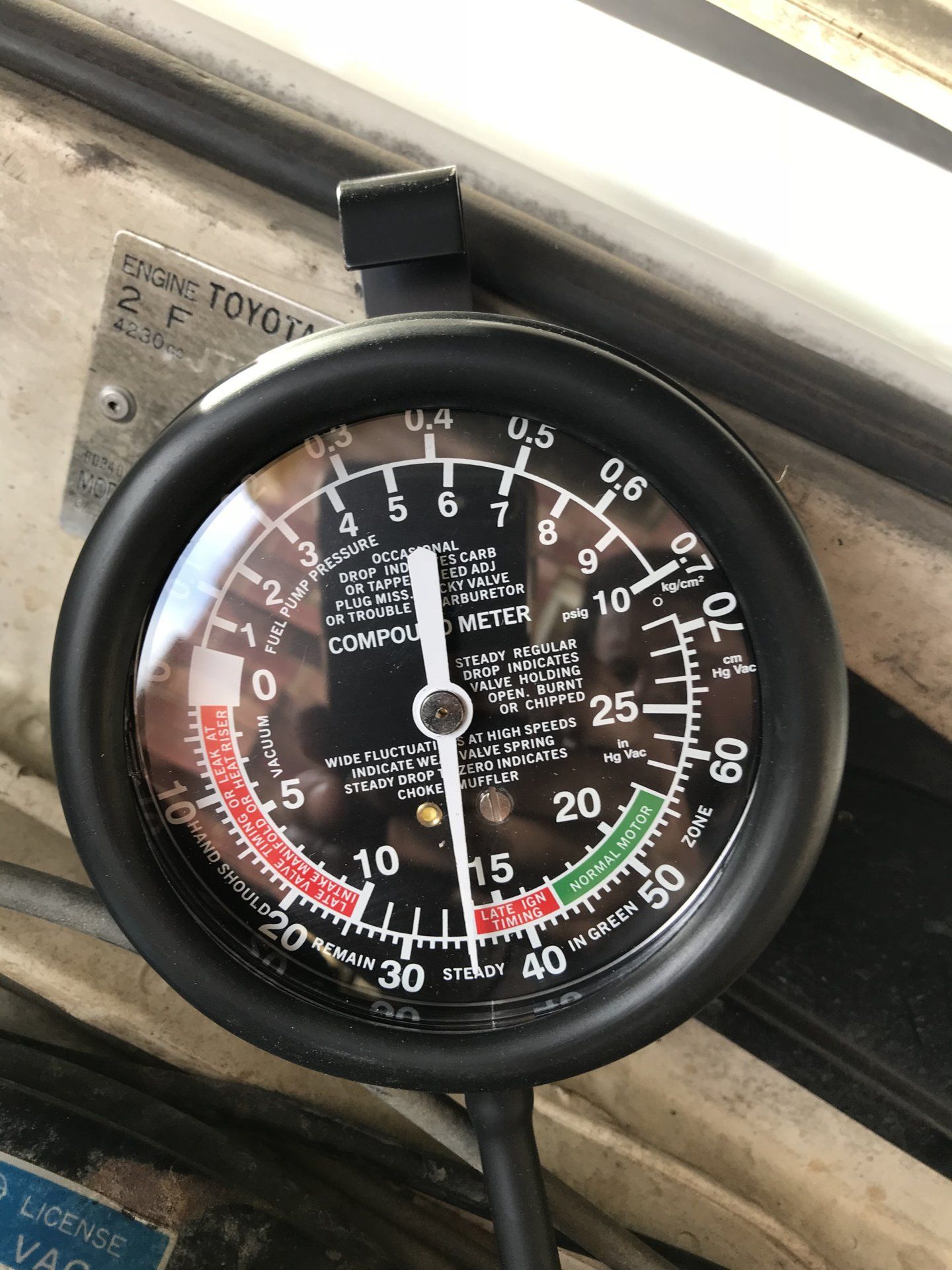

Vacuum is hooked up on the finned booster on the manifold.
Your not getting very good vacuum then, if I’m way off I imagine someone will correct me. 14 seems fairly low and since your not at elevation I would be concerned that your loosing air somewhere. Often hoses are stiff and brittle which means you might have a crack in one or old gaskets on the manifold or the egr. You can take a bottle of carb spray w/ the red straw attached and while truck is running w/ vac gauge attached too, spray spritzes at the base of the carb, where the manifolds meet the head, and below the manifolds where the end horns meet the exhaust section as well as where the egr goes in the intake and exits the exhaust. I’d have to look back to see but if your smoged but the last few spots may require some interesting physical contortions, looking back I see it is in a redneck way. If the rpms rise then you’ve found a leak.
When I had the breatheron I sprayed cleaner everywhere and found no leaks.
All gaskets are new.
