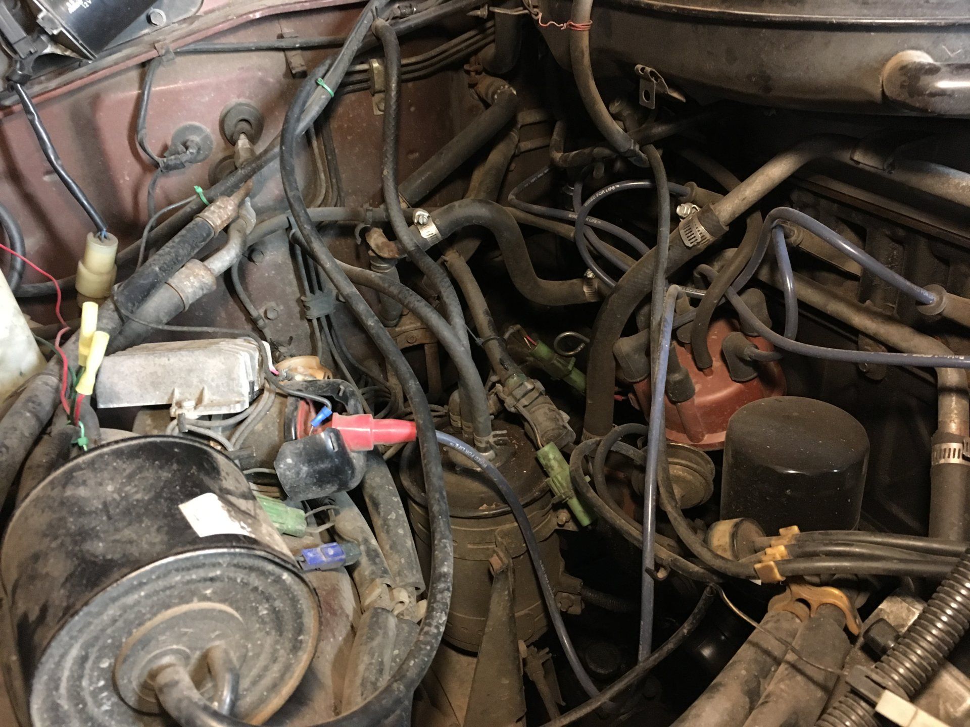

I have almost no increase of rpm's. How is your vacuum hosing ran? Post some pics.
I have evap and charcoal canister as well as the driver's side VCV. VTVs on both the carb and distributor are present. The outer vac line on the distributor advance runs to the air cleaner. Sorry the wiring is messy from a desmog I didn't do, but it ran well albeit tuned to compensate for the vac leak.

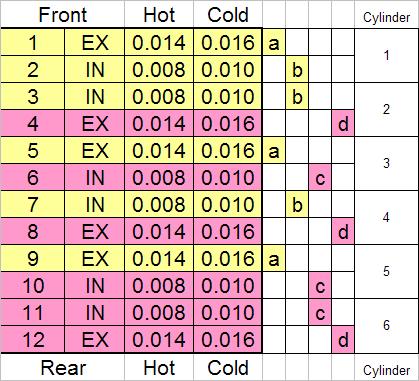

Yes the valves were installed but after the head was put on the truck were the valves adjusted? Here is a guide to adjusting the valves. Put the TDC line on the flywheel to the top pointer, then with the rotor pointed between the 3 and 4 plug holes you will have piston #1 at TDC then adjust the "a"s and then the "b" valves in the chart below. Next move the flywheel around again and put the TDC line to the pointer, this time the rotor will be pointing away from the motor. now adjust c and then d. The 1st column is the rocker you are working on starting at the front of the head. The second column is whether it is an exhaust or intake valve. 3rd column is what you adjust to if your engine was warmed up first. You'll need a feeler gauge and a 12 mm box wrench and a screw driver. Before you start, make sure the rocker rail studs are all the way seated in the head by backing off the nuts and doubling up 2 nuts and tighten them against each other on the stud threads. Then use the top nut to turn the stud to make sure it's seated in the head.

Yes sir, I did that.
what other open pipes or hoses to you see?
what did you hook the secondary vacuum port on your dizzy vacuum advance to? Looks like the metal vacuum lines have been removed.
what is that yellow foam looking stuff on the pcv hose where it goes into the elbow on the intake below the carb?
are you sure your hitting on all 6 cylinders...ie you don't have a bad plug wire etc.
There's several open "items" under the hood. Most are probably fluid hoses, i would have to check when i get back to the house.
No where, The instructions i saw said leave it open.
That foam stuff is just from the fitting i used.
I'm running ruff, for sure. I have new Toyota plug's and wires that i haven't installed yet. The wires installed are only a month old though, they are just $20 wires. (i was just waiting to install them once i was running better)
Pull each plug one at a time, put the plug wire back on it and hold it in a pair of pliers with rubber handles and look for spark jump between the gap while cranking (but not running) the motor. Double check your firing order. Install the new plugs and wires ...test running it isn't going to fowl them that quickly.
