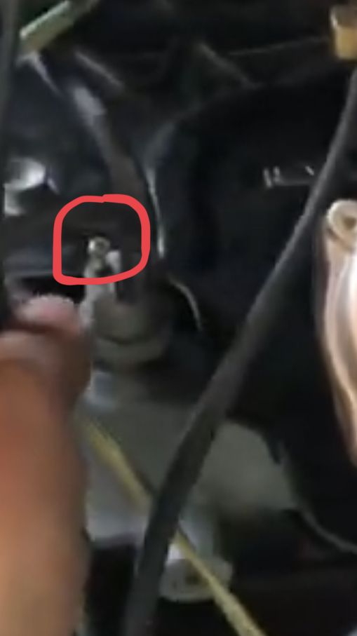

Is your gas filter port open? That’s a giant vacuum leak if it is...
Probably not....but it was hard to tell in the video
its a screw stuck in it.
You can replace those w/ a one port connection. Someone posted a thread w/ them. I’d replace it if I was you, they are known to develop leaks around the 5 point part, whatever that’s called. And clearly it does since it’s laden w/ some sort of hardened sealer.
