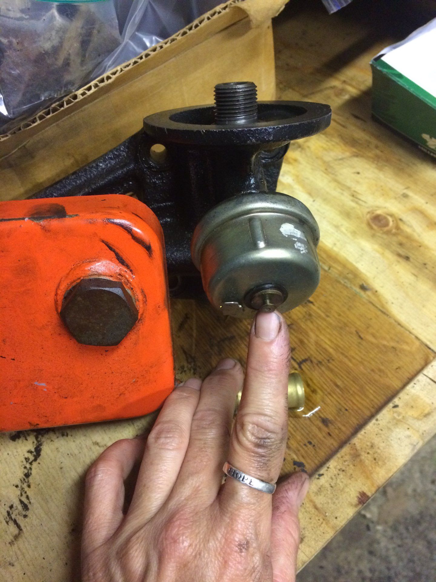

My oil pressure gauge stopped working though. So I need to find that.
It was running kinda fast at idle, around 1400rpm. I adjusted this back to 700ish in the parking lot. When I turned it back off, it quit like it should.
Temp went down as soon as we were moving.
That’s your oil sender. Be sure the wire clip is plugged into that circular nub, not the flat spade on the side.

I do not have a working carb fan. It’s there, but the wire was burned in half.
I saw that sending unit. A lot of work happened around it this last week. So maybe it’s just the wire came loose.
Strange View. Top left is the carb fan. You can see the plug for it below it. The bundle of wires wire from that plug has the fuel solenoid wires and this burned in half wire.
There's the oil sending unit. No wire attached. However there is a bare wire very close to the unit. Being that it worked before all this work, I must have broke the wire off.
All easy remedies. We can walk you through the carb fan. Do the sender first. Add a female plug to it that will hook to the center nub. I think it’s just an 18g wire. Put a rubber cap or a 1/2” length of silicone hose over the side male spade so you don’t inadvertently clip to it. If you do it will fry your gauge.
Typically there’s a black rubbery cap that goes over the sender that holds the wire inplace while it’s on the nub. You may have lost it in your drives unless it was gone before. But guessing where it broke was where the wire came through the cap.
For now for the carb fan, add a few inches of 18g to as clean a stretch of what’s there and ground it to the fender. It should come on when you shut the truck down.
To do it right will require a fair amount more work so half assing is totally acceptable.
