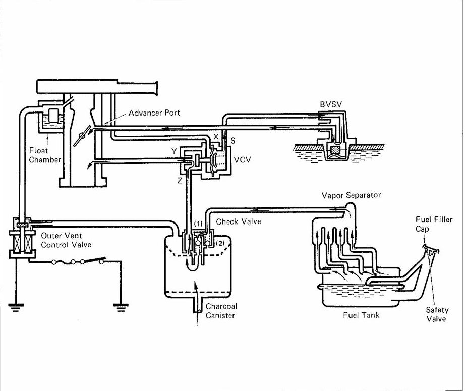

I just ordered the VCV's from CityRacer. I'll stop by Napa and get some t's and 6mm hose. I have the Toyota 3mm hose already.
I noticed in an earlier post you said you removed the BVSVs ...but the violet (upper) BVSV is part of the EVAP circuit and if you're ordering the VCV for the evap you may want one.
Also the hose on your firewall behind the carb that you didn't know where it goes...it does go to the carb bowl (float chamber in image) of which you don't have a port.
My vsv just showed up, so we are going to try without them first.
I think if you eliminate the upper BVSV and replace it with straight vacuum then the charcoal canister just starts working when the truck is started vs after it warms up
In comets picture, of the passengers side vcv, what is the gas filter he's talking about? That's my last connections.
you have the Z port of your evap VCV going to the large hose on the firewall that was supposed to go to the float chamber of the carb.
There is another metal line on the firewall that comes out under the carb blower close to the driver's fender and is supposed to go to port Z ...so is that line blocked? open?
