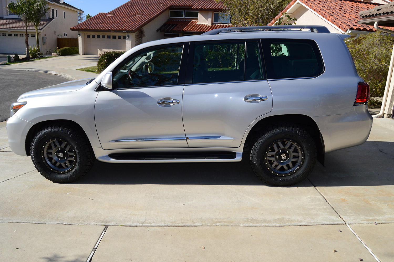

I decided to go with something similar:
18" - KMC Wheels XD128 Matte Grey 18x9
-LT285/65r18 Toyo open country AT II (32.6"h 11.5"w)
Front mud flaps had to be removed because of rubbing. After removal things seem to be fine. Not sure why they were rubbing as the tire dimensions are almost exactly the same as the TRDs with the LT285/70r17 BFG KO2 are (32.7"h 11.5"w). A little noisier than the street tires that were on there but that's pretty much to be expected. Looks and trail performance are thousand times improved!

Damn that looks great!!! They were rubbing because you have a 9 inch wheel with +25 offset(guessing). This wheel combo pulls the tire out well over an inch over what the TRD's would be.

Looks good! Do you have a view down the side or top of the wheel well? I'd like to see how much a 9in wheel with a 25 offset sticks out. XD makes a 17x9 +18 but I think that would poke/rub too much with a 285/75. Maybe some light strategic hammering and fender work would make them fit?
