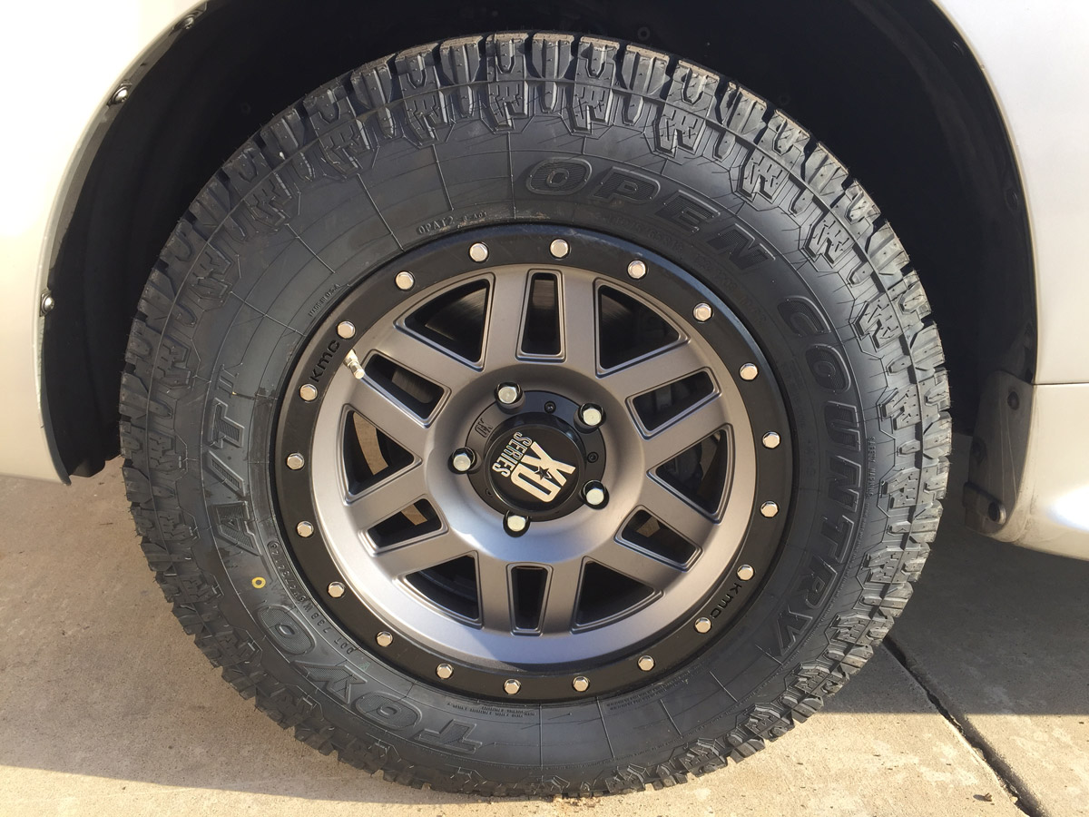

Looks good! Do you have a view down the side or top of the wheel well? I'd like to see how much a 9in wheel with a 25 offset sticks out. XD makes a 17x9 +18 but I think that would poke/rub too much with a 285/75. Maybe some light strategic hammering and fender work would make them fit?
I'm running 18x9 with a 20mm offset with 285 70 R18's, I think 18mm would proly work but it gets real tight on the tuck! brand of tire, side tread, actually tire size etc would all play a huge roll. Long story short I think they would work.
Yeah I spent a few mins looking at your pics and running the numbers in a wheel offset calculator. I think it's doable too. It would be another 17" option besides RWs and I definitely want to stick with 17s for the extra sidewall.
OK, basically after a little driving they still rub in reverse on turn. Also I don't like the Xtreme treads on the Toyo OC II, they hum a little too much on the freeway. I'm going down .5 inches in height and width to a LT275/65R18, same tire but not Xtreme. That ends up 32.1" diameter. The wheel itself is 25mm offset. I'll post an update after the new tires get mounted but I think it should take care of any rubbing issues.

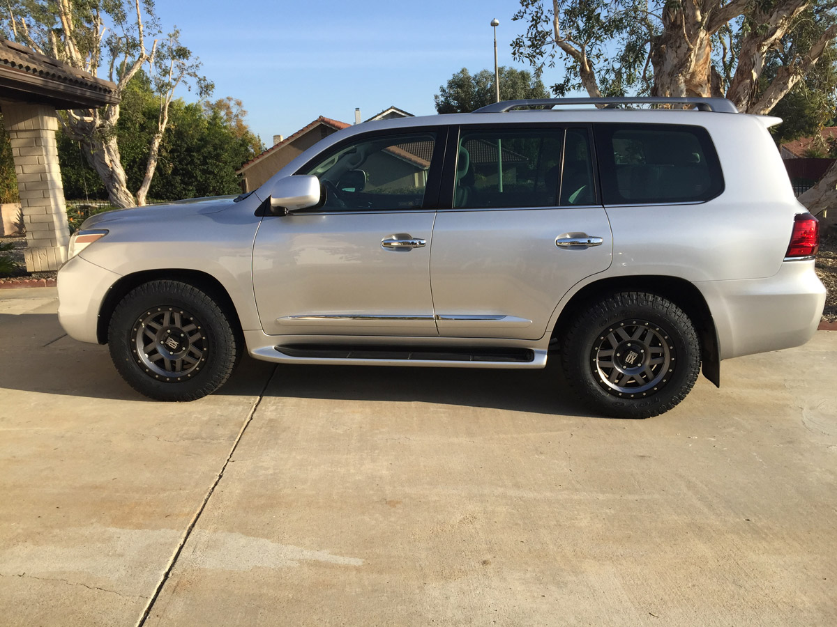

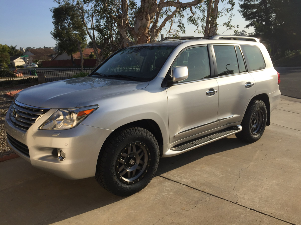

LT275/65r18 = 32.1" Toyo Open Country AT II
Its basically 1/2 inch smaller than the previous tire (1/4" height difference) and no rubbing issues. Not much to cry about going from 32.6 to 32.1. Very happy with the setup, the TRD rock warriors were not really an option given the expense and difficulty to acquire. The offset of the wheels I think forced me to go a 1/2 inch smaller. Other than TRD wheels there was almost nothing for this application available in 17". 18x9 is the most common and available sizing. I don't honestly see much of a difference and am happy there is no rubbing. This is height in "N" position.

The Toyo's look pretty dang beefy. Also, the dark rim looks great on the silver. That's why we stayed away from the chrome rims during our search for the LX.
