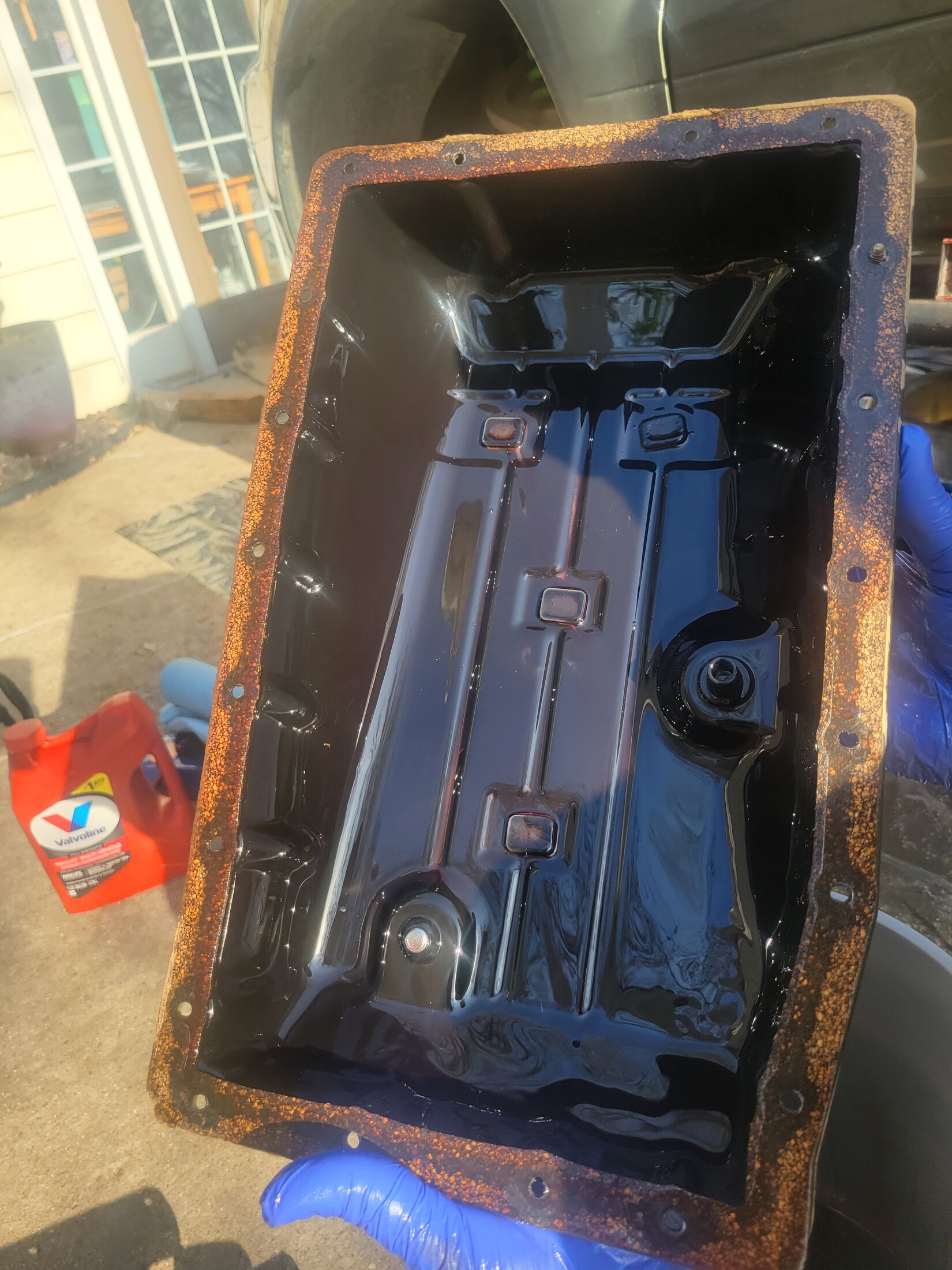

Here is mine at a pan drop from April. It had been just 2 under years since the previous pan drop (for a Nomad valve body installation). Not too bad, but definitely some gunk in it (clutch friction material). I think that after 5+ years, these would get gunky, especially considering my Nomad valve body is likely reducing clutch wear relative to a stock trans. I probably won't drop the pan again until 2027.

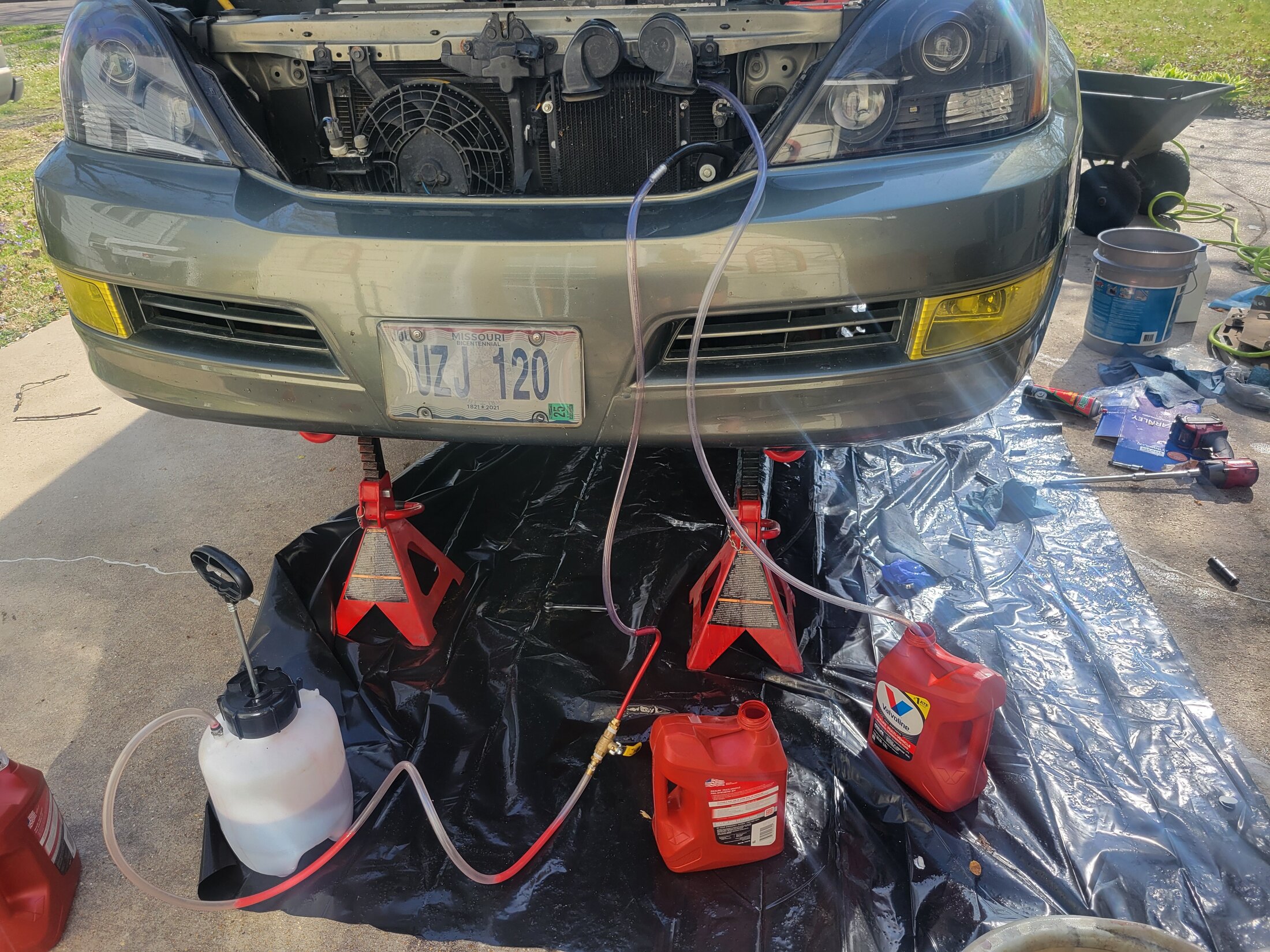

I drain pan for about 10 minutes, measuring ever drop that comes out.
Install drain plug with new washer (gasket) and torque to 13ft-lbf.
Then add back what came out, plus ~1/2 qt. through dipstick (98-03)
Then use engine to pump out of, A/T cooler return metal pipe niple to catch can. As I add through dipstick. Measuring even drop out and in.
I underfill until later, during topping procedure at 156 to 176f A/T #1 temp. Since easy to add more through dipstick (98-03).
In non dipstick (04-up). I overfill by ~1/2, than drain off excesses during topping procedure at 96f to 115f A/T #1 temp.
I use only Mobil 1 MV ATF in 98-02.
I'm now using Mobil full synthetic in 04-up (note this is not the same as Mobil 1)
Amazing! This is pretty much my plan. What size hose do I need to connect on to the cooler nipple? Do you have pics or a write up of exactly which nipple you are extracting from? Thanks!!

The hose I disconnect from A/T oil cooler return hard line pipe. I've never had leak afterwards. If it did, I'd replace with OEM hose.
Over the years, I've done full 12 qt flush at least 400 times in 100 and 200 series. I've had only good results.
My feeling is, if one ever did fail afterwards. It was a bad transmission. May as well find out during PM, than 200 miles from nowhere.

There's nothing wrong with pulling the A/T pan (cover). In the 98-02, they're sealed with FIPG. In the 03-up, they uses a gasket. Gasket is easier to deal with, hand down. The screen (filter) never needs replacing. But if one removes screen to clean. It's gasket, then should be replaced.
The only benefits to pulling A/T pan. Is the magnets can be cleaned of particles.
Will we notice any difference in performance, if pan pulled. No!
Will it help to increase life of A/T. Not likely. Why? Because, particles on magnets tend to stay on the magnets for ever.
If DIY, go for it if.
If paying to have pan pulled. Save the money! Use cash savings, for full 12 qt flush, every 60K. Rather than a drain and fill. ;)
