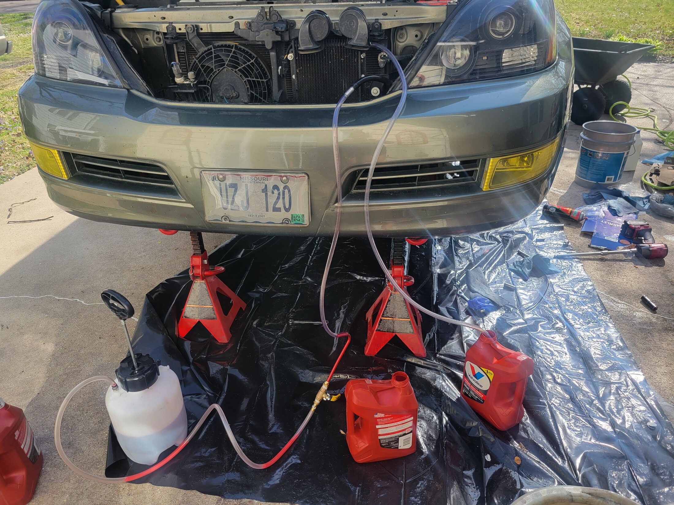

On my GX470, that is the procedure I used. I put a hose barb in the outlet hose from the cooler (line that runs back to the transmission) and routed that into a jug for used fluid. I would then start the engine, have a helper run the trans through all gears (with the rig up in the air), and wait until about 2 quarts came out. Then refill with 2 quarts. Repeat until you get clean fluid.
Setup on my rig (I used a Motive Power Fill due to no drain plug).
Super helpful. Did elevating the truck help with the exchange?
Yes, it needs to be elevated to allow a helper to run the trans through P-R-N-D-3-2-1. I also drop the pan to clean it and replace the filter when I do an exchange.
