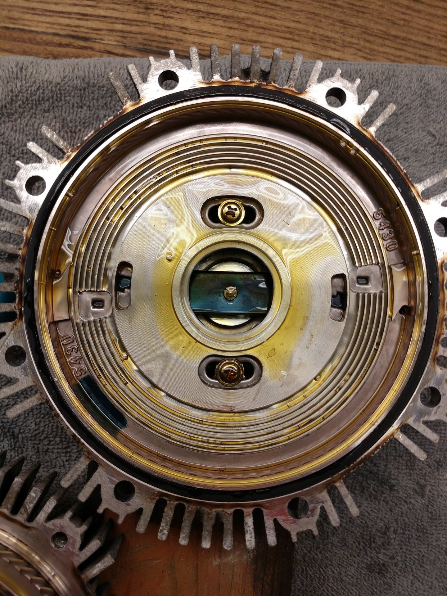

Don, the clutch did not have any leaks in it. I got about what I put back in ,out. It's sort of hard to tell as it is so thick. When I pulled it apart I wiped a lot up with paper towels on the exposed surfaces. And, then drained it. I didn't really measure what I took out since I knew it wouldn't really be very accurate anyway.
When I split it, the adjustment screws were in the middle of their adjustment. To get it to open at 95F I moved them almost all the way one direction in the slot. I wish after I had done it that I had heated it to opening just to see where it was set at before. But, I had already moved it before I thought about it. Doesn't really matter, but now I am curious.
In the picture you can see how far I moved it.

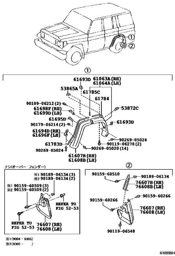

Has anyone found a product to use in place of the
61784. Pad, Rear Wheel Opening Extension, No.1
61783-60020
Some of mine is cracked up ,but I would rather just buy it by the foot and replace it all instead of paying 10-15.00 each for all of them.

Would something like this work? Fender Flare Trim
My brother is having issues with it falling out on his HDJ81, it would be good to find an alternate product.
I had looked at a similar trim. I think the problem is it being convex instead of concave. I would think you would have trouble getting it laying in there flat.
Might be worth a shot however. That stuff is usually pretty cheap.

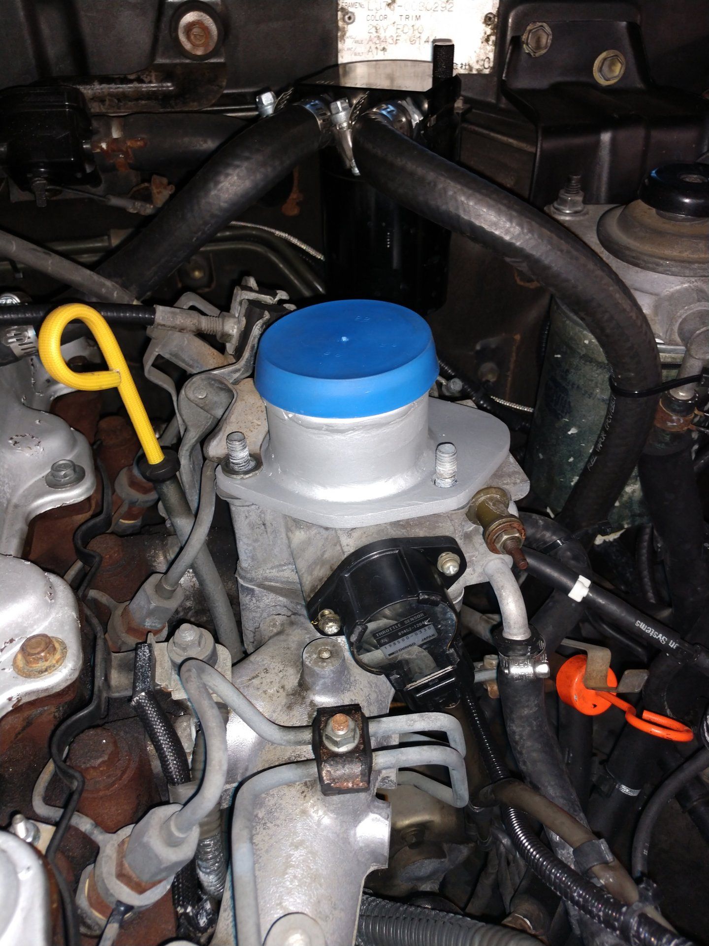

I am using an intercooler similar to the ones several others have used. It is the 11"X9"X3.5" core but with 2.5" I/O instead of the bigger ones. I didn't want the step downs in the hoses. I made the intake flange with a 2.5" inlet for the same reason. I will use 2.5" all the way from the turbo with only the one step right at the turbo.

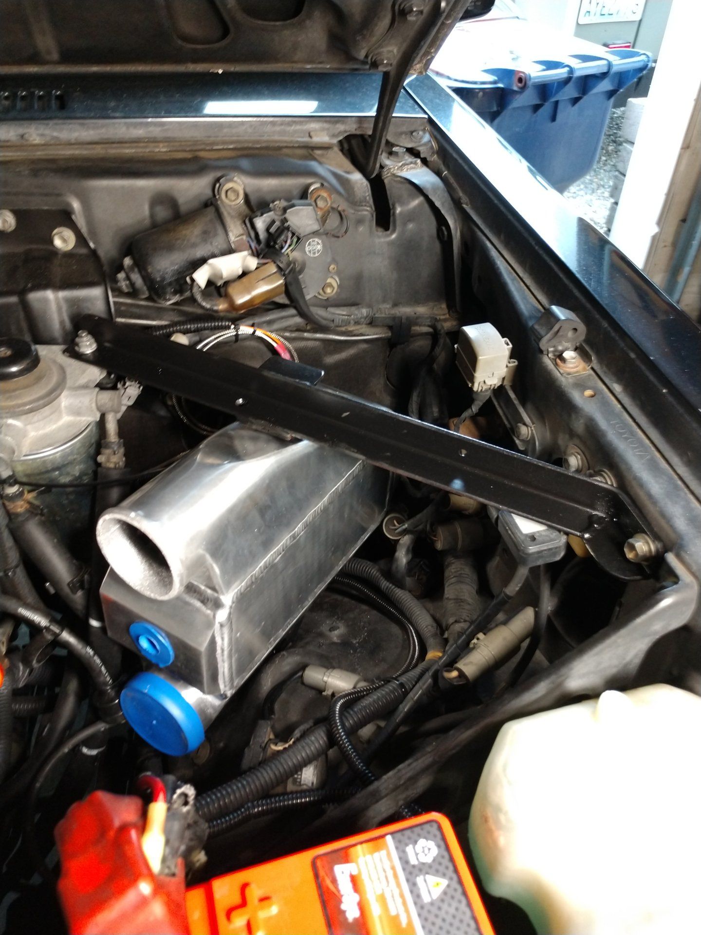

Got the preliminary portion of the mount worked out I believe. I will build the bottom mount tomorrow and make sure it's all works and is not touching anything. I really didn't want it in there on an angle, but once I started seeing how it fit various way, I understand why everyones is at an angle. It would be doable other locations, but would take some gymnastics to make it work.

Right on Kris! Looks good so far. I run the Bosch pump too. Mine runs full time (has for the last 6 years). I pulled it apart to check the brushes this year, and they were about 90% still!! Definitely a well built pump.

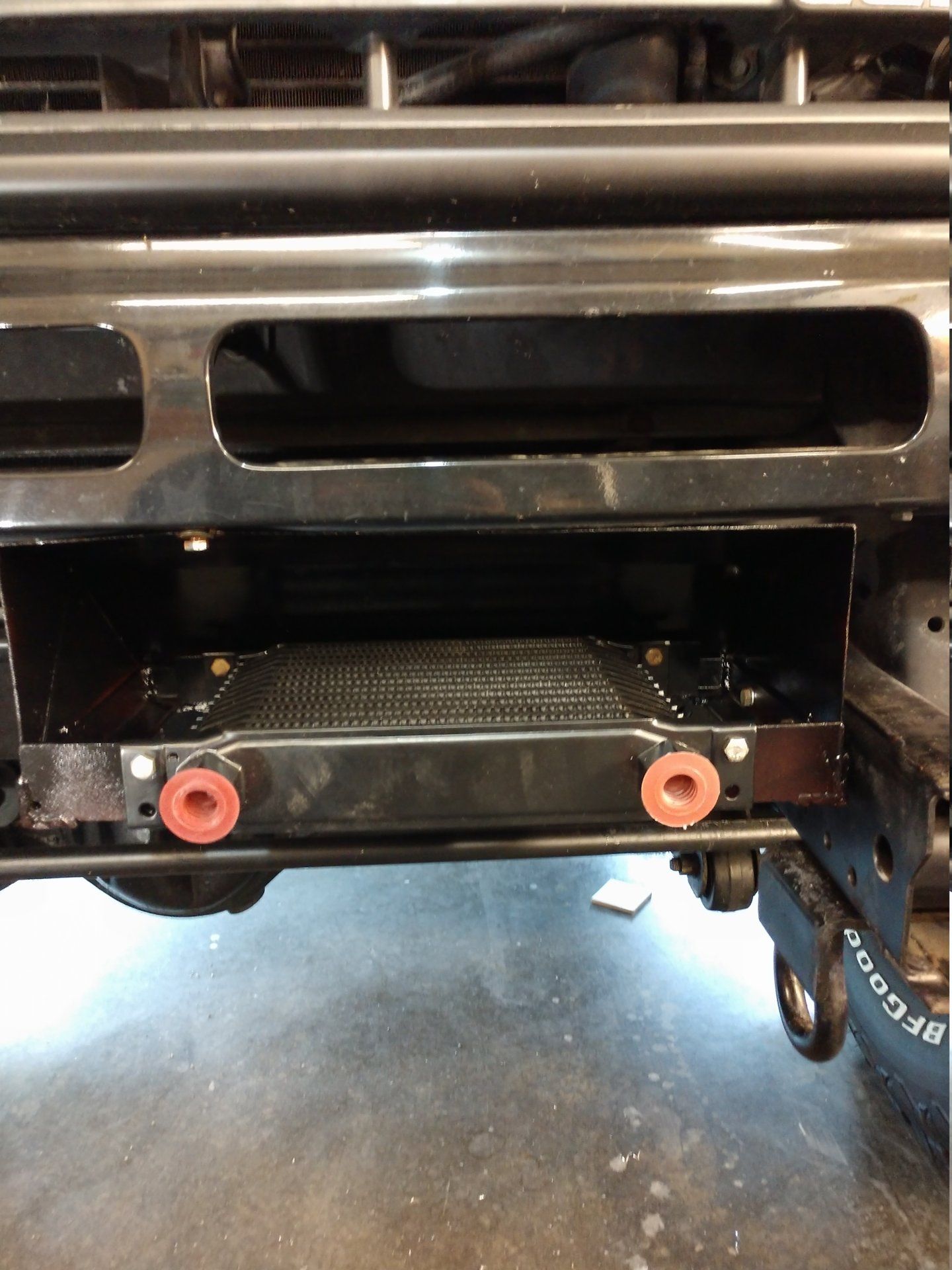

I built my radiator support and scoop over it Saturday. I think it should work like I planned. I test fit the bumper and it gives it almost 2" of clear space at the scoop. This theoretically should force air directly over the radiator. I will likely build some sort of protection on the bottom at some point. But, for now, it should be fine. I will have to redesign when I build a winch bumper, but maybe not if it is far enough back. Pump will mount to the left on crossmember.

That is quite an innovative way of mounting the intercooler radiator in the front. I like how it doesn't block the radiator. My intercooler fills the two oval holes in the piece above the bumper. Which is great for the intercooler, but probably does block some air flow to the radiator.
Will be interesting to see how yours does during testing. If it does start to heat soak, you could put a slim fan on top of the intercooler in the scoop box you made. Would be protected in there anyhow. The SPAL fans pulls some pretty major air.
Hey Nick. Yep, that's the plan if I have heat soak. Try a fan. Those thing do move some serious volume for such a small fan.
I actually made a mistake when I was building it. I got a little fab happy and overbuilt it and in the process, made it wider than I planned. And, then was too lazy to cut it apart and make it narrower.I wanted it to be tighter on the side to stop flow loss around the radiator. It may turn out to be no issue ,or I can cut foam blacks and seal the edges.

So far my smaller radiator seems to be working great mounted horizontally with the scoop under the grill. I used 2" thick dense foam on the sides and in front under the bumper edge to force all airflow over the core.
After a hard test drive the radiator is 110F. It was about 90F and I did all my test runs with the A/C cranked to put the most load on the engine.
