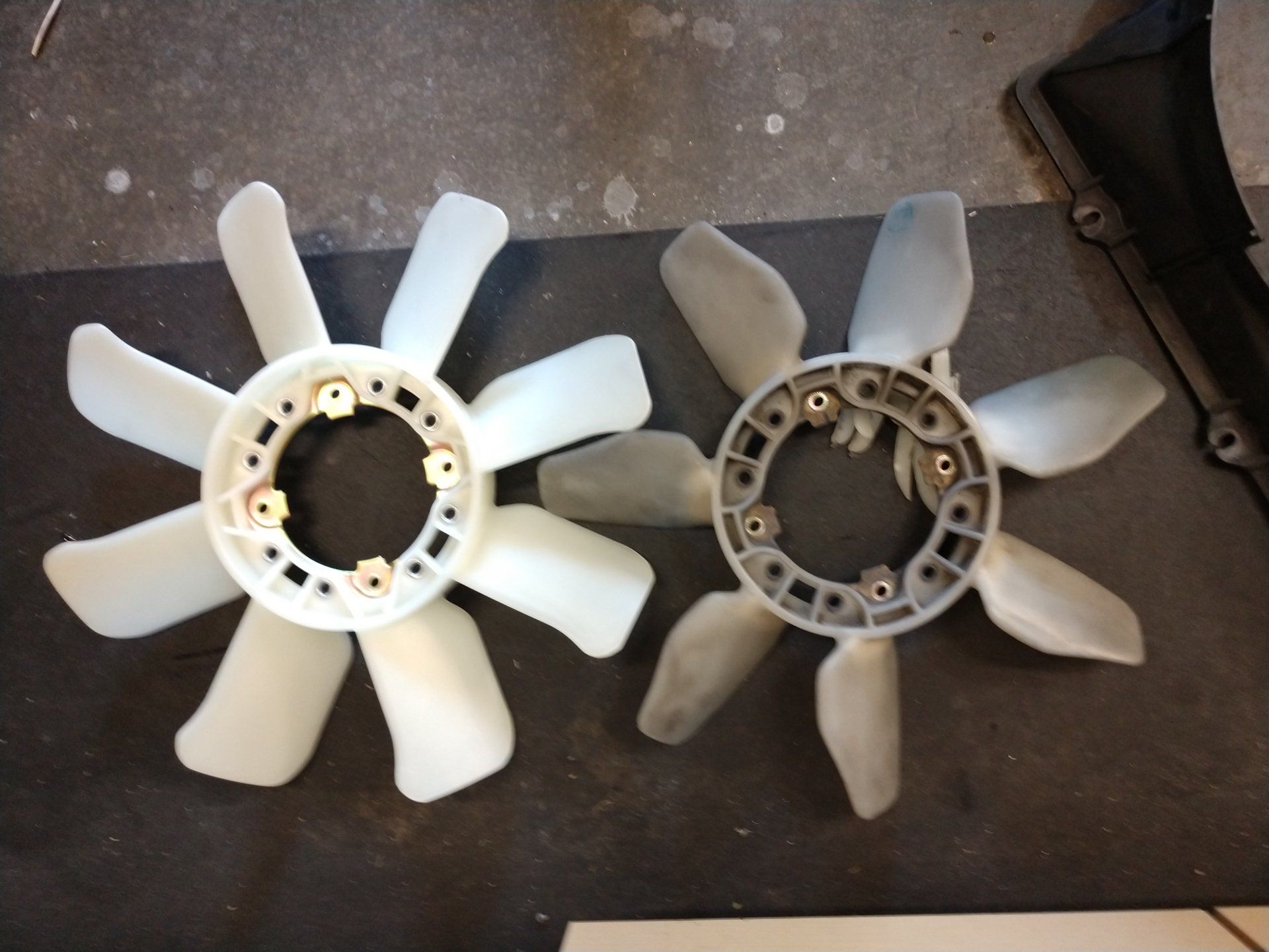

I installed my larger fan as well. Seems the info is correct. That part number we have gets you an 18.5" fan. I cut it down and shaped the blades so I didn't have to modify my shroud. It's 17.5" now. It moves a mountain more air. I noticed it because i can't hardly pour coolant while the engine is running now. It blows it all over. I have done that without a thought quite a few times with the old fan.

Nice work. Strange that part number got you an 18.5" fan. The one I have is identical to my friend's 1990 HDJ81 stock fan (I measured). So that is the part number I posted. I wonder if the 18.5" is the new equivalent part or something. Maybe Toyota felt they needed to upgrade the fan? Strange.
I thought it was odd as well Nick. I knew yours with that part number was 17.5"
And then someone commented the other day that number was to a 18.5" fan, but when I asked where that info came from I never saw a response. Worked out fine, just had to do a little modification. I am super happy with the air coming out of there now. It's a huge difference.

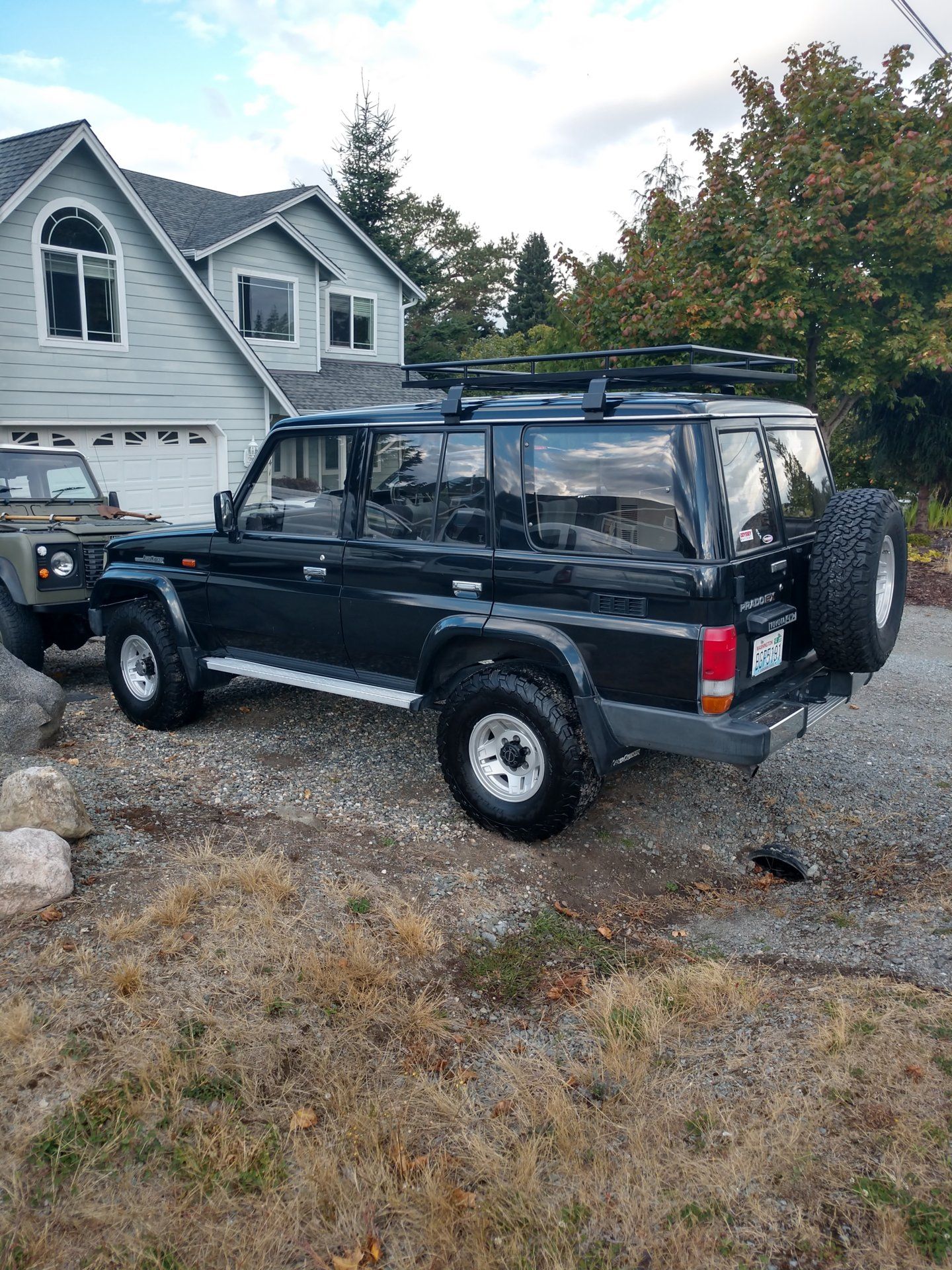

I had bought a stainless 1/2 rack from a forum member a while back. It is an exceptionally well made rack, but I didn't like how the feet worked on it, and didn't like the shiny stainless. So, I cut the feet off, sanded and acid etched it and painted. I bought the Frontrunner feet that they use on the 70 Series racks they make, made 2 - 1/4" X 1.5" bars to span across as the rack was about 1.5" narrow for the feet to work perfectly. Then attached rack to that and the innermost hole of the Frontrunner feet. Came out exceptionally stout for a gutter mounted rack and saved me making an entire rack this winter. Which was my initial plan, but ran across the basket for really cheap.

Nice work on the roof rack! Truck looks awesome and sounds like it's running great too. I spy a fridge in the back? Planning any expedition type trips?
