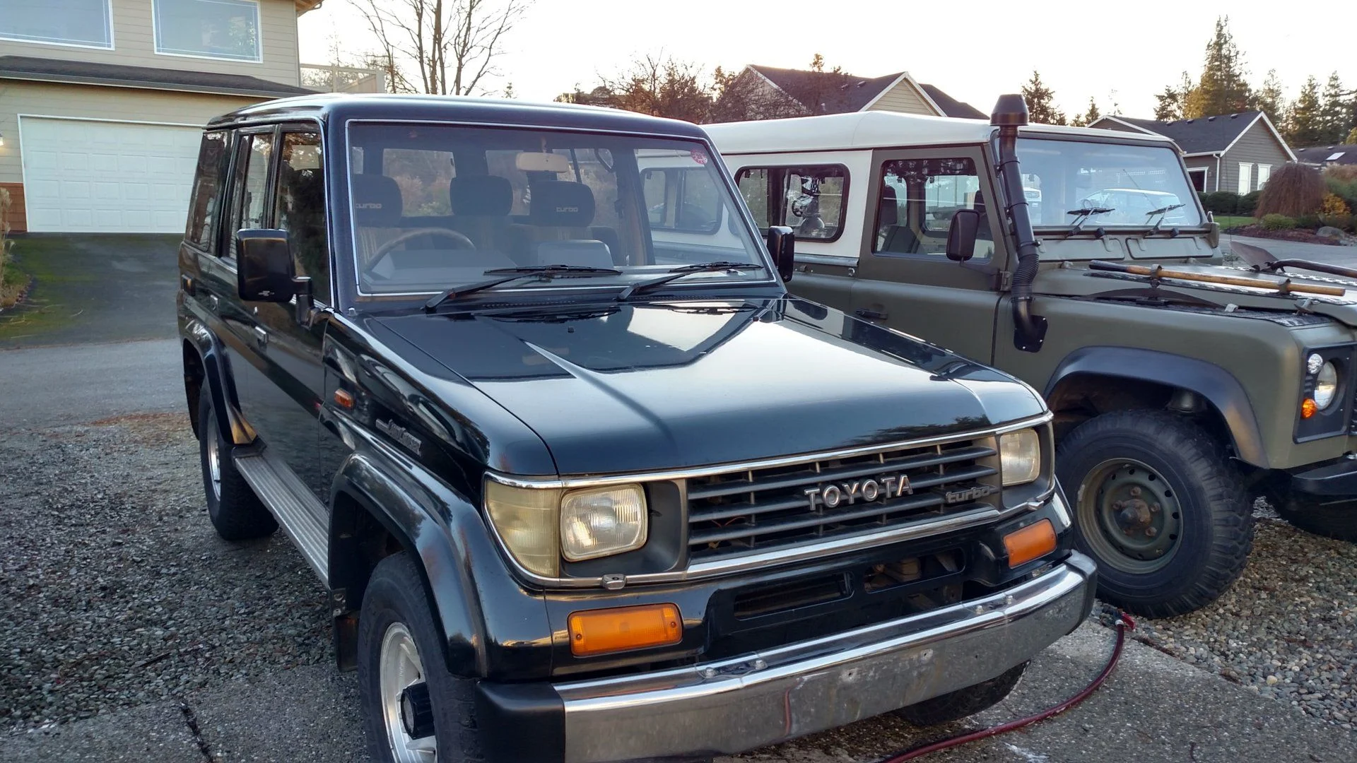

As you can see in the background of my picture, I have a far more insidious hobby than Toyotas. Hopefully Toyotas can replace that hobby after over 20 years. Not sure it will take but I am hopeful.

Sweet looking Prado! Looking forward to seeing what you do with it.

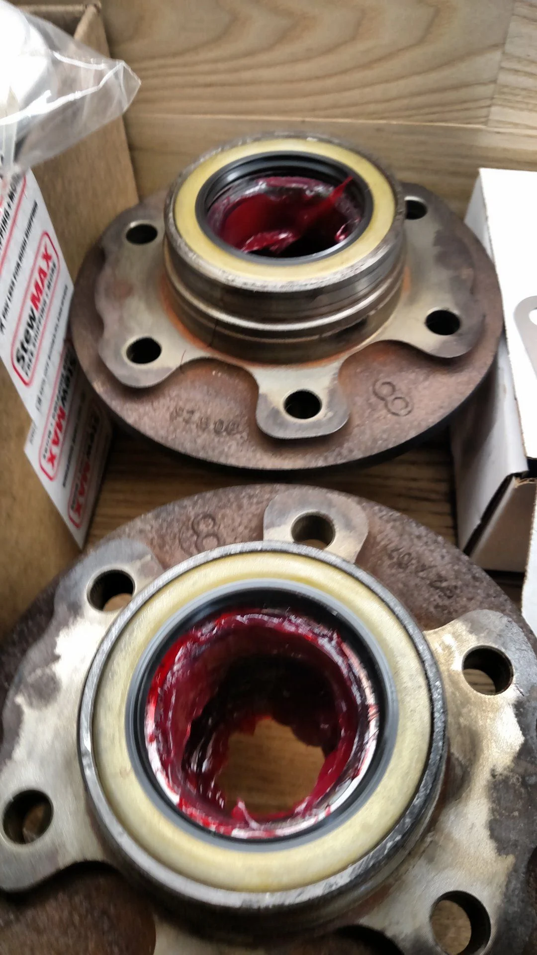

OK, both swivel balls rebuilt. I decided to replace my rotors. Closer inspection when I removed them revealed they weren't in as good of shape as I believed inspecting them with the tire and dust shield in place. I opted for th Napa Premium rotors. I suspect they will serve my needs as well as an OEM.
So, I am waiting on those and the Moly-Silicone grease for the auto hubs. Should see those Wednesday. I will wrap up the front end and then do the back bearings,rotors, and pads. Next on the list for that stuff is tie-rods and bushings.

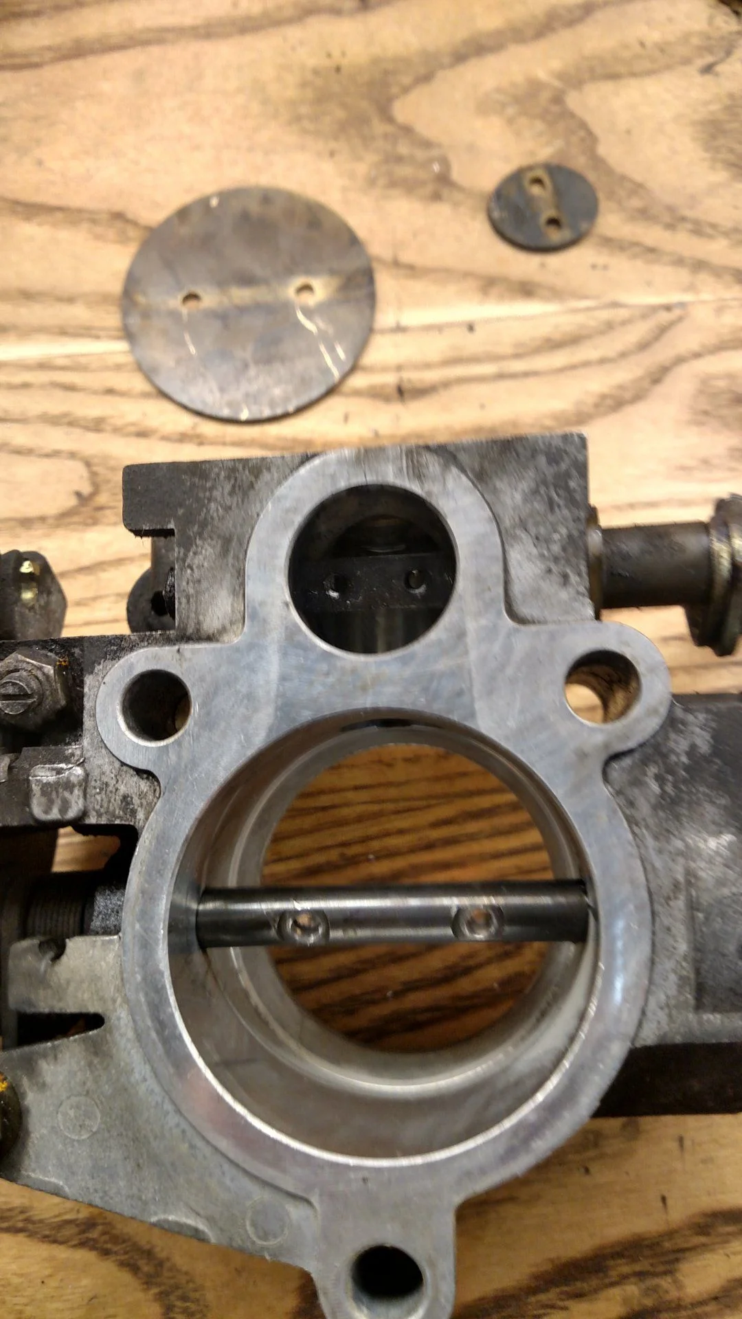

Glow plugs are in fact bad. I have new ones on the way. I figured they would be a lot easier to get to if the throttle body wasn't in the way. I have the EGT system out. Throttle plates removed.Still need to fab one of the 2 blanking plates. I am leaving the pipe around behind the engine until I pull the turbo to do the EGT probe. The nuts on the manifold at a bit crusty. I really don't want to bugger one when it's so hard to access. So, I will just blank off the other end until then.
Over all everything is going smooth and I am really happy with the condition I am finding things in when I disassemble. No surprises yet. Just pretty standard 25 year old vehicle stuff.

Front end all wrapped up without incident.... Hubs tested and I am calling that project done.
