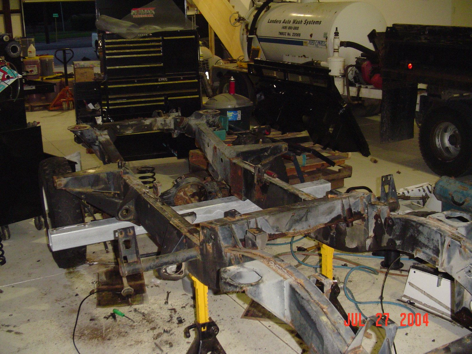

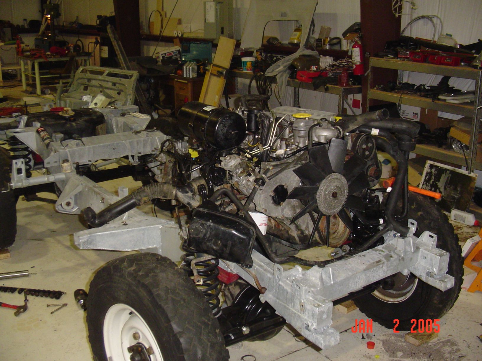

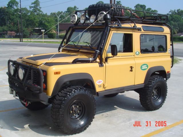

This will give you an idea of how far I am willing to go...........It's a terrible thing to be afflicted with. Several friends think I need an intervention.
I can supply you with a factory snorkel for a good price. While not an exact fit for the older 70 Series models, they are very close and don't require much work to fit up. LMK if you have any questions.

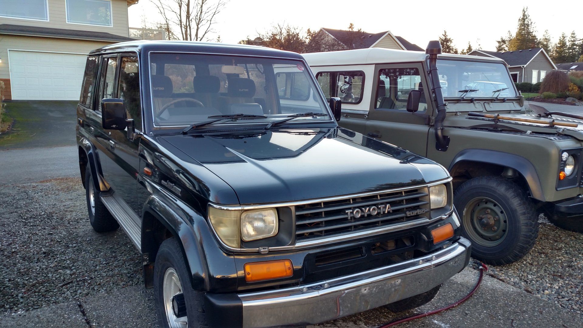

A before and after shot.

Thanks. And drives so much better. I can't wait to see how the new bushings and tie rods effect it. 2 of the old shocks were blown so bad that I collapsed them to get them out and when I picked them up to put them in the trash later they were still fully collapsed. Other 2 weren't much better.
