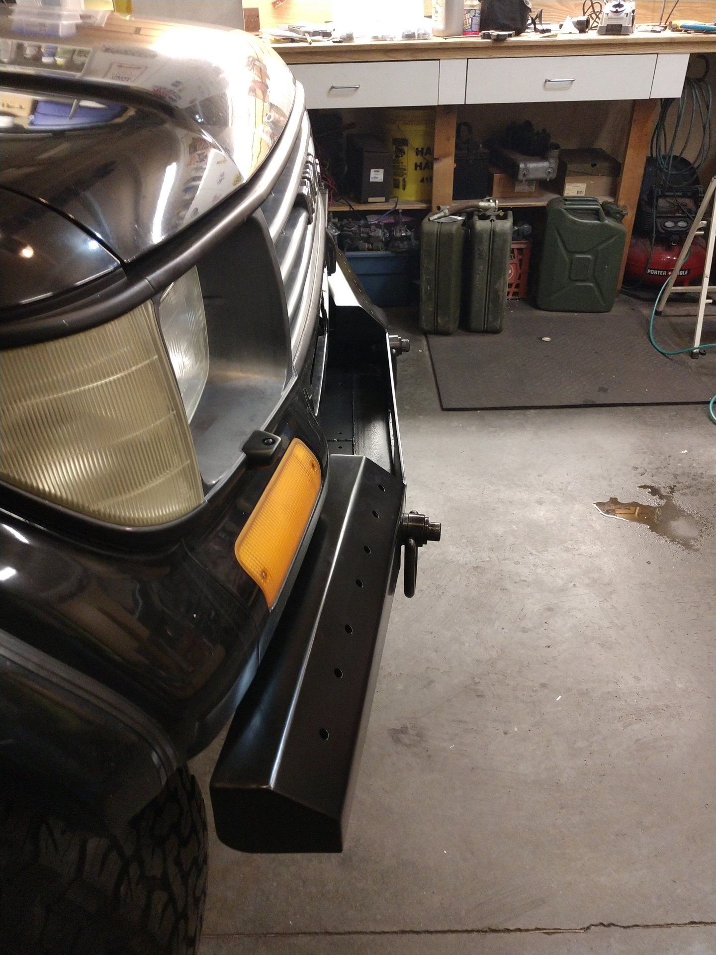

I have been tinkering around with a winch bumper for a few weeks now. I thought I would see if I could build one without buying any steel, just using what I had laying around.
May not be my final bumper and it has a couple of things I am not crazy about, but I built it with free steel. So, overall it will work until I decide to spend some money and build another.

Looks good to me! I like the compact size. Looking forward to seeing it with the winch.
Did your truck come with a factory bull bar? If so, any plans on mounting it to your custom bumper? I always meant to put mine back on, but have not got to it yet.
No, I never had the bar. It was on the bumper at some point. It discolored the chrome. But, by the time I got the truck it was gone.
I do have one from one of my Land Rovers. I actually dug it out and then decided against it.
