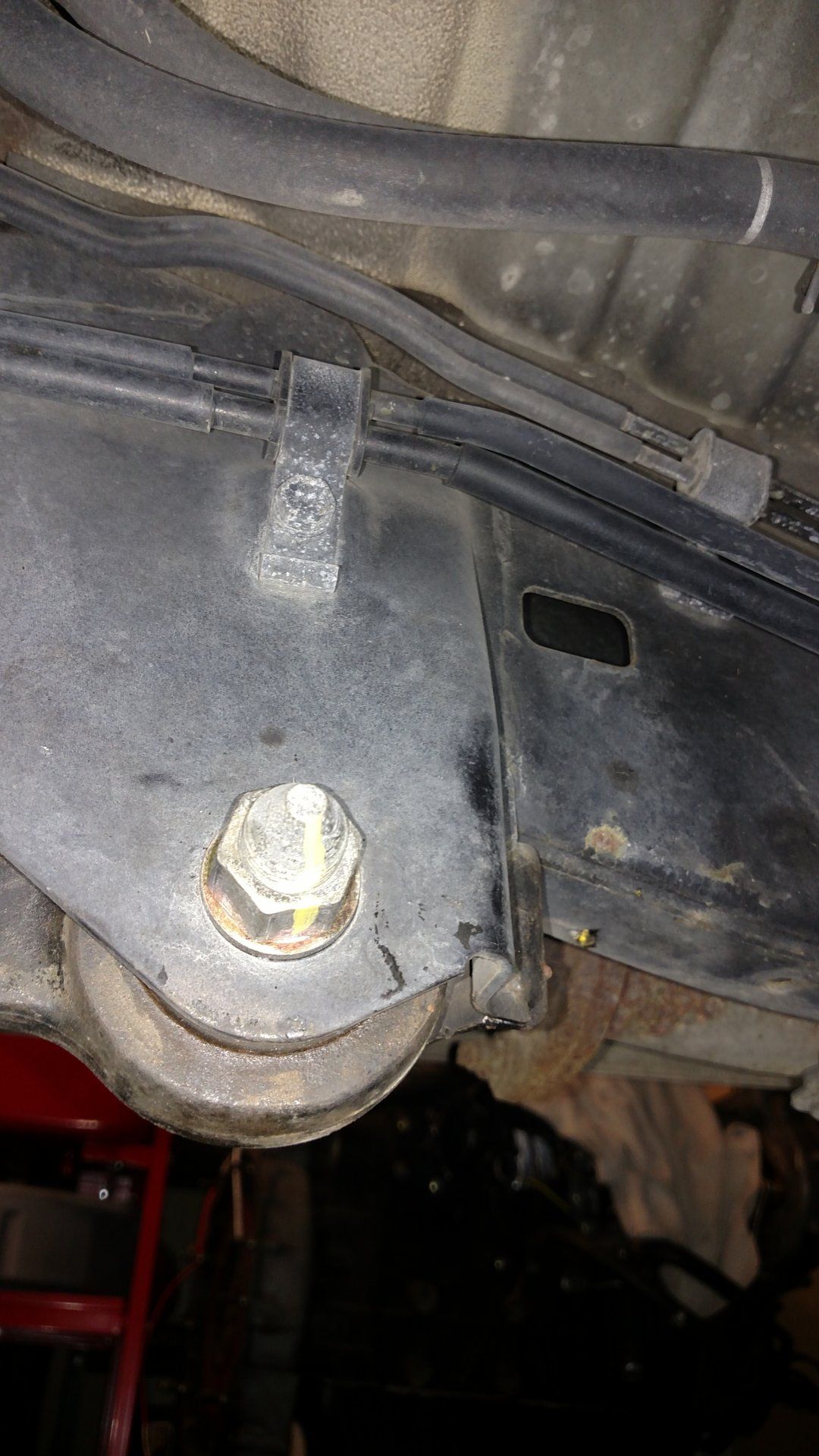

Decided to do the radius arm bushings this evening after work. Bushings are bushings, so that wasn't anything unexpected. However, the rear frame bushings I bought from Dobinsons were a full 3/8" longer that the stock ones, so didn't fit in the frame. I machined them down. Or more accurately took a PortaBand to them and then sanded them flat. Also, the template they provide is not accurate. Distance is 185MM between the bolts, which the template says, but it measures 175MM. Not a big issue because I was going to lay them out anyway. But, it could ruin someones day if they used it as is. The only other castor correcting bushing I have installed came from Slee. We used them on my nephews LX450 and his FJ80. I want to say their template was spot on.
I will align the front end tomorrow and see where I am. I still haven't gotten the new tie rods or the panhard bushings. But, I am betting it still drives a lot better.

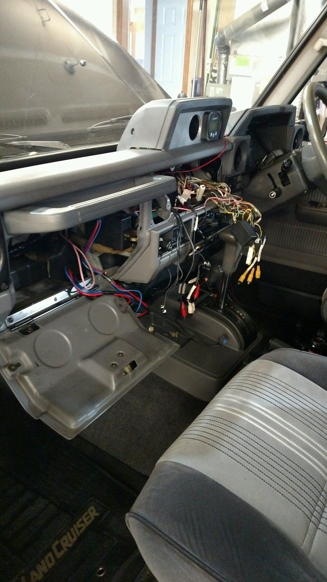

Gutted the ridiculous stereo out of the truck. The install was just spectacular. The sub amp had a 14 ga power wire ran back to the dash and was just looped and taped around a constant 12v wire. Pretty much the rest of the stereo was installed with the same level of skill. So, I just pulled the entire thing out and chucked it.

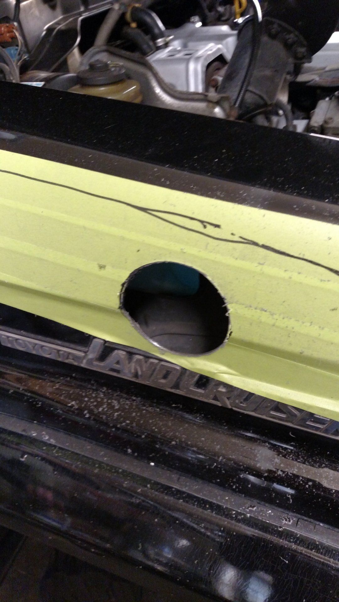

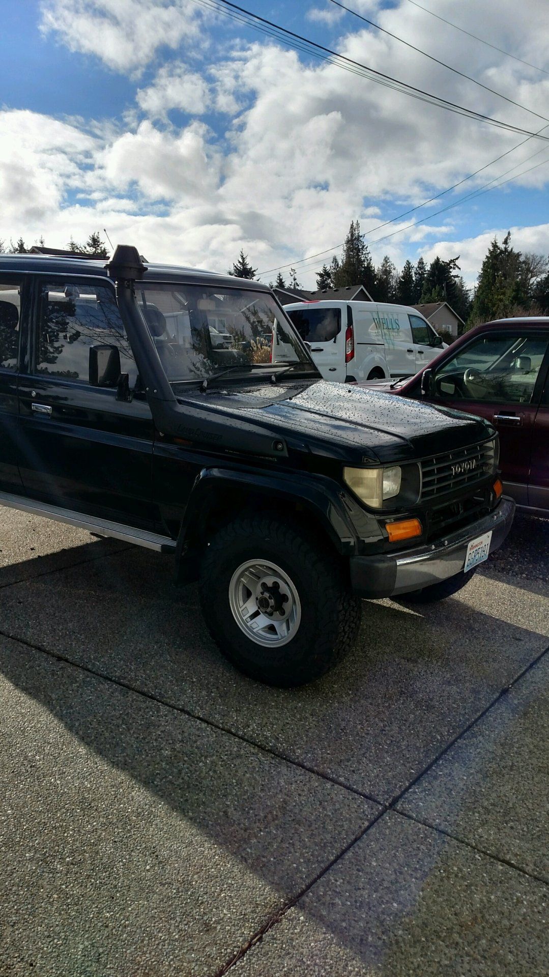

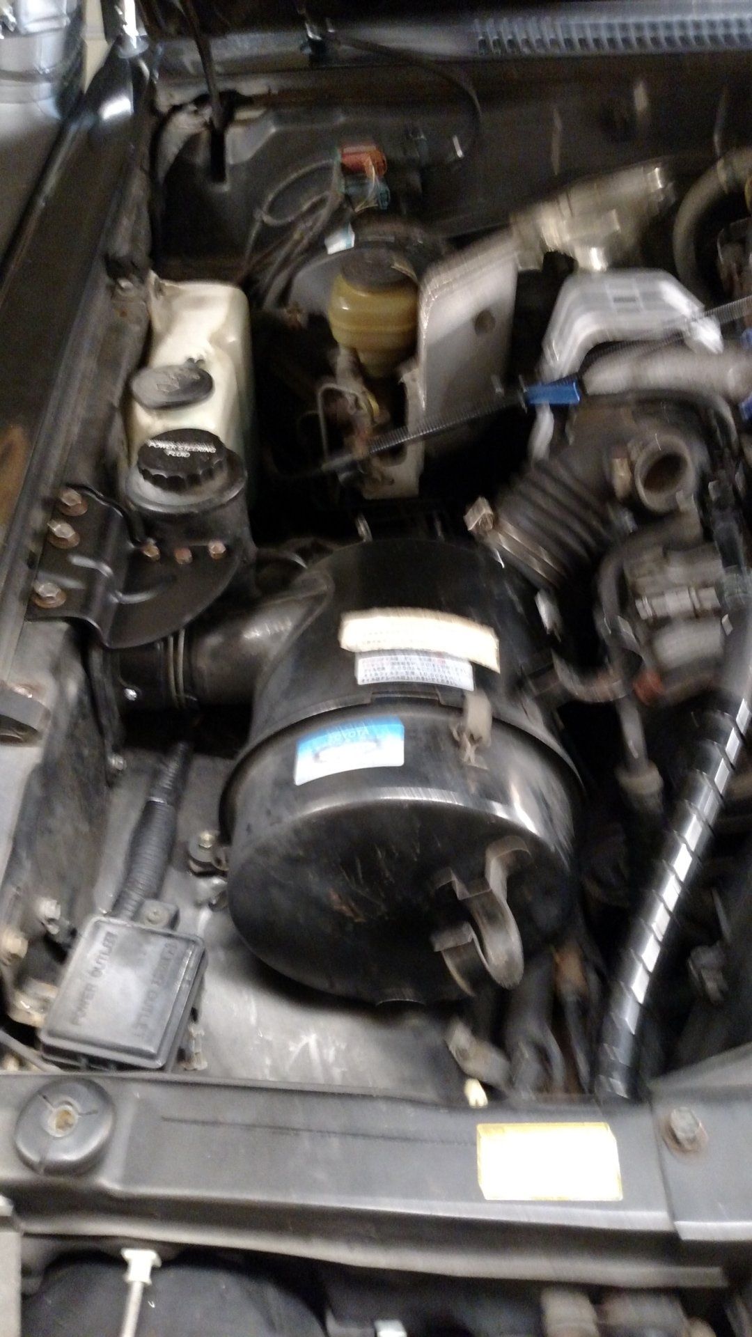

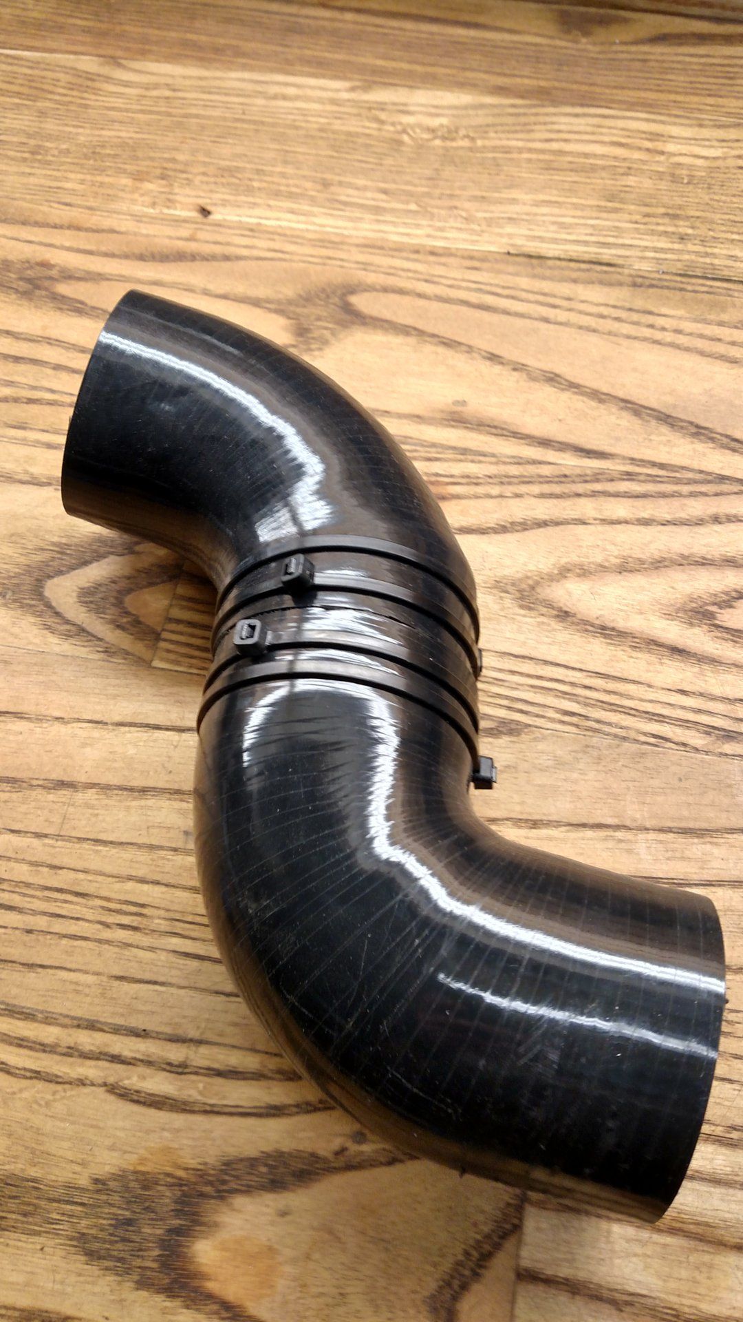

Parts for my snorkel project came in the mail today. So, spent a couple of hours getting that done. I bought one of the take off snorkels from bjowett.
Wasn't that bad mocking up the parts to make the later model snorkel fit. I used 2.5" exhaust pipe and welded it through a plate a fabbed up to take up the oblong hole for the later intake.
I wanted the under hood portion to remain factory so just cut the scoop from inside the fender off and ran into the remainder. So, filter canister remains in the factory configuration.
