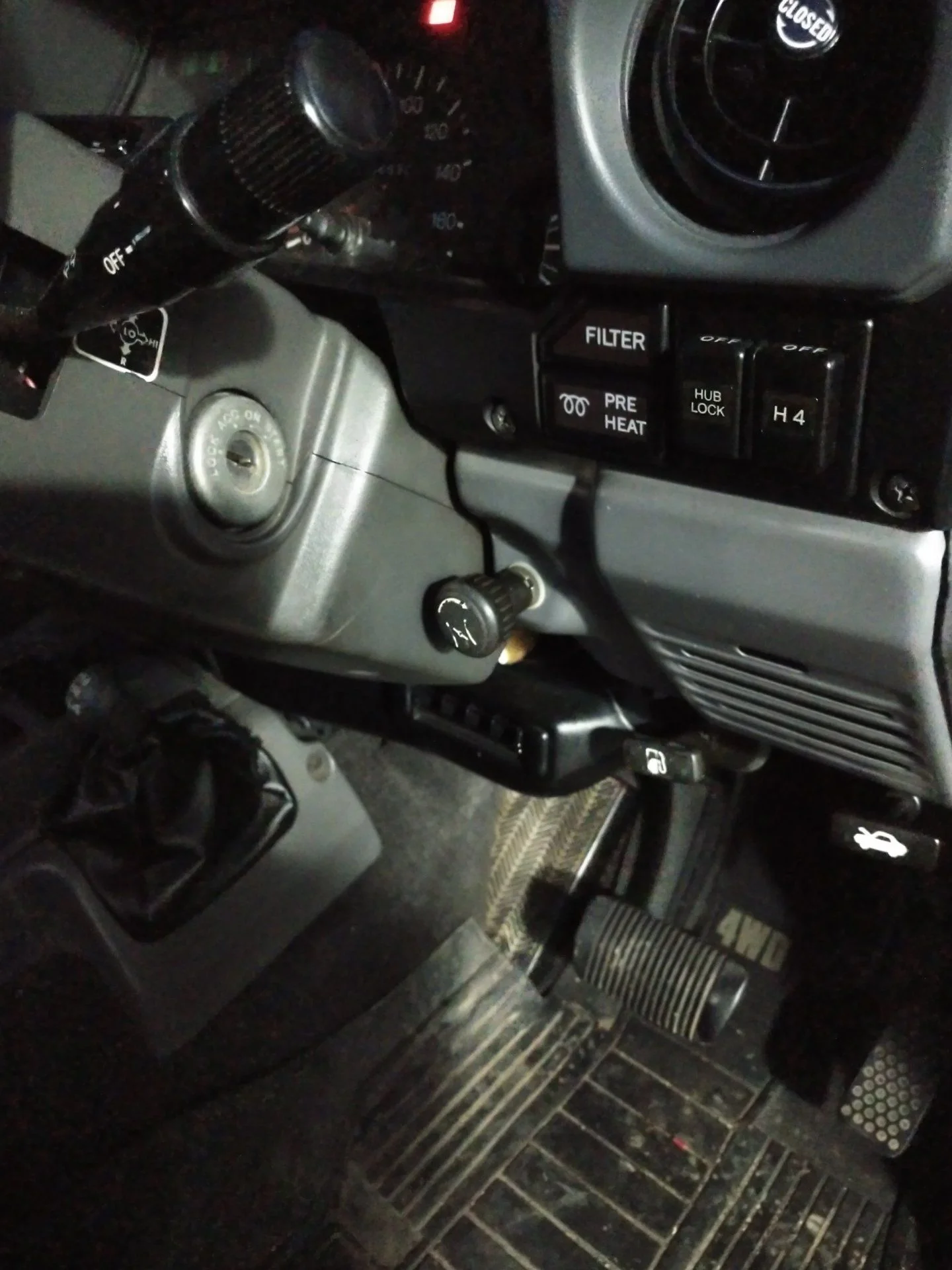

Best way to use the throttle knob is to depress the pedal until you are at the rpm you want then adjust clockwise until it meets resistance and holds rpms there. Then it's easy to dial it CCW to adjust rpms down.
Makes morning warm up easy. I don't even sit in the truck...I make sure it's in neutral, turn the key with my left hand and hold the accel pedal down with my right. Get rpms where you want, turn knob to hold it there, then go inside and make coffee. When the coffees done in a few minutes I come out and the truck is warm and the windshield is clear and I dial it down to a regular idle.
I should say my truck is RHD. Would be less convenient with LHD.
Where is the throttle knob? I have an LJ78 that I just bought. There is a knob missing right to the lower left of the pre heat light. is this it?
Yep, that’s the hole. I’d snap a photo of mine except I’ve removed it for the time being.
This is what you are looking for. Just goes down the the accelerator pedal with a cable.
