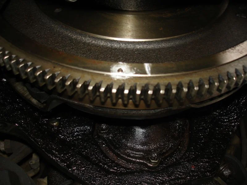

now to the timing. i planned on adjusting the valves today, but spent with the help of fellow mudders determining whether the timing marks i have properly indicate the TDC line and & 7deg. BTDC
it appears that the concensus favors what the pic shows and you can check the seperate thread for more opinions. https://forum.ih8mud.com/60-series-wagons/210721-where-find-timing-marks-2f-help.html
Big thanks to all who chimed in.

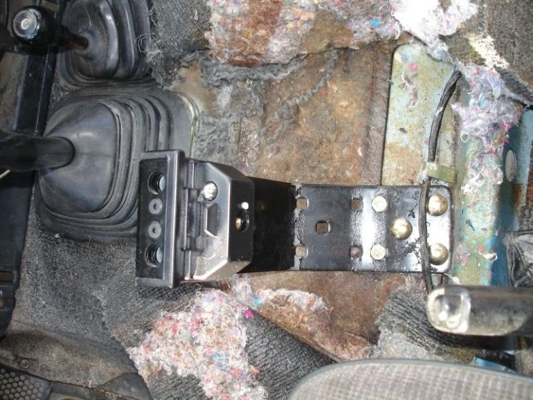

Also got my gear shift lock from jack at http://www.simjack.com/. inspired from the build https://forum.ih8mud.com/60-series-wagons/200578-rotw-kevinmrowland.html. any way took the straight bracket and bent a complex bend 30 deg. to mount to the trans hump a 60 deg bend to extend the bar leaving a 90 degree plumb section for the shift lock. put five bolts in the trans hump including the 2 security snap off nuts welded a 60 degree wedge to stabilize the upright and put a sixth bolt through the wedge. there is no flex at all. shift lock holds trans in reverse. not in the way of shifting or legs while driving. my answer to automotive theft.

Nice Lock! I will definitely have to follow suit some day! Keep it up.
thanks. i was impressed with its simplicity and from the tests that were done on the forks you cant cut it with a hack or recipricating saw. very hard metal!!!!!!!

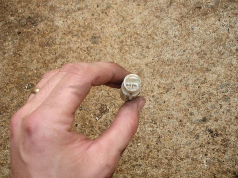

A big thanks to gsdog2 pegged it outright. the pins had been pushed back, dumb me did not look at it very well sunday. frustration can make you blind.
the kicker is the PO apparently had pulled the connector off before but re-installed it upside down so the prongs were entering the connector from the wrong end thus the connection never came close to happening :doh: :bang:
first pick of the connector backwards
second pic of the prongs in the connector backwards
third pics of proper end of the connector with the female reciever
