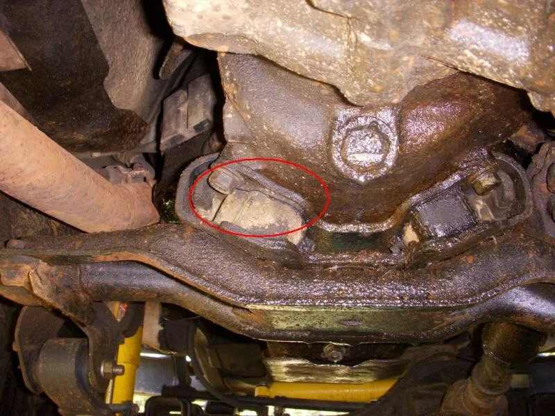

My manafre trans/trnsfer case hose kit came in to bandaid my seal issues between the two. the kit is complete ans easy to install. took less than 15 minutes. a little wd40 on the fittingd s and the hose makes quick work of mating the two. i wish all things were this simple to do. all you need is a 22mm wrench. i did find while i was down there a broken transmission mount....now in the pick i know there is oil everywhere i have seal leaks all over the place but i am not interested at this point in dismantling my drive line to fix them.

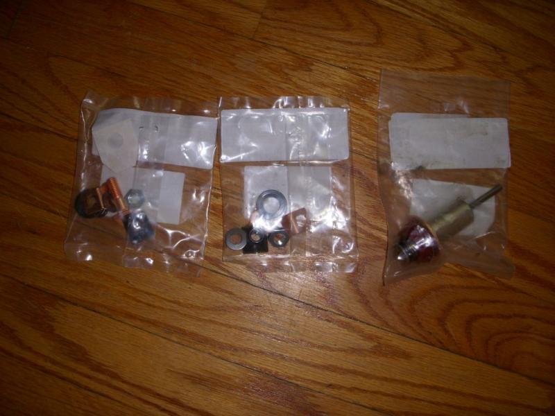

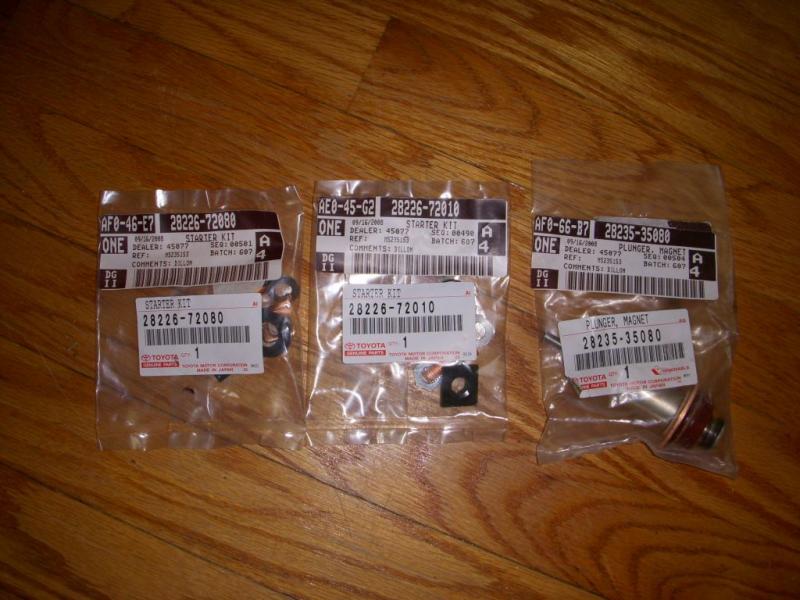

had a intermittant starter problem. so i took the starter apart and switched the contacts that got me through until the new contacts and plunger kit came in. the rebuild takes about 45 minutes. you need a 17mm wrench for the starter mounting bolts one on top and one on the bottom, a phillips head screw driver, a 13mm wrench for the nut that holds on the battery cable, and a 14 mm wrench to loosen the nuts that hold the contact nuts down....order toyota parts from the dealer cost about $60.00 for the contacts each side is different and casts about 16.00 and the plunger is like 25.00.
here are the parts

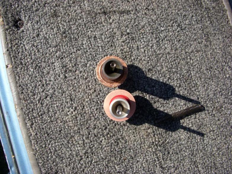

starter rebuild
bad contacts, bad plunger....pluger new vrs old....
