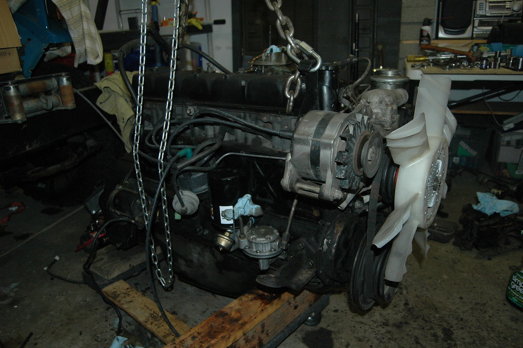

1978 FJ40 2F Engine swap
Pull the engine trans/case out as a unit. then you will see your FJ60 bell housing won't work.. it has no place for the mounts on the sides.......since you have to swap these, install a new rear main seal while there.....your 60 will have a huge motor mount on the passenger side front that also holds the AC compressor, this will hit the battery box, so use the 78, I prefer to use all externals off the year of the truck......one thing I would keep is the oil cooler which your 78 don't have.
Engine and trans are impossible to install unless you do them as a unit. I take the bell housing mounts off, as they always seem to hit on the way out and in....another trick is to roll the truck instead of trying to roll the engine hoist, much easier, a ratchet strap from the post on the hoist to the engine helps keep it from twisting....IF you got the distributor coil and ignitor, this is a better ignition system than your 78...
The bell housing will work. An adapter is available that mounts to either side of the frame rails and bolts to the transfer case replacing the rear cover. Many 40 owners use them. The adapter is quite stout. I have an 86/87 2F out of a FJ60 and it has the bell housing you got. I would suggest you use it and buy the MAF kit. If you ever think you are going to put a 5 speed in you will avoid a lot of modification to the older bell housing. They say you should weld the mounts to the frame, however, I know a number of installation utilizing grade 8 bolts that do not show any signs of frame cracking. The isolators on each side are substantial.

I would continue to use the original FJ40 bellhousing and save the FJ60 housing for another day or another project. If you install a 5 speed, the bellhousing will be a small issue at that time.
Nice 40, really sharp color. I'm with the others on pulling the engine/tranny/t-case and reassembling on the ground, but if the plan is to get the engine in and bolted up - and then slide the transmission in - yeah, not that big a deal. If you're trying to leave the transmission suspended between the frame rails and stab it in while the engine is still half hanging from the engine hoist, I want to see that on a You Tube video.
Concur with keeping the 2F bellhousing - never been a big fan of the AA rear t-case cross member. If you do go that route be sure to get the newer version with the integrated input shaft cover - less leaks to deal with.

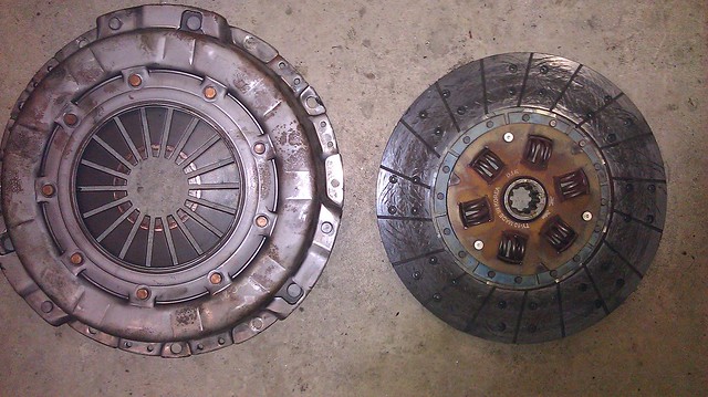

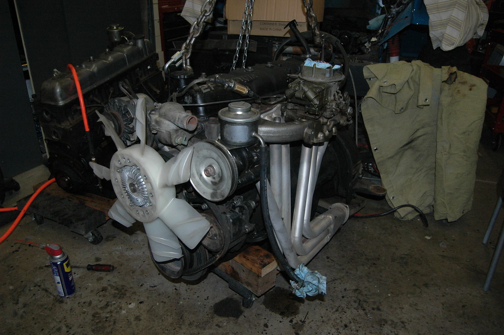

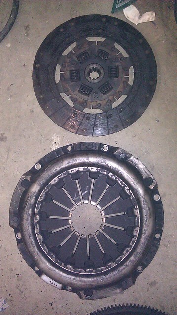

We've spent a couple days since the last post working on the 40. We stripped the new engine and transfered over the old accessories over to it. We've removed the Bellhousings, and before we attach the 2F housing to the new engine, I had a clutch question...
Will the clutch pressure plate and disc from the 60 work with the bellhousing and 4 speed in the 40? They are different, but I suspect they'd work.
This is the old one from the 40:
This is the new one from the 60:
Thanks for the help!
I'm going to grab a new throwout bearing from NAPA. I read that I should grease it- what type of grease, and how much should I use? I have some trailer bearing grease that's blueish green. :D
Will be pre packed, no way to get grease in there anyway.......you will have to press the old brg off and the new one on....
