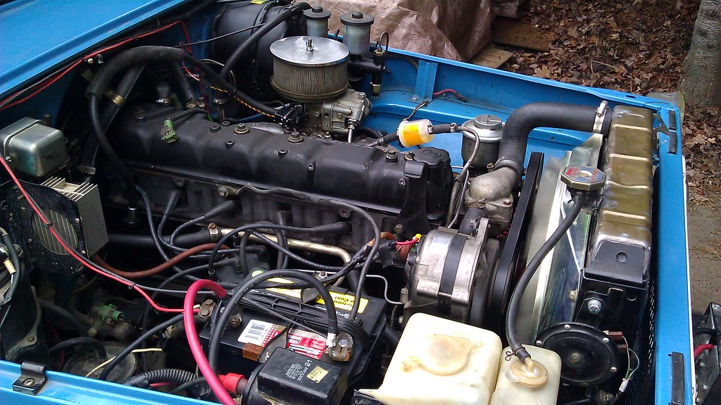

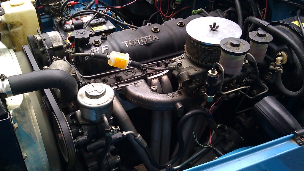

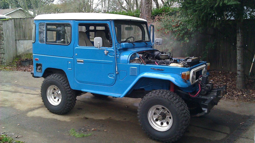

I'll post some pics later, but we've almost got it!

We're very excited that it runs, and sounds GREAT! I'll try to post some video and pics. Thanks to everyone that has helped, this forum is great.
