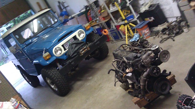

The truck in question:

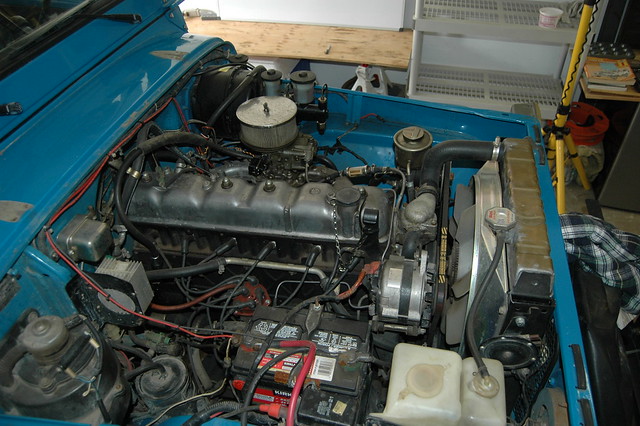

The old engine:

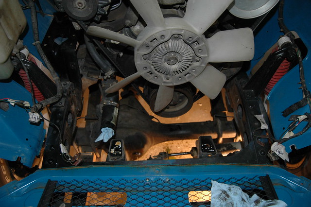

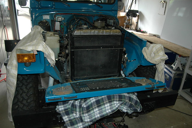

Radiator out:

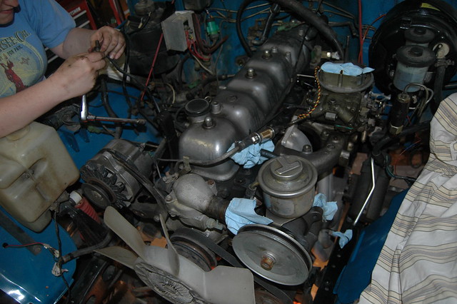

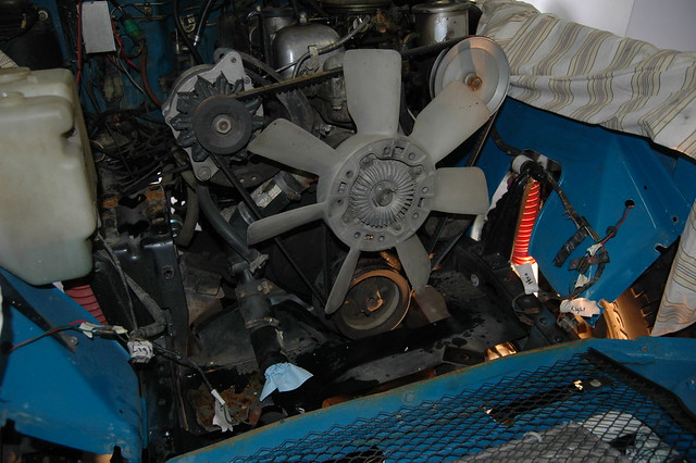

Disconnecting all the bit- labeling and taking lot of picture!

If you have not done it yet, remove the bib and the front bumper, by the time ya get all that weight on the hoist, you want the arm in all the way, not extended, so it won't tip toward the truck, an you will need that room up there.......I've done too many of these to count, so if ya need anything PM me.....
The sheets these folks use to protect their fenders are nicer than the ones on my bed! And, that's a perfectly good flannel shirt protecting the front bib.

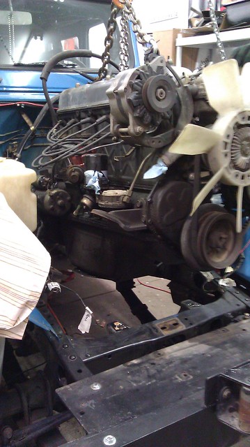

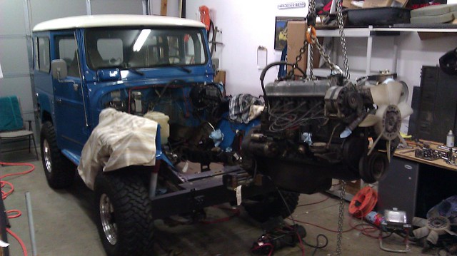

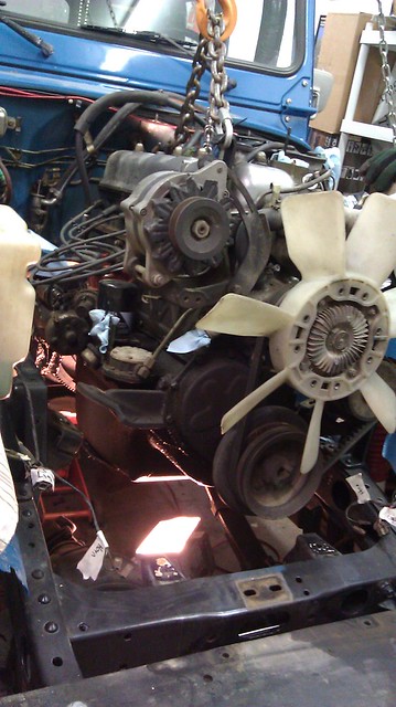

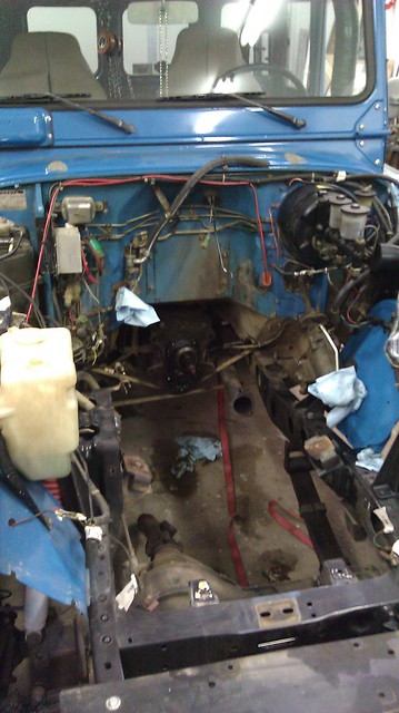

Day 2 was good! We unbolted the bellhousing from the tranny, and engine from the mounts, and supported the tranny with straps and a floor jack. Lifted the engine a bit, wiggled it, and eventually got it out. Had to take off the header. Fun stuff!
