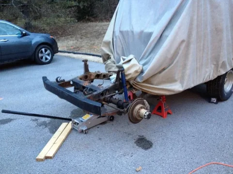

Kurt, no still in complete teardown status. It'll be .... forever.
That looks about right for a booster replacement. :sigh:
