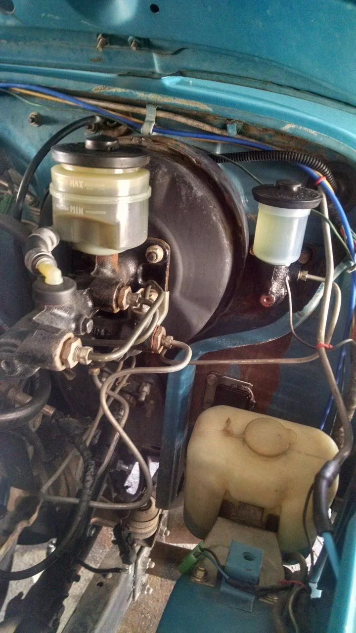

I just got it off of a wrecked 60. You have to mount it upside down for the holes the line up. When you mount it upside down the little drain slot where the master bolts is now pointing up. So you have to take a cutting wheel and make a slot on the side now pointing down for fluid to leak down so it doesn't get into the booster if your master ever develops a rear seal leak.
