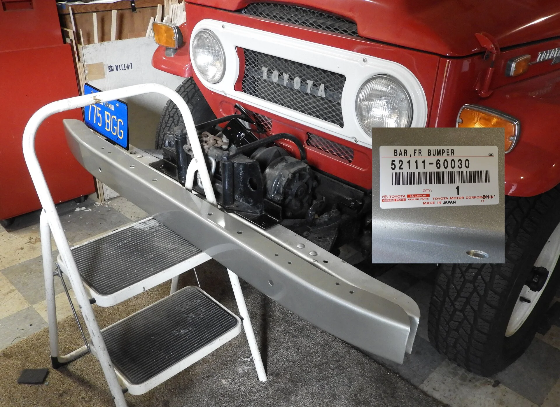

My original bumper has the license plate mounted on the passenger side. See my avatar.
I just got a NOS bumper. The license plate bracket holes on the drivers' side. I looked up internet images and they show the license plate on the passenger side when present.
Toyota 52111-60030
Was I sold a right hand drive bumper?
Please do not suggest drilling holes in a brand NOS painted bumper. My original bumper did not have extra holes on the driver's side. I want it to look as originally made.
Thanks,
Scot

New bumper have multiple holes not used during most the time the FJ40 was imported to the US. The original location was for the licence plate was in the middle. When a factory PTO winch was installed moved to the holes on the right side. Then in the mid 1970 a special license plate bracket that bolted to the bottom of the bumper was offered for when the factory PTO winch and factory fog lights were install. Never seen that bracket in person.
Here you go. See attached.
Isn't this clear coat paint? The back side has places with incomplete color but is still super glossy. Auto manufactures did not start using clear coat until the 1980s. Wouldn't that mean this this is not a NOS real Toyota part?.

There were six holes between the frame rail. Two for the licence plate bracket. Two for the guide bracket when starting the engine by hand. Last two for the front front of thee PTO winch. There are two matching holes on either side of the frame for fog lights. Two holes out side the frame on the right side as a secondary location of the licence plate bracket when the PTO winch is installed.
Was it sold to you as NOS? I ask because this bumper is still available from Toyota. Chances are they have tweaked the ancillary holes once or twice since your 40 was new.
OK, I figured something out. I had it upside down. The top bolts have a square carriage bolt hole. It is worse than I thought. I have even more spurious holes. This is an apparent universal bumper with hole for every model year change and option. Swiss cheese. Definitely not as advertised by the vendor or as used on a 1970.

The original bumper is compromised. Both ends have been folded in at various times. It has been repaired a couple of times. IT is actually in sad shape. I do not have the equipment necessary to make it straight. Even if I did it is weak due to damage.
It was sold as an "OEM FRONT BUMPER 1958-1984 FJ40/FJ45/47/BJ/HJ -Silver painted finish" The picture showed a bumper that looks like the original that is on my truck.
Then you're probably down to welding up those holes and repainting. Not sure what would happen if you ordered another bumper from your local dealer or another reputable Toyota parts supplier. Guessing it will be the same but not positive.
PartSouq has 9 available and the photo shows no additional holes but the license plate holes are on the driver's side. No guarantee that the photo is accurate but I have found them very responsive in the past. They might be able to send you photos of one before you purchase.
The photo from PartSouq shows the bumper upside down. That is what mine looks like too, from underneath. That was my initial confusion. Notice that the holes for the frame bolts are round? The square holes go on top.
