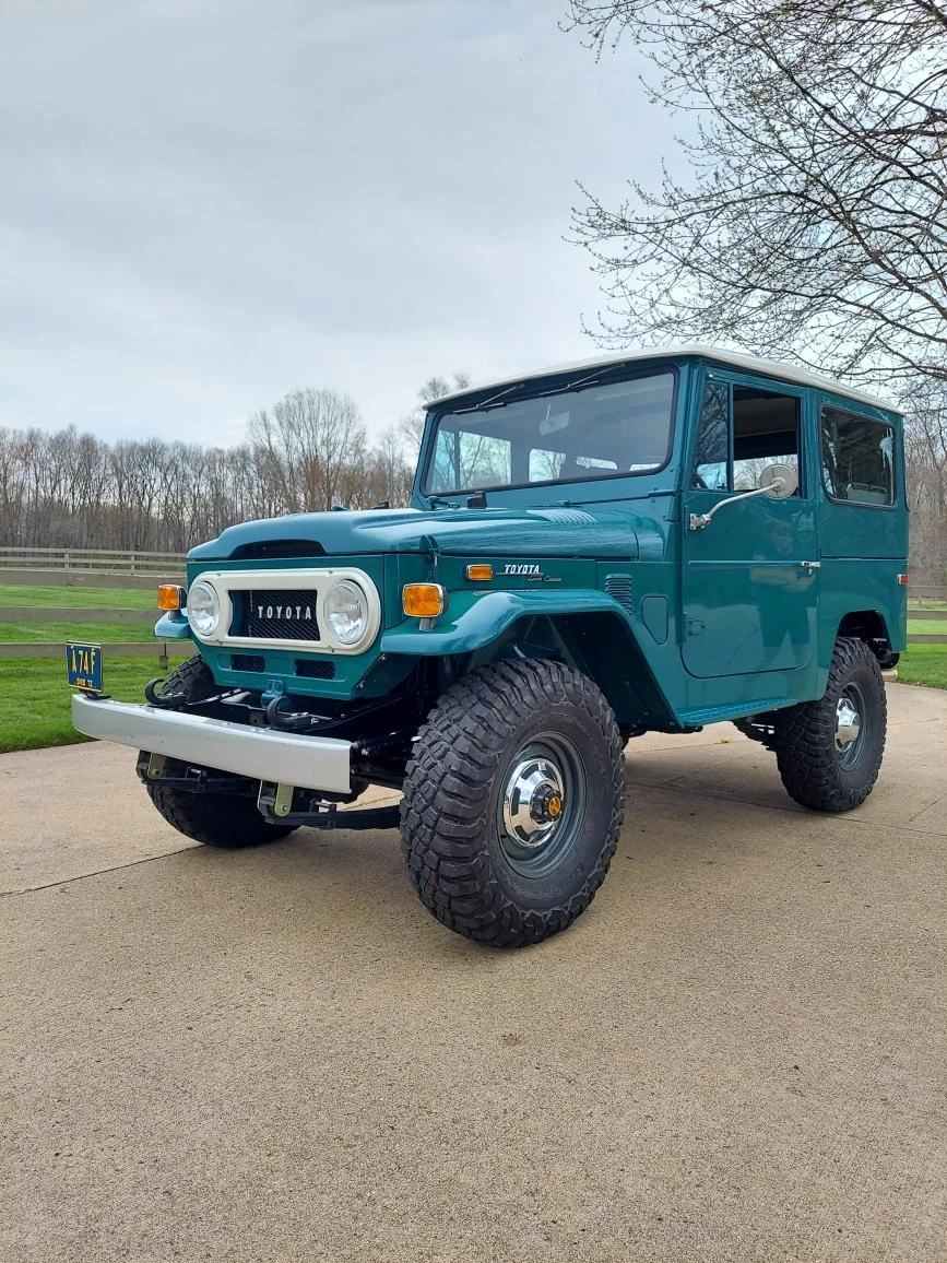

1970 Front License plate position??? (Generic bumper actually)
My original bumper has the license plate mounted on the passenger side. See my avatar.

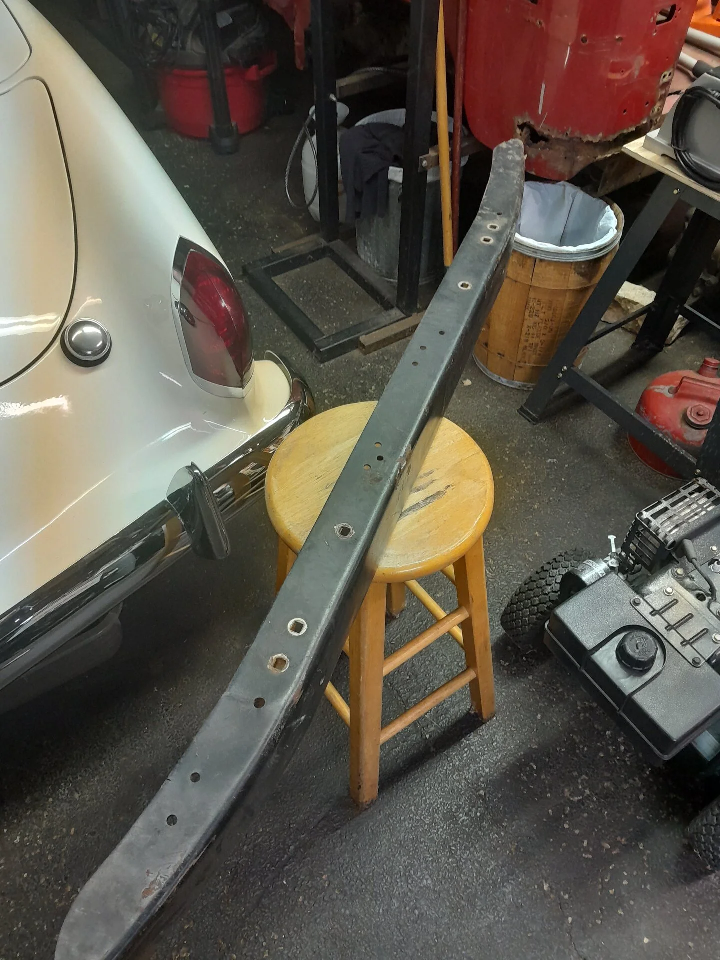

I just got a NOS bumper. The license plate bracket holes on the drivers' side. I looked up internet images and they show the license plate on the passenger side when present.
Toyota 52111-60030
Was I sold a right hand drive bumper?
Please do not suggest drilling holes in a brand NOS painted bumper. My original bumper did not have extra holes on the driver's side. I want it to look as originally made.
Thanks,
Scot
I purchased a new, OEM bumper from Toyota last year. Shipped to a local dealer. License plate bracket holes on the Passenger Side. Some extra holes but not nearly as many as what you have.
You linked a bumper that spanned ‘58-‘84 IIRC, that’s your answer. It’s covering all the bases.
I paid about $200 for my bumper.
Edit: I guess it did have that many holes.
Never noticed, never cared 🤷🏽
I’ve noticed that since these trucks are 50 years old it is sometimes necessary to buy things that may be slightly different from new. Or buying things more than once to satisfy a desire for just right. In either case I hope you find a satisfactory bumper. That bumper with extra holes in it won’t affect the value of your 40 one bit.
My decision is to keep it. I will turn plugs on the lathe. The plugs will be silver brazed into the holes. I find that going that route is much cleaner then welding. The paint will be re done with the correct type and color.

I count sixteen holes in the bumper of my Jan 1972, second owner, truck I bought in Oct 1978. I didn't put any of them there and hadn't given them any thought until this thread.
Those are all stock. Six square holes are obviously to mount the bumper. Holes just out the square holes on each side are for fog lights. The outer two on the right side is secondary for the licence plate bracket. In the center the two holes closest to the front are for the PTO winch. The back two on the right side are for the licence plate bracket. Left two are for the guide when hand starting the engine.
