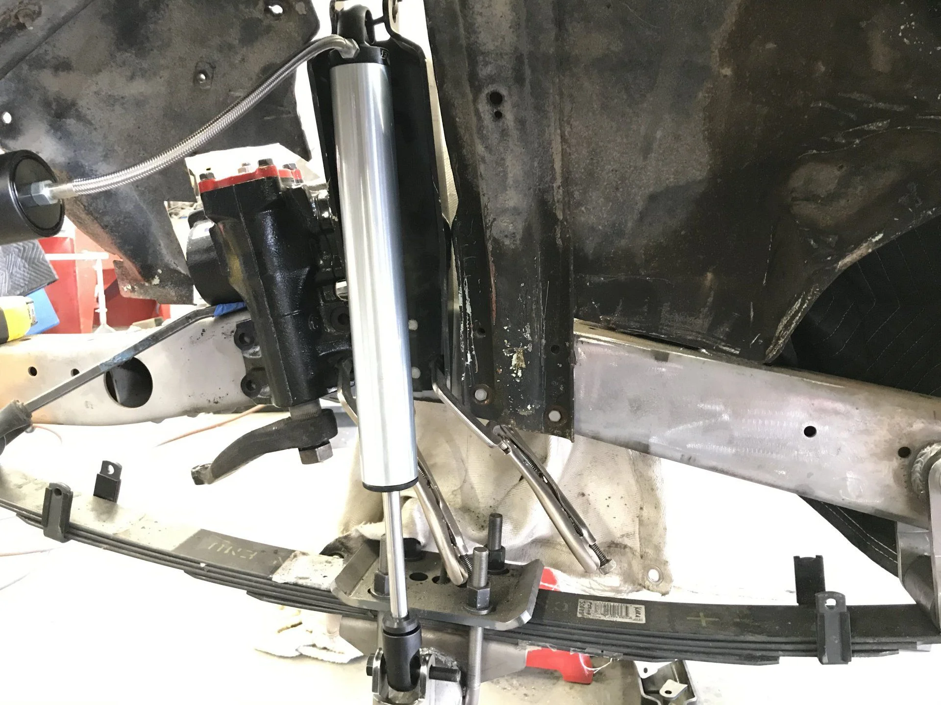

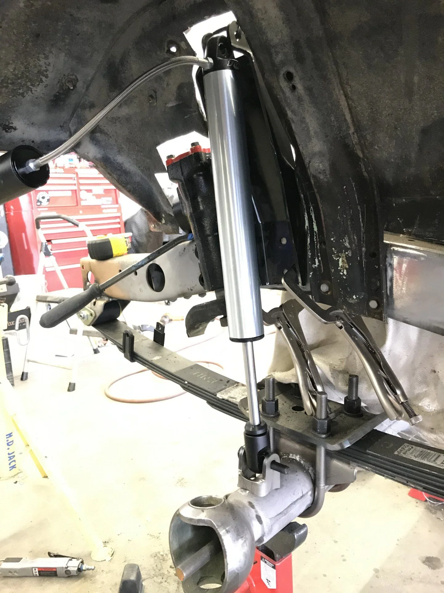

Getting into the front shock and steering layout.
Cheers
By the way,, these are just Fox 2.0 in 11”. They are 28” extended which is what I needed.
We went back to a King 2.5 with adjusters. Fox was also 8 weeks out so we just went Kings.
Cheers

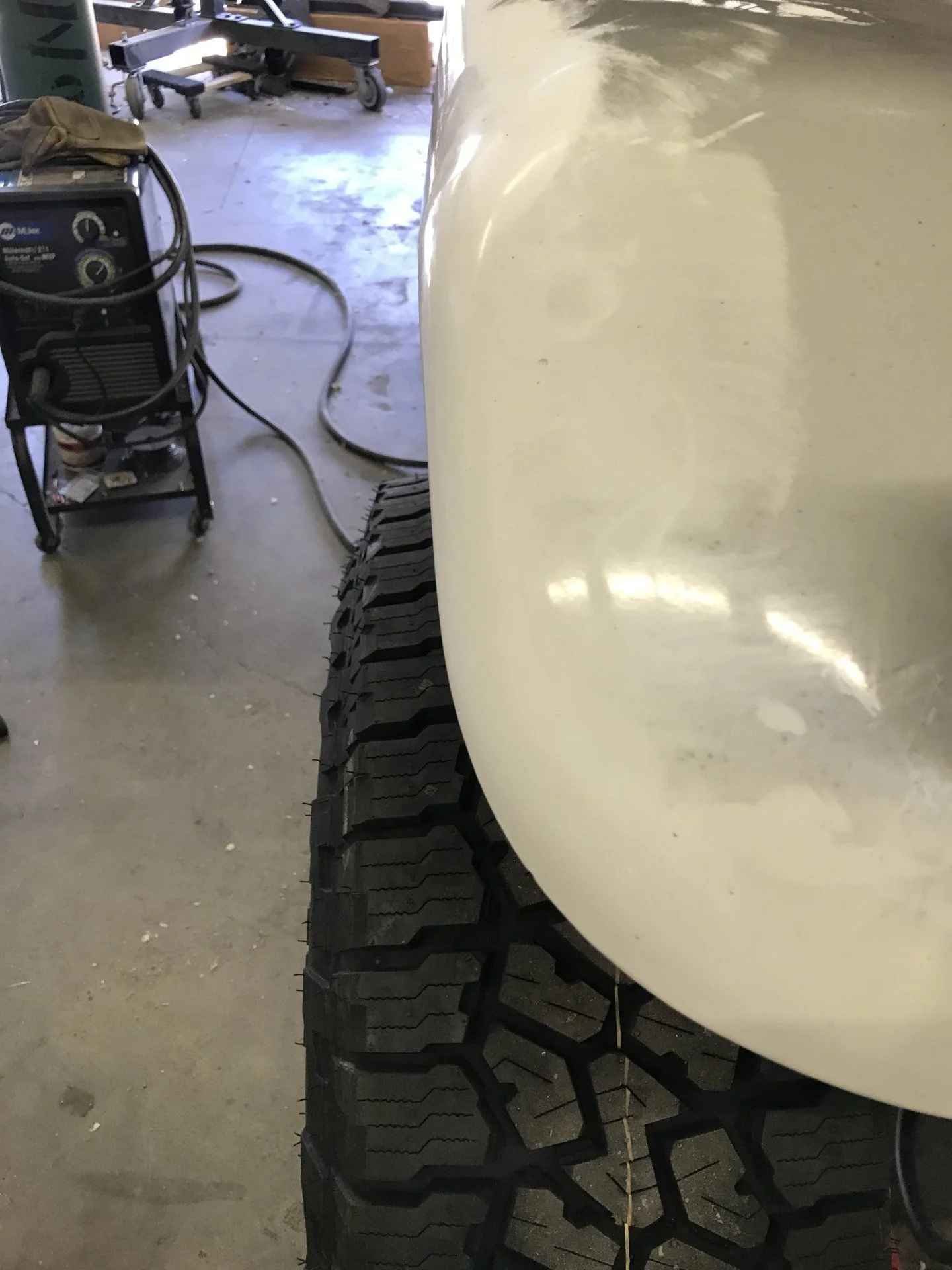

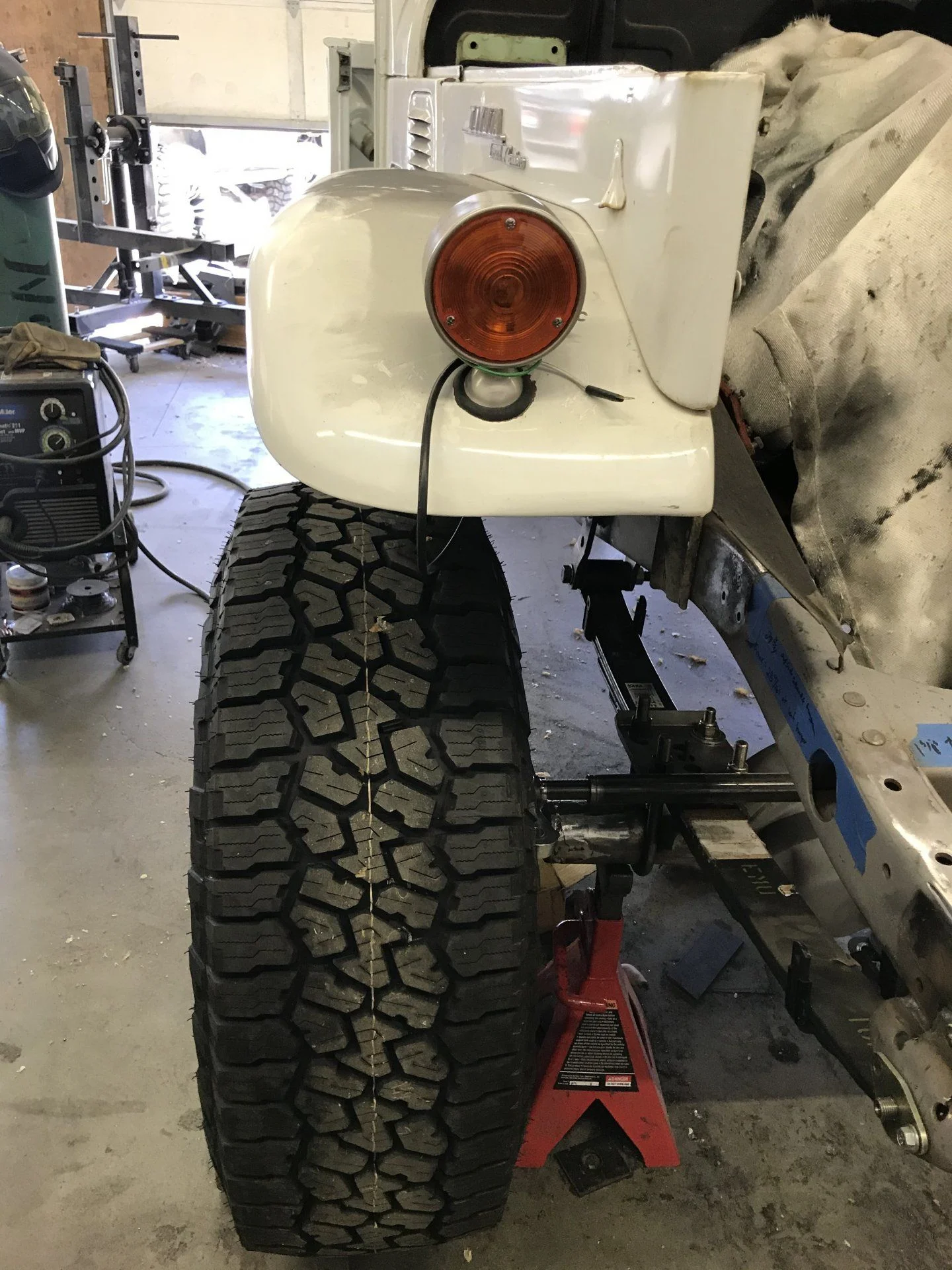

is that a 40 or a 60 axle? The tires are very likely going to rub the shocks when one side is under bump. It's a minor amount but I have that issue on my Fj62 with those shock towers. Can you cut them down or angle them more vertically? That would fix their inversion as well.
40 with 60 outers.
They are pretty vertical, nothing burned on yet. I am sure you know, this is still “layout”. Once I am happy with that, knuckles, Marlin arms, Marlink, hubs and tires go on to cycle the suspension before burn on. It’s a process. 😉
Cheers

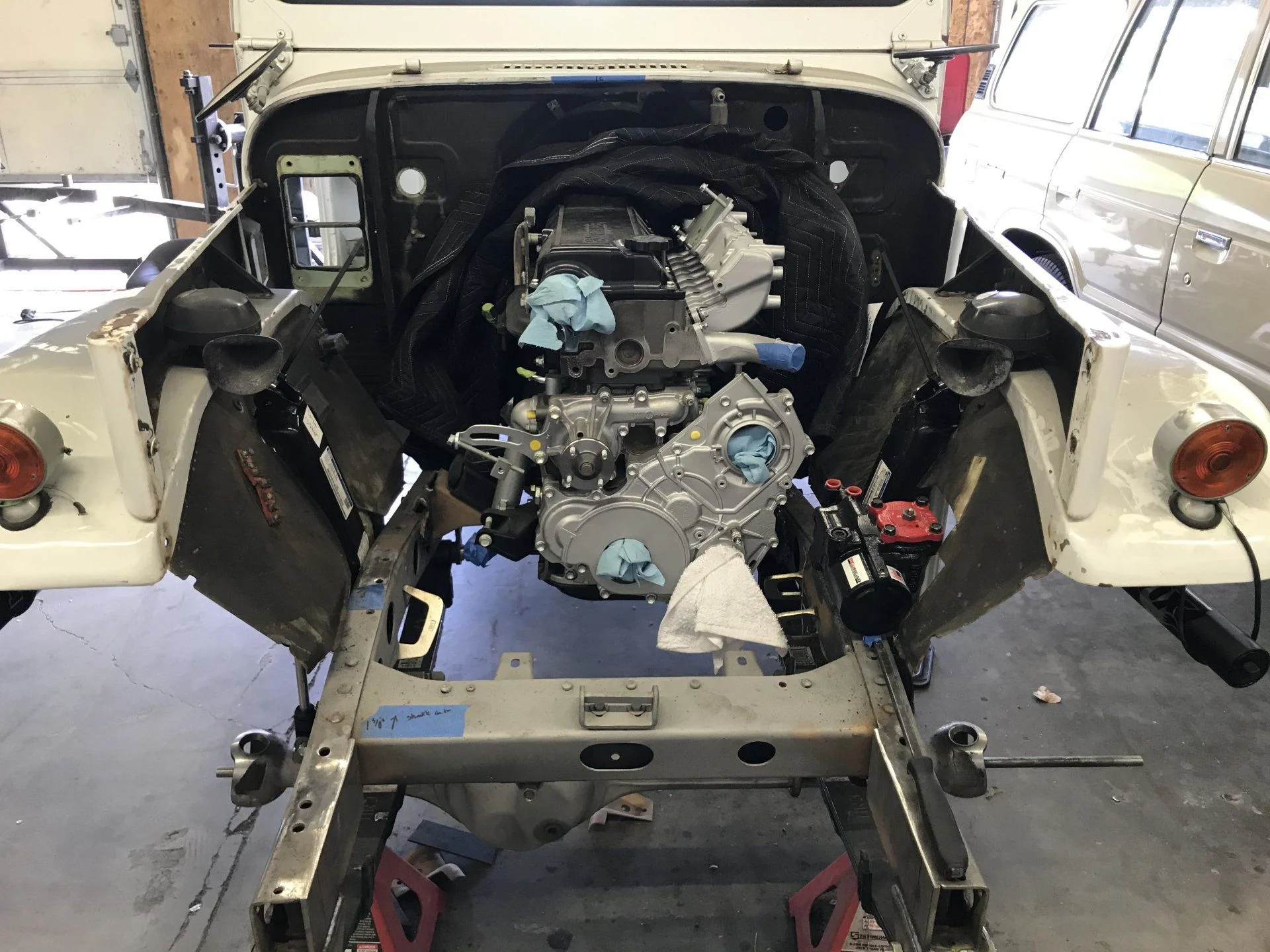

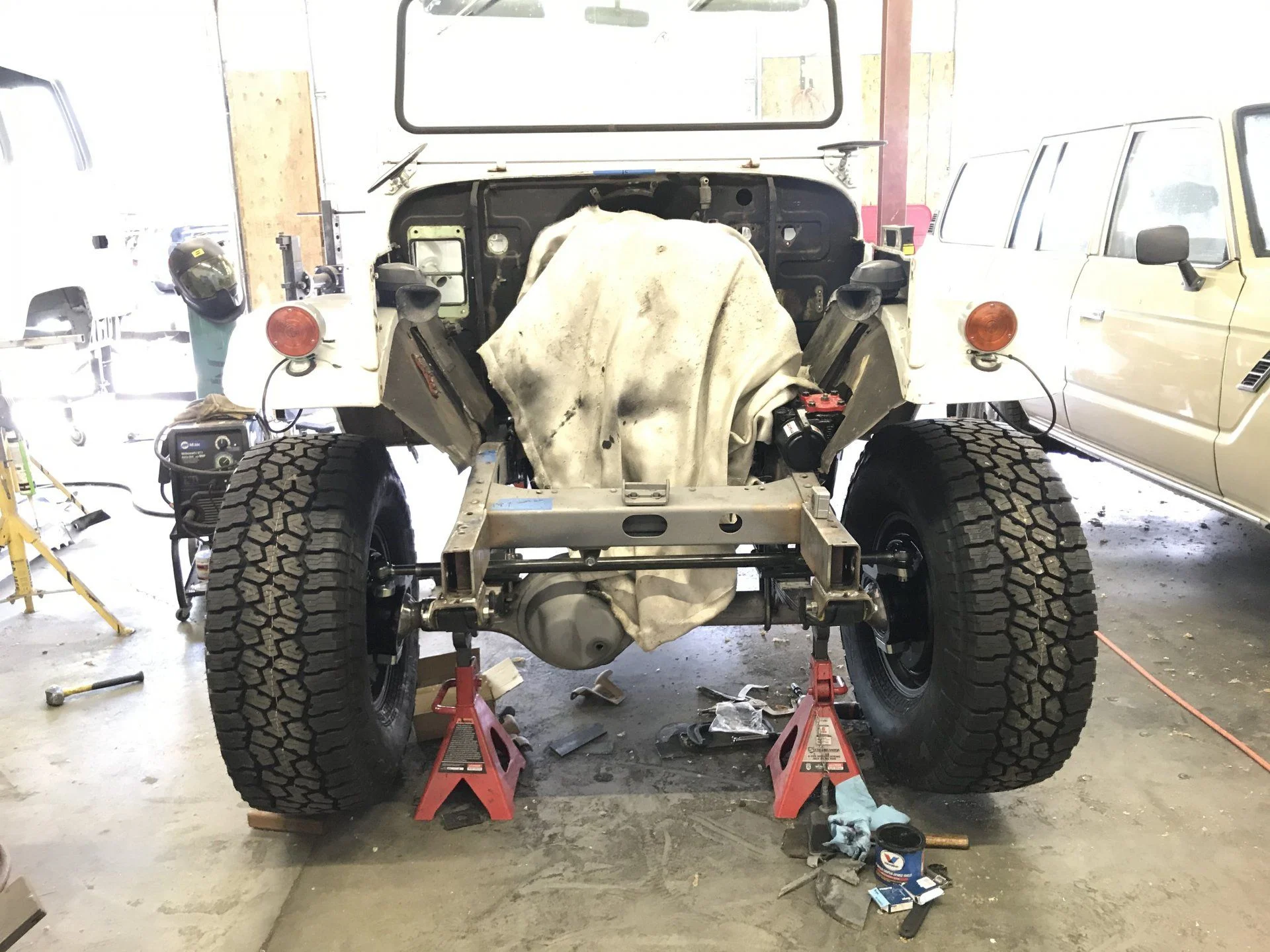

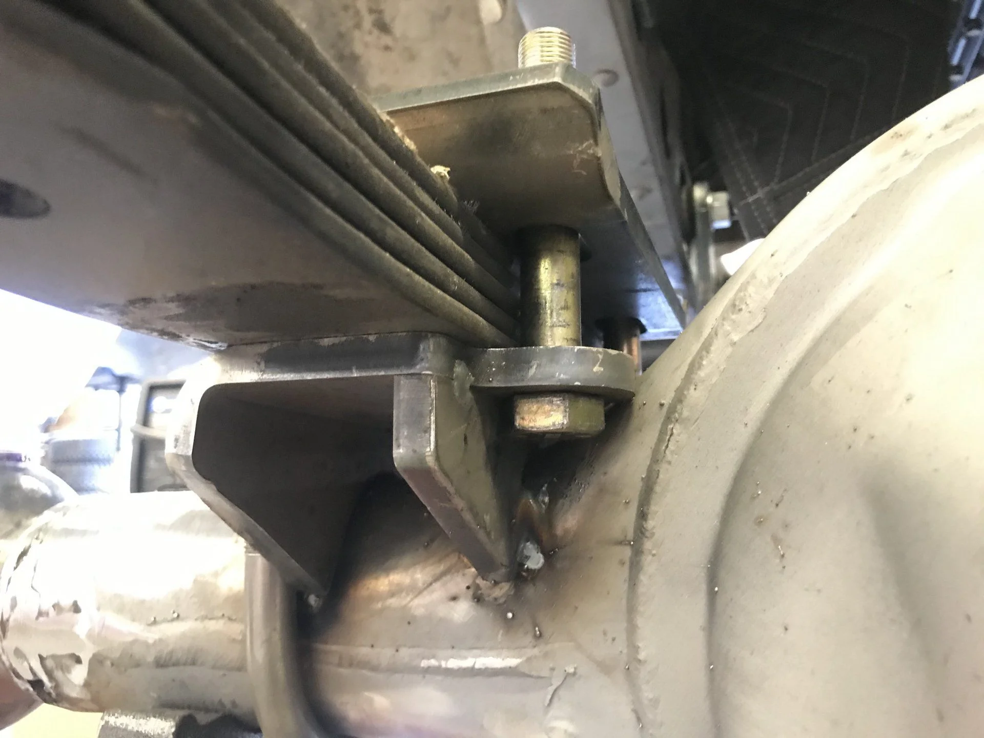

The spring and shackle setup looks perfect.
You have a ton of room in the engine bay with the inline motor to bring the upper shock mounts closer together. It’ll drive better that way too
When I used those shock mounts on my 40 I had to straighten them up to keep the 37x12.5 tires from rubbing.
Both sides getting turned more than 12*.

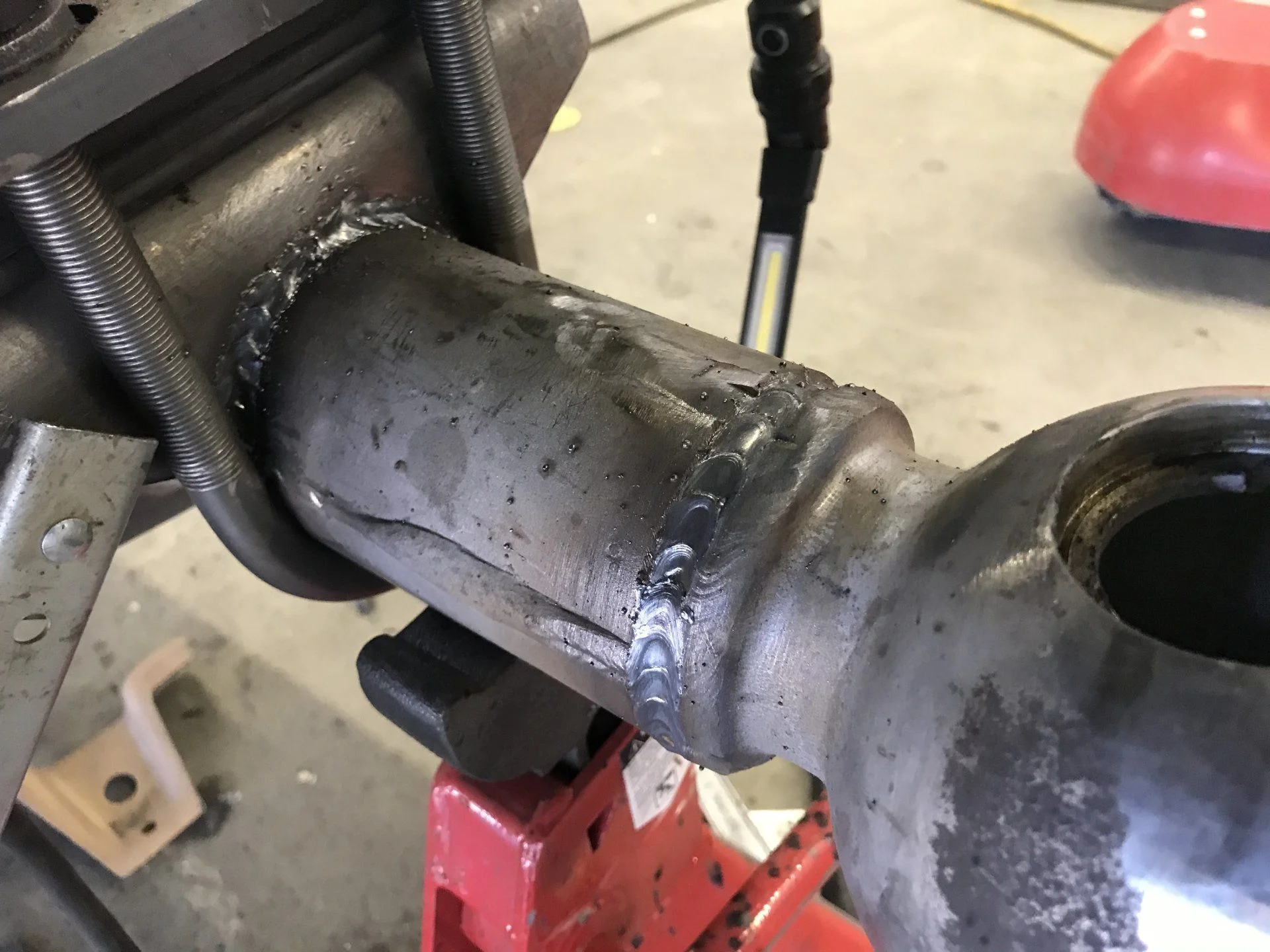

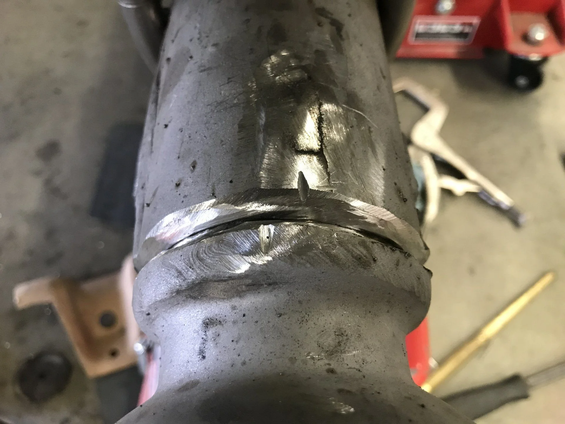

Probably give this a quick grind and make one more pass on it to fill the fuller.

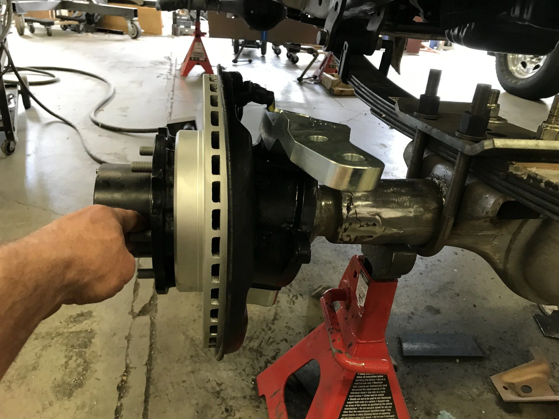

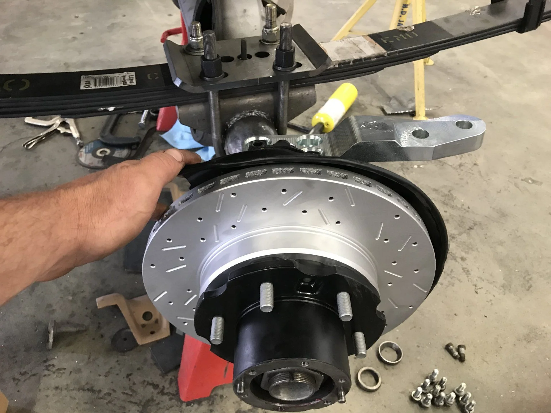

With the C&T done I am bolting up knuckles and hubs so I can fit wheels/tires, configure steering, shocks, bump stops and so forth.

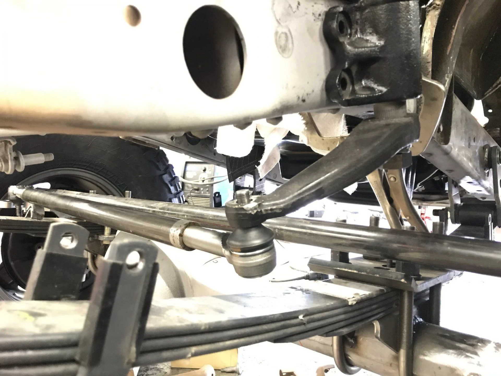

No worries on tie rod to frame under compression.
I am feeling the stock 80-series pitman arm is to much drop, even without check under compression. I can adjust the box up and less angle a bit but not a lot. So I ordered up a flatter pitman arm this afternoon. The Marlink is also to short on the rods, it’s a kit I have had sitting around for a few years. So I need to order up some new rods the right length but the drag link is super flat, just how we like it.
Cheers
where did you order a flat pitman arm? Sky's?
