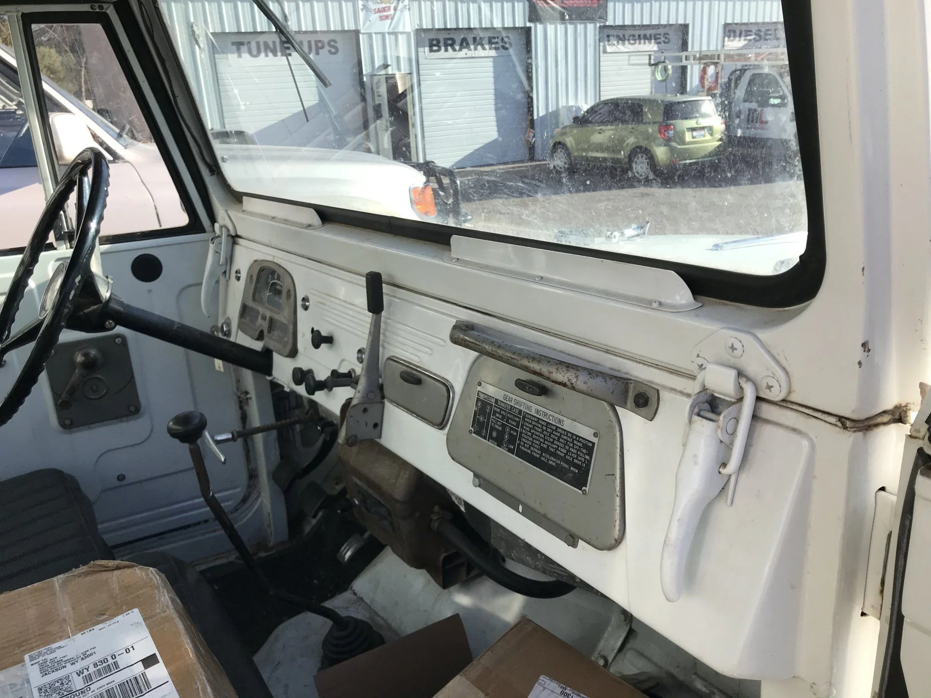

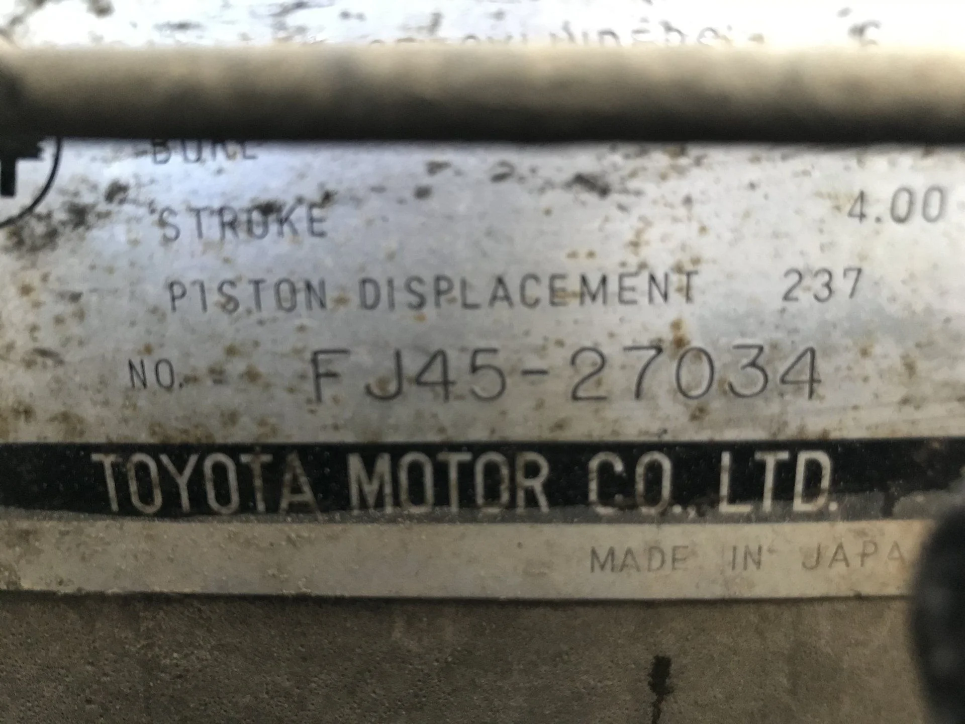

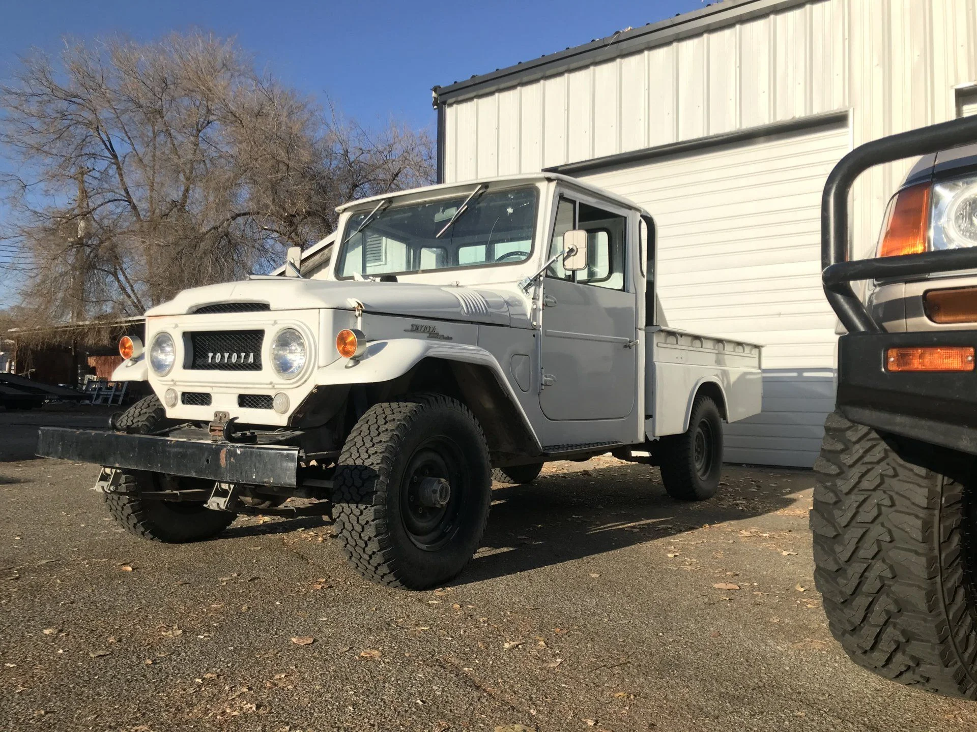

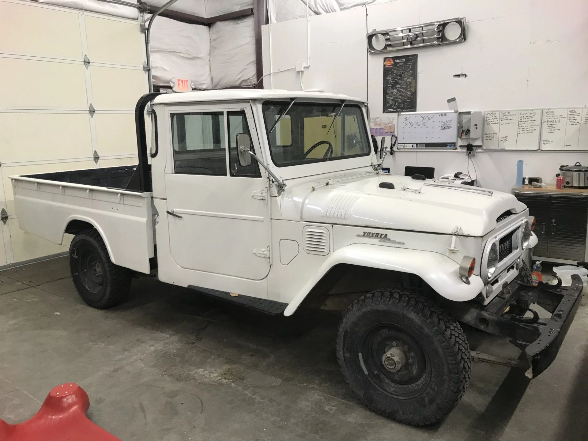

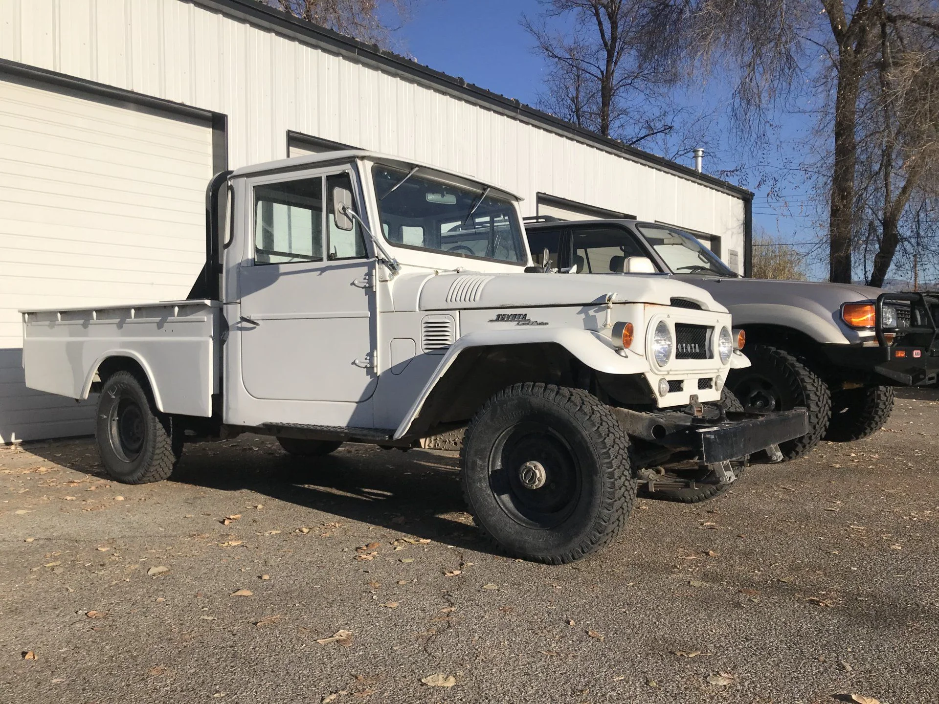

New build just showed up at the shop. This is going to be a fun one!

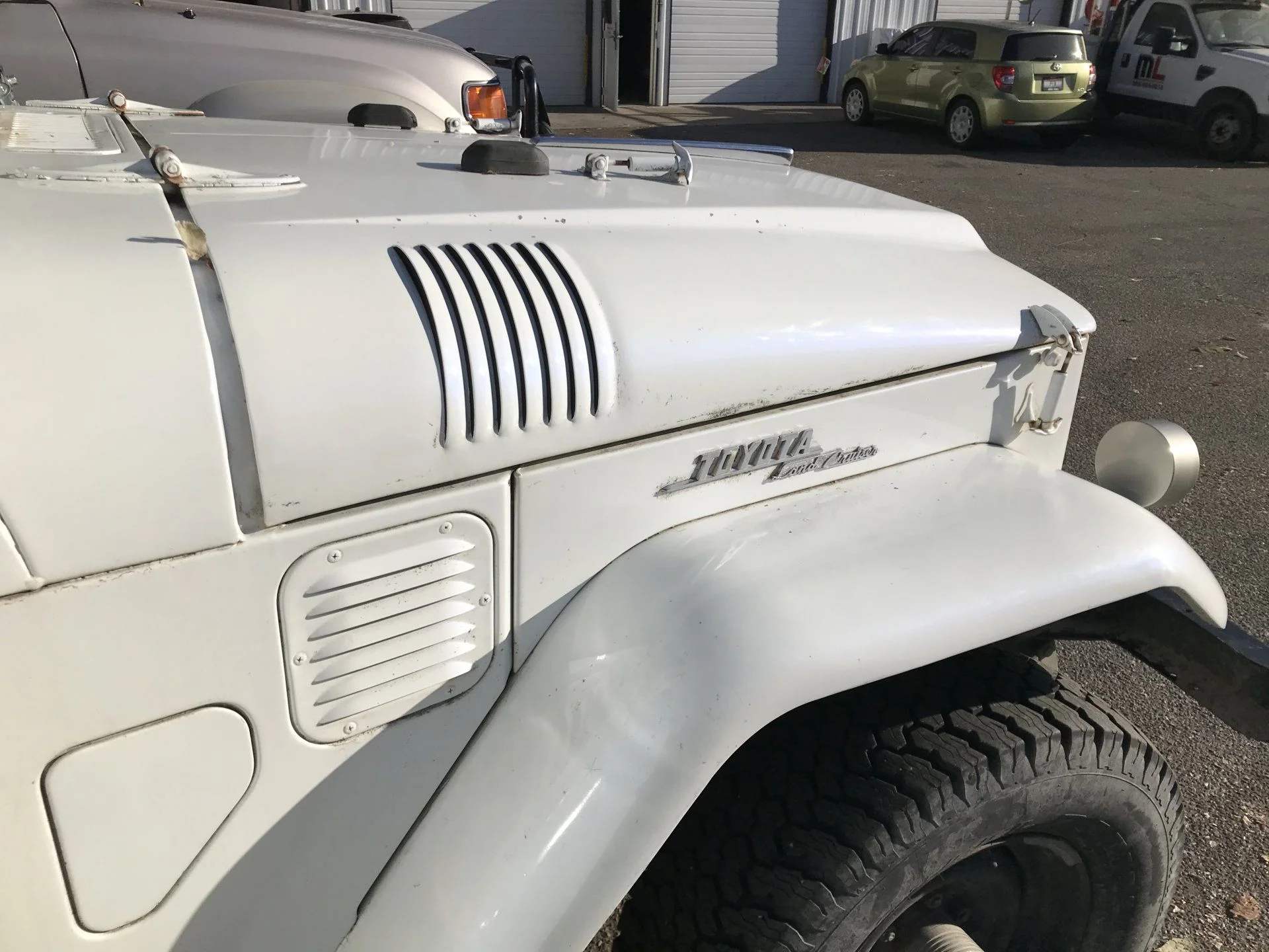

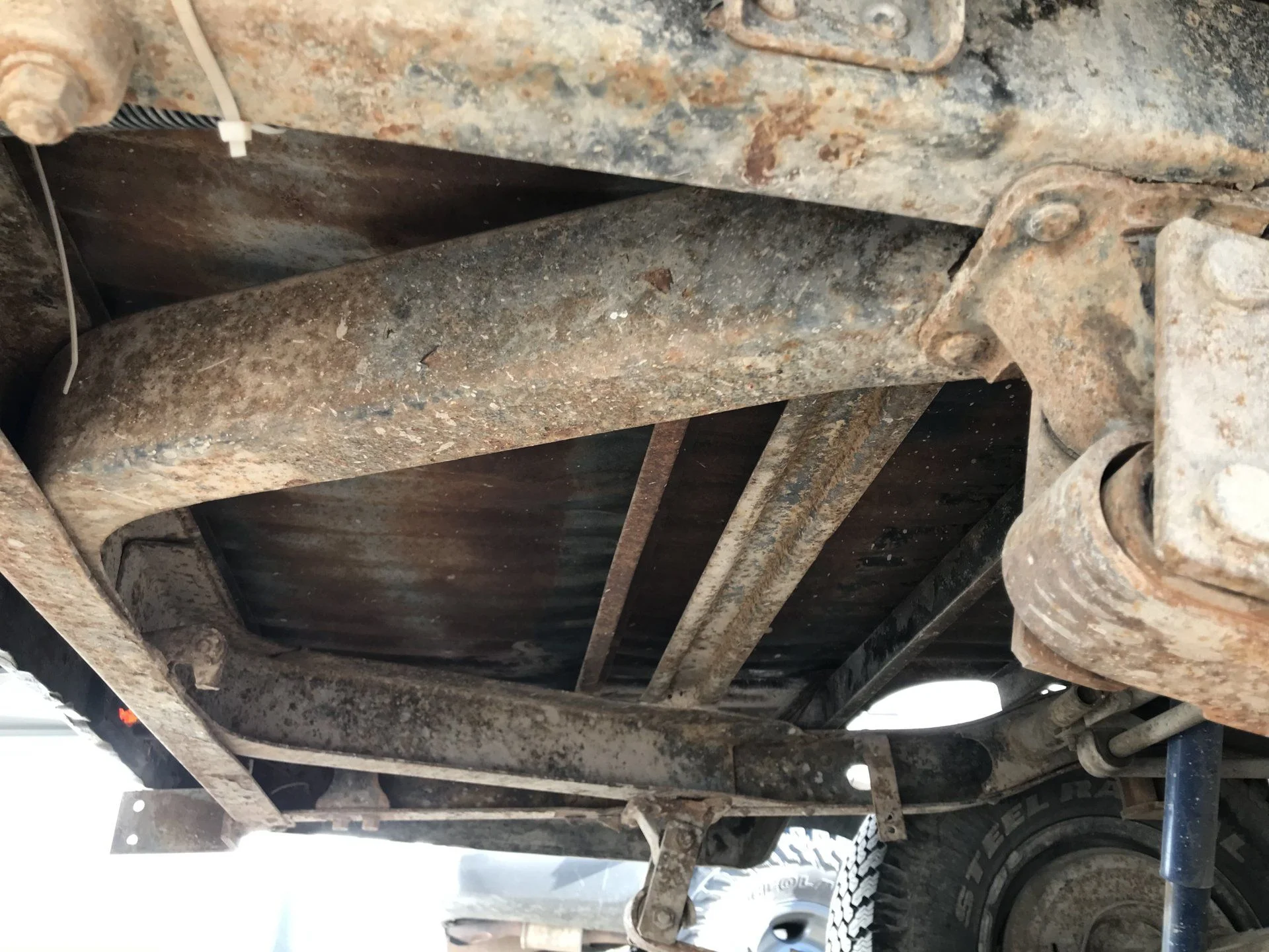

I just looked it over pretty quick, seems pretty much all original. Been painted before, not the best job. Rust, rot and bondo doesn’t seem to terrible.
Transmission is not happy at all nor is the engine. Carb is in bad shape. Brakes barely work but hey it does run and kind of drive!
More to come!

Regardless of what this gets built into guys it needs some love. It barely runs and I can barely get around our parking lot and stop it.

I went over the body last night, it truly is in outstanding condition. Probably the best body I have ever seen on a 45 that is unrestored.
