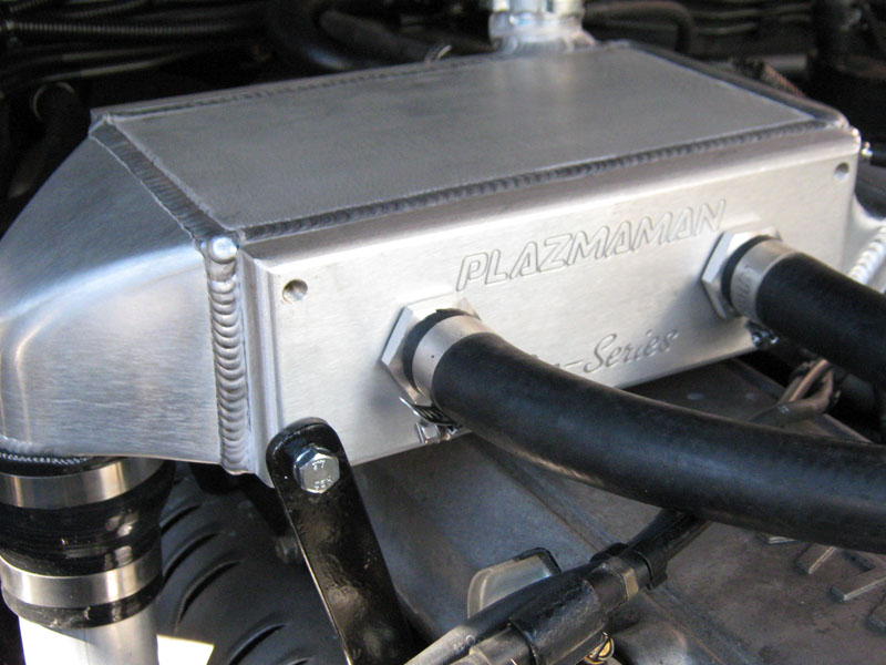

I did clarify today this will fit, just barely but it will fit.
We are going to have to get the radiator portion of it custom made to fit the 40-series grill. Otherwise, it is a go.
I don't see any other way to do an intercooler besides a big ugly hood scoop and we are not doing that.
Any ideas, I am all ears.
