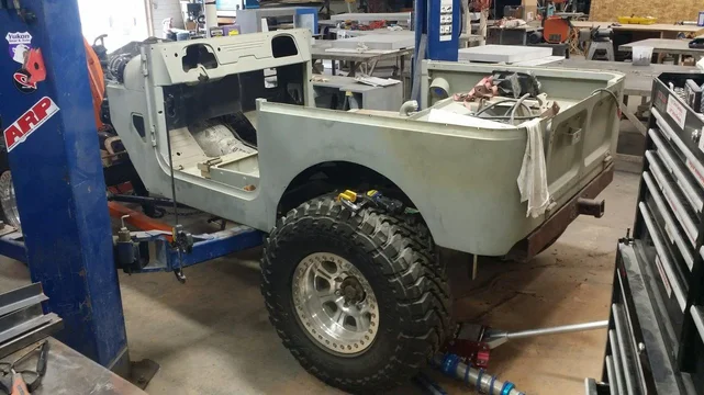

My goal is still still have it look like a Landcruiser not a chopped up rock crawler. When it has a top on it it will be the factory soft top and doors

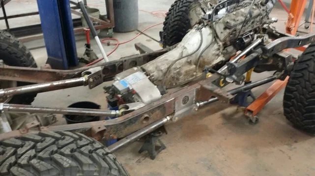

I got the LS motor pulled out of the truck and started mocking it up. Need to figure out where the upper control arms are going to go.

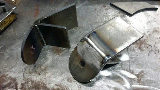

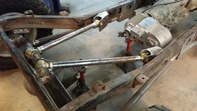

Hadn't posted any photos in a while. I got a lot done since the last post. finished the front four link, finished the motor mounts for the third time and
made a transmission mount.
I think I got the ride height just about where I want it.
now its time to make some shock towers.
At full compression everything is super tight but I think we got enough clearance.

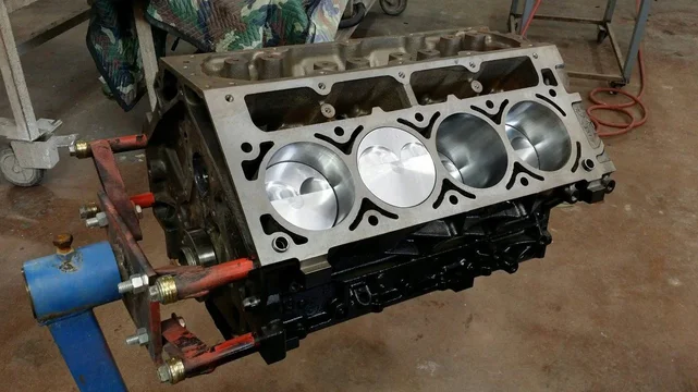

Motor is going together nice. Enough ARP bolts and studs to fund a small house
I'm thinking it may need another cross member or two in the frame. the transmission mount bolts from side to side but im thinking it may need more. Any thoughts on this?
