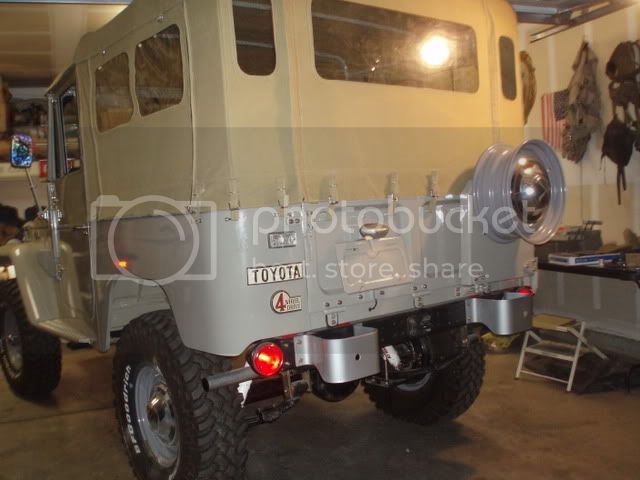

I noticed that the rear frame cross member (that you mount your bumperettes to) don't have the big frame rivets all over it. Looks clean that way.
There is a bracket that is spot welded to the tailgate. There are two tee nuts spot welded INSIDE the tail gate. The top of the license bracket bolts to the bracket that is spot welded to the gate. The bottom of the license bracket bolts to the tee nuts. The attached pic shows the top bracket that is spot welded to the tailgate. I have more detailed pics if you need them.

Yep The license plate bracket is bolted on the bottom :p
So, I'd have to re-paint the tail gate anyhow.
1. Grind off the paint to spot weld the bracket on. It would burn the paint on the opposing side.
2. Re-paint the tail gate with the spot-welded bracket on.
3. Drill two bolt holes at the bottom of the tail gate (this would be horrible, because stock the holes are threaded. There is no way for me to do this as I'd have to put nuts on the inside which would do nothing but look strange as the back side is not flat and runs the possibility of scoring up the rear sill.)
4. Drill the rear sill to run wires up to the plate light. Not that big of a deal, just another drill hole.
I do agree with you guys - it seems the best "looking" location and is stock-ish. My big concerns are 1,2 and 3 above.

Well, I was digging through my bracket bucket and found a rear license plate holder like you see on Destin's cruiser. I don't have the spot-welded piece however. Any of you have one?
Here is what I was thinking.
Just use some low profile phillips metric 6mmx1.0 bolts to hold the spot-welded unit on. Then, bolt on the lower section, and be done with it.

Sounds like a decent plan...anyway to mock up with double sided tape or something? I think it will look a lot better than where it is now.
But, most importantly, are you happy with this...this is YOUR truck, so in the end you should be the one most happy with your work.
Well since you have to grind, drill and weld regardless of what you decide, you may as well do it right. Bolt the top bracket in place, drill the bottom holes through the top layer of the tail gate, then cut a small 'window' into the bottom layer of the tail gate to weld in the proper tee nuts. Then weld the window back in place, grind, fill, prime and paint!
