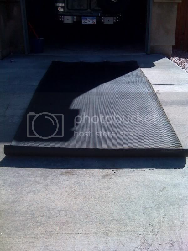

I went to my local Big R (Tractor Supply/ Farm Warehouse / etc...) to look for a bed liner. This was inspired by Dom's job earlier this summer on his 45.
While I was looking through all of the bed liners (Ford, Chevy, Dodge), nothing grabbed my eye. Then down the isle a little more were some Horse trailer liners. I had never really paid attention to this stuff (Why would I - no horses, or horse trailer) but MAN.....it's STOUT!!! Plus it looks retro - like the material I used for my running boards. Nearly a perfect match! It comes in three sizes, small- medium- or large. Large was 60x120 - just shy of the full width of the bed - but I fell in love with the material itself. So, I took the deal.
Here it is rolled out. The roll weighed a TON.

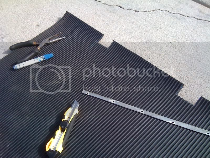

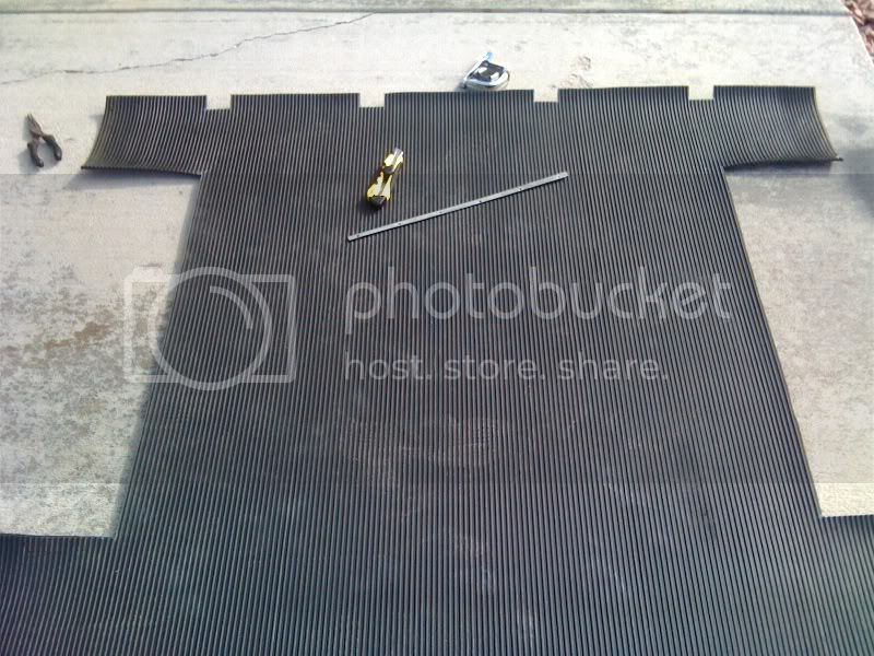

I then measured 5 times and cut once - then started cutting in the bed supports:
My daughter promptly asked me why I wanted to cut out a castle....I said "Huh?" Then I took a step back and looked at it from her perspective:

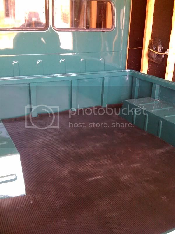

Not that I am going to be hauling horses around but I feel that if a piano were to fall in to the bed of the truck, the paint wouldn't see a knick!!
Hope you like!

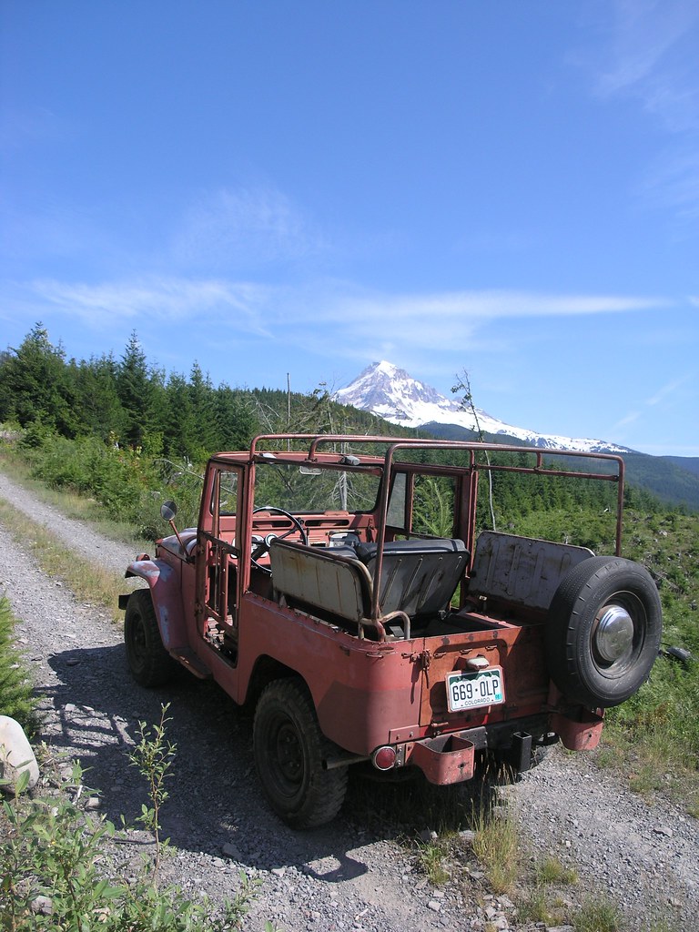

I will not take them off - but am curious - does this make you cringe?
Doesn't make me cringe. The license plate bolted to the frame does. Since you used the space on the driver's side you may as well put it on the tailgate like a 65 would of had it. 65 is the first year of the rear emblems. FJ25s had a Toyota emblem on teh tailgate:hhmm: I think if you do a little checking you find the emblems were lower. 75 started the tire carrier on the left. 1/75 was the earliest date of the 1975 models imported. (short production year). The tire carrier stayed on the right side on the few soft top models that were still being imported. Don't you just hate us purist.:rolleyes:
Kidding aside it looks great Dallas, keep up the good work.
I am with you on the license plate. Here is my dilema.
1. I don't want to remove the hubcap in the spare to put it there.
2. I don't want it in the OEM location becuase I bent the heck out of it (hangs out about 2").
3. I refuse to grind/weld drill a perfectly fine tail gate (minus the obvious dent) to put the plate there.
So, um.....not much real estate back there. So I am cringing with you on this one, but my options are few.
Dallas
PS. I have the OEM "TOYOTA" black and white sticker that goes on that rear sill. I am just afraid with the later emblems on there - it'd look cluttered.

Looks like I was the one confused. It's been years since I was able to find these in the junk yard to strip. I must have been thinking how close the 4WD emblem was to the upper part of the rear channel not the bottom lip. I really miss the days when they were plenty of old 40s in junk yards:cheers:
Here is where it was originally:
Now, the major problem with the OEM location and the one your provided above is the overhang. 2-3" of overhang means trouble in my opinion. My OEM bracket had been bent and straightened so many times by the time I got it - it was barely hanging together. Even after I bought it, I caught my pant-leg on it about 50 times. Plus, even lightly wheeling this thing - trees, or any object will fold it in half again or rip it off. I think it was just a poor location. Call me crazy - I don't know, but having things tucked in, and out of harms way is nice.
Take for example late model hard tops. I busted out a rear vent window in my 77 hardtop because I accidentally left it open and a tree shattered it.
I know the location I have it now is not oem, but it's safe and practical - and to be honest i can't think of a better location to stash it. Pretty much at a loss.
If it came to a point where NASA wouldn't launch the next shuttle with my plate where it is, I'd do the OEM setup as you see up there on Destin's. That just means drilling, spot welding, and drilling the rear sill and running a wire up to the light (things I didn't want to do to an otherwise unmolested tail-gate).
I am just thinking out loud and along with you here......I stashed it there as a best quick solution. /shrug I dunno.....

I agree with you on your stock location. I'll probably only keep one of my FJ25 license plates in the stock location since the rest with be stock too. Here in AZ no light on your rear license plate can get you pulled over. Plus I bend a license plate that was lower than the frame like yours is. You drop off a ledge slowly the bumperettes will just hang you up. The license plate will twist up before you know it happened. I still vote get the pieces and do it like destin's. The early bracket that holds the license plate bracket was bolted to the tailgate not spot welded. Drill six holes and you can put the later stock bracket on and no body work or repainting.
There is a bracket that is spot welded to the tailgate. There are two tee nuts spot welded INSIDE the tail gate. The top of the license bracket bolts to the bracket that is spot welded to the gate. The bottom of the license bracket bolts to the tee nuts. The attached pic shows the top bracket that is spot welded to the tailgate. I have more detailed pics if you need them.
