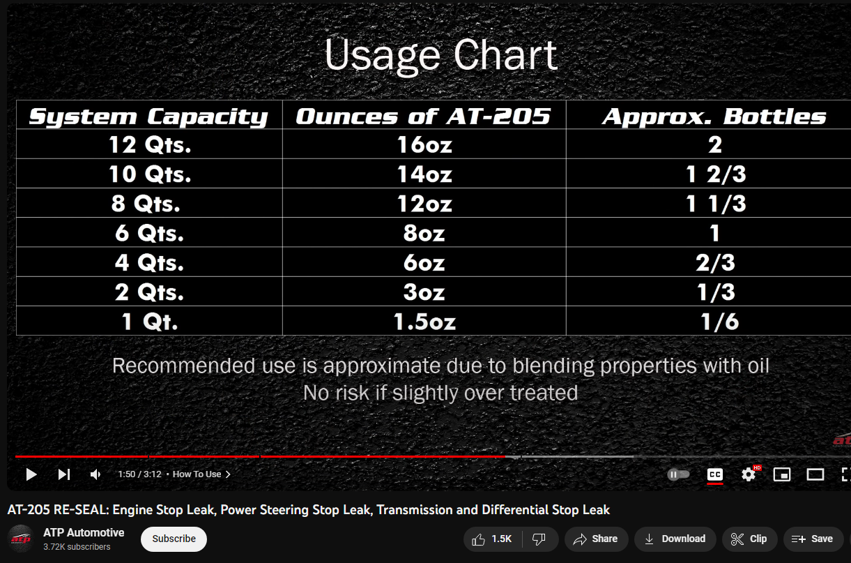

I had to work later than expected yesterday. I ran to the parts store after work and picked up AT-205 and some Mobil1 75w90. (It was a little less than half of a quart low.) I have topped it off for the time being with just the gear oil due to not having a way to get the AT-205 in (I now have a pump I can use without making a huge mess) how much of the AT-205 should I use for the transfer case?
When I used it for my PS rack leak, I followed the guidelines on the package. I don't recall what they were, but I assume the screenshot below from their youtube video on this page is the same:
Our tcase holds ~1.5 qts, so 2.25-ish oz would be their recommended amount.

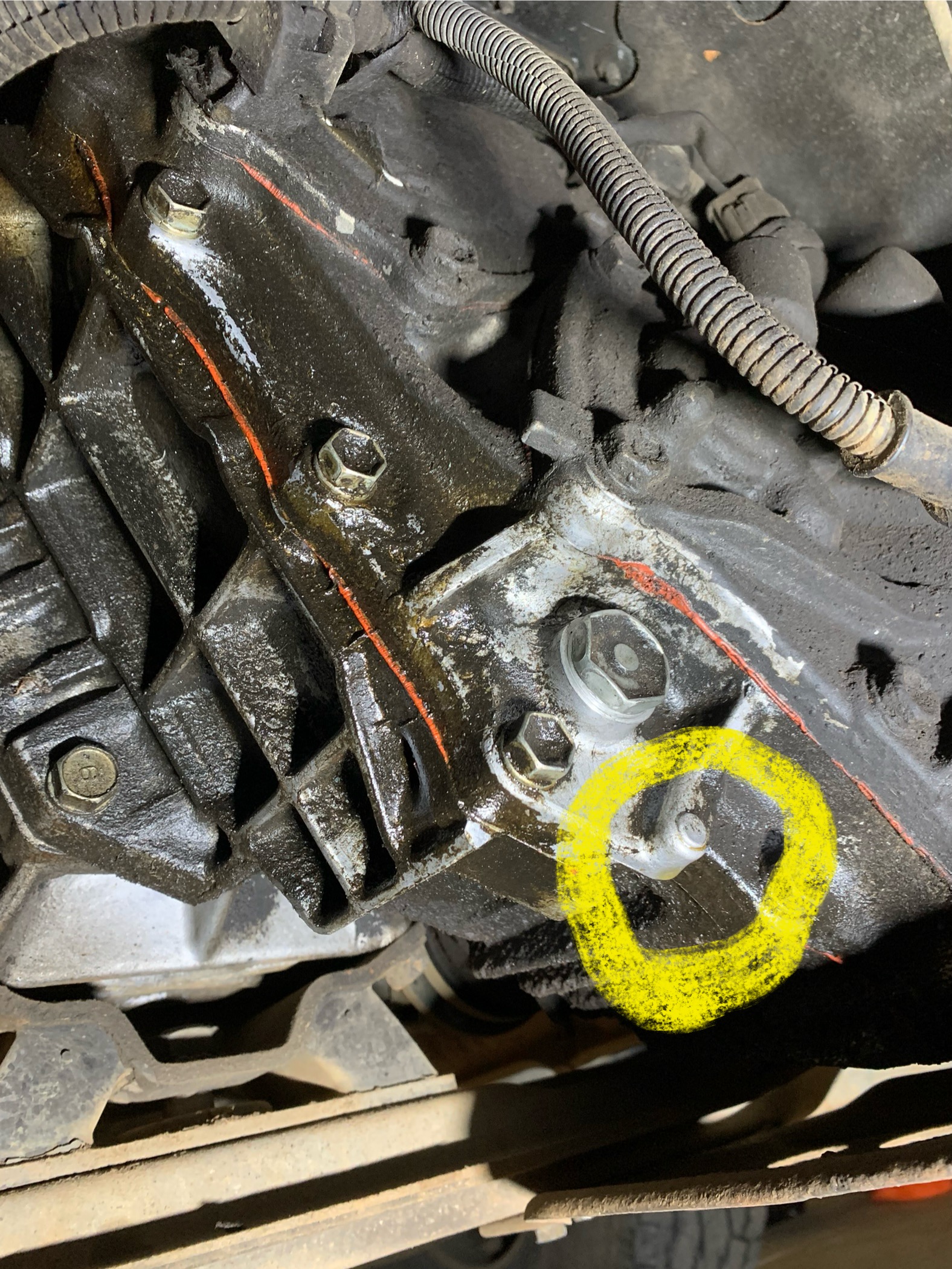

I have developed a very small drip See highlighted yellow circle Is this likely the gasket going bad? Seems like AT-205 is a possible fix. What would you guys recommend? This is a 2000 LC . Thanks

Wouldn't hurt. But could it be leaking from the drain plug? There's a copper crush washer that goes on the plug that should be replaced periodically.
AT205 will not help that, it helps rubber stay pliable. There are no rubber gaskets on the transfer case, the orange you see is Toyota Form in Place Gasket (FIPG).
I agree with @Dirt J its likely the drain plug gasket.

I would guess its the seal, as mine was developing fluid in the same area (mine was alot more than what you have in the photo)
Like mentionsd above, make sure to check/replace your crush washer. I replaced mine, added the recommended amount of AT-205, then cleaned the exterior of the case really well. I continued to keep an eye on it (once a week or so) looking for any signs of leaking.
