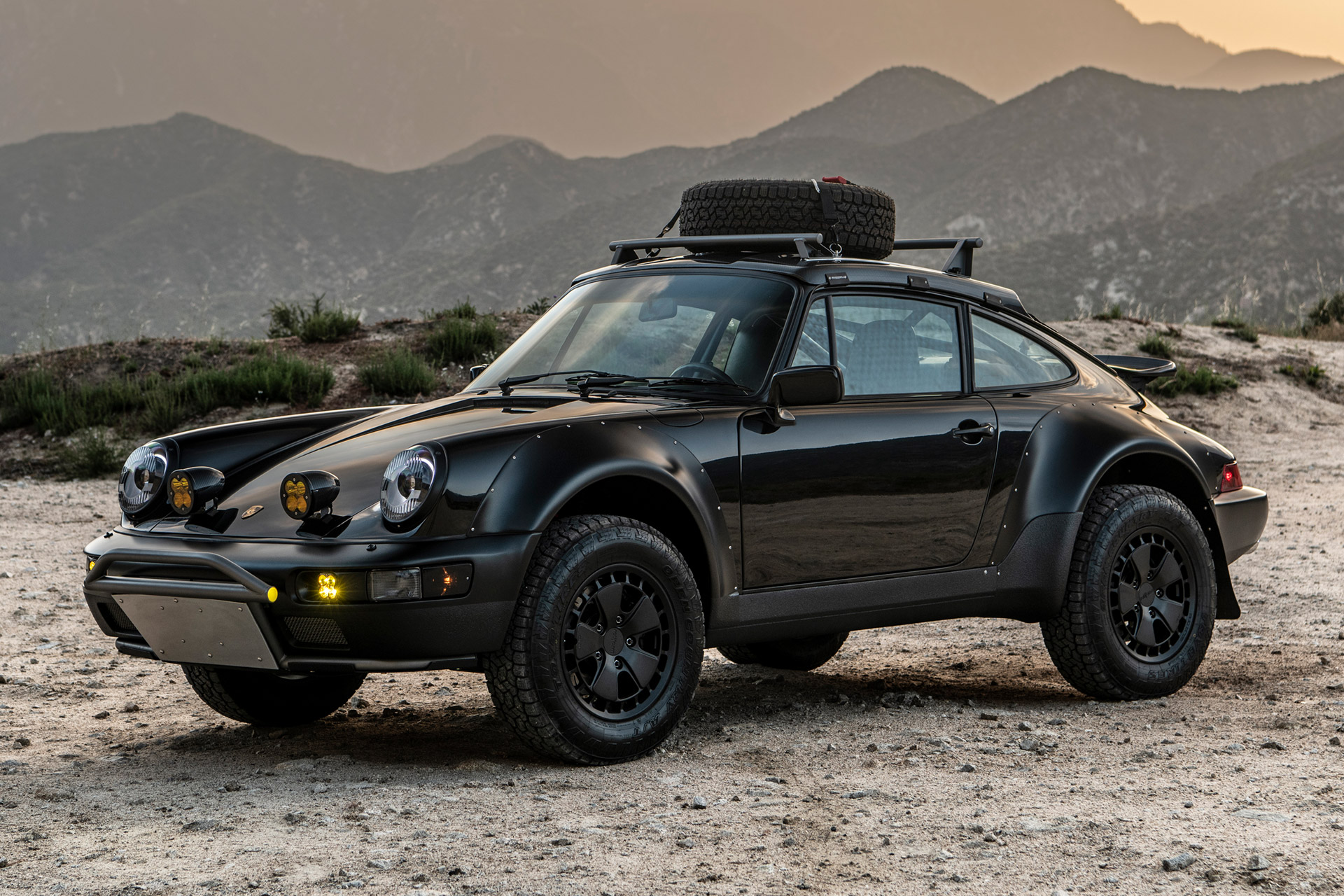

I've owned a number of Porsche vehicles with torsion bars (1979 930, 1985 944, & 1981 911), that while some of their engineering seemed archaic, the performance with archaic technology seemed pretty damn good (as long as you never wanted to brake, or lift off throttle, in a corner).
And you lifted those sports cars and made them long-travel? Not sure what relevance those vehicles have to “long-traveling” a 100 series. I don’t think I’ve ever claimed that the ride of the 100 series with torsion bars was bad - I find it rather comfortable. However, I did say that the torsion bar design is without doubt the primary limiter to long-traveling a 100 series. I don’t think anyone can debate that had the 100 been produced with a coilover design instead, then a long-travel setup would’ve been produced by Total Chaos or some other company 10-15 years ago…It doesn’t matter what component first limits travel on the 100, whether the shocks, CVs, or controls arms, what matters is that the design using torsion bars is thus far the barrier to long-travel a 100.

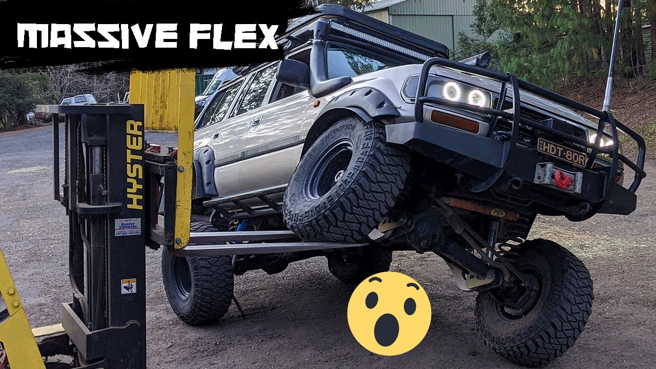

Well, I stand corrected guys. I will still say... all that rear flex and still hardly any up front doesn't make much sense to me. but. it's been done!
I drive to the trails, and around town when I feel like it... it's slow, but so are the 100's. It's all relative, if I ever do a 6BT swap in my 80, it'd be a different story.
Still going to drop this picture right here though :popcorn:

Off road, no doubt I prefer my old 80 series. I wouldn't call the 80 series a "great" rockcrawler due to its size, and overhangs, the solid axles makes lifts above 2" fairly trivial, which also makes tires above 33" fairly easy. It's still basically a work truck with leather, and carpet, that Toyota sold as a "luxury SUV".
If I drive 1500 miles of highway, to do trails (that any stock Land Cruiser could do) in Colorado, I'd really prefer a 100 or 200 series.
I agree that the lifting of the IFS, varying additional weight levels, small market, and not sharing components are limiting factors. Even of the stuff that is available, basic suspension kits for a 100 series, each manufacturer offers a number of rear coils (because they're pretty much the same as the 80 series coils), but I can't think of one that offers more than (1) torsion bar in "petrol length", and (1) torsion bar in "diesel length". Is this because a torsion bar is so hard to manufacture, or because of the other limitations of the 100 series IFS design, and the limited market, "why bother"?
I still argue that if they'd simply used a coil on a shock, and reinforced the shock mount, It would still be a ghost town for long travel kits. The small (US) production numbers, and the fact of not sharing much of anything, with any other Toyota/Lexus vehicle's front suspension, makes it hard to justify the engineering cost, considering the limited potential market.
I don't disagree that the design is flawed. I disagree with the premise that the only thing wrong with the 100 series IFS is the format of the spring.
No, no lifted long travel Porsche 911 trophy trucks in my past, and I'm not aware of anyone else that has done one either, but I really haven't been looking. I am aware that a number of people seem to like the old 911 rally cars...
