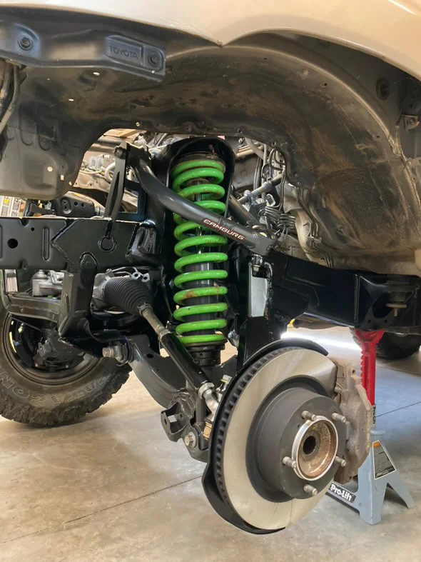

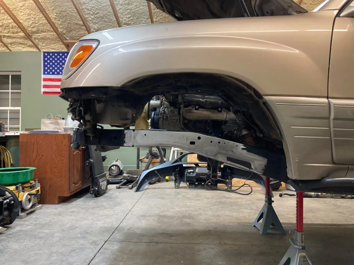

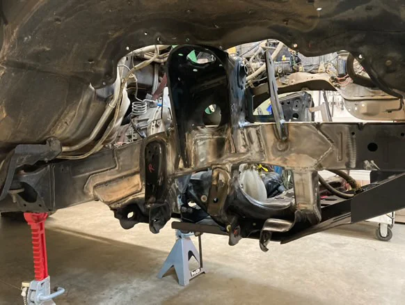

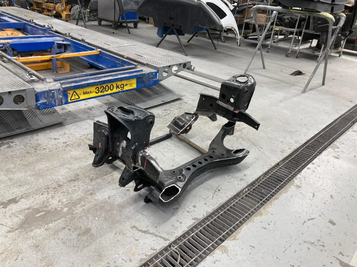

Here’s some pics of a tundra grafted 100. Was a custom job by some guy I met on IG. I’ve been leaning towards this. It’s a 2nd gen tundra frame, 200 series steering rack, and 3rd gen tundra CV that were shortened and resplined for the 100 series diff.
Bravo, and you can buy that entire front clip for cheap. The stock Tundra arms are long arms for the 100. Joe Bacal’s LX570 was getting ~ 12” of travel with stock arms and mounts. Too bad you can't easily graft the 200 front diff too. The pinion is in the wrong side.

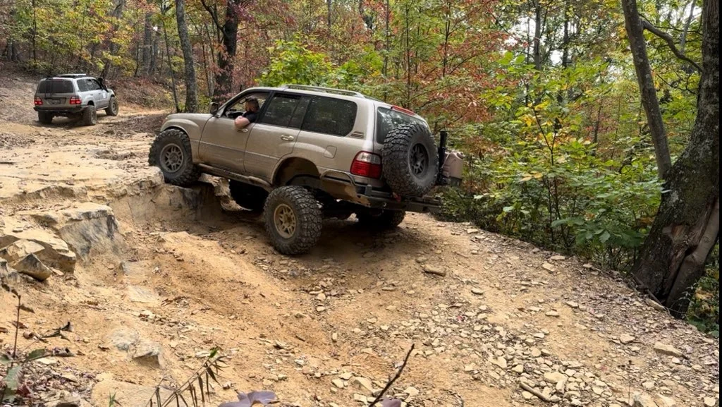

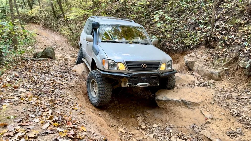

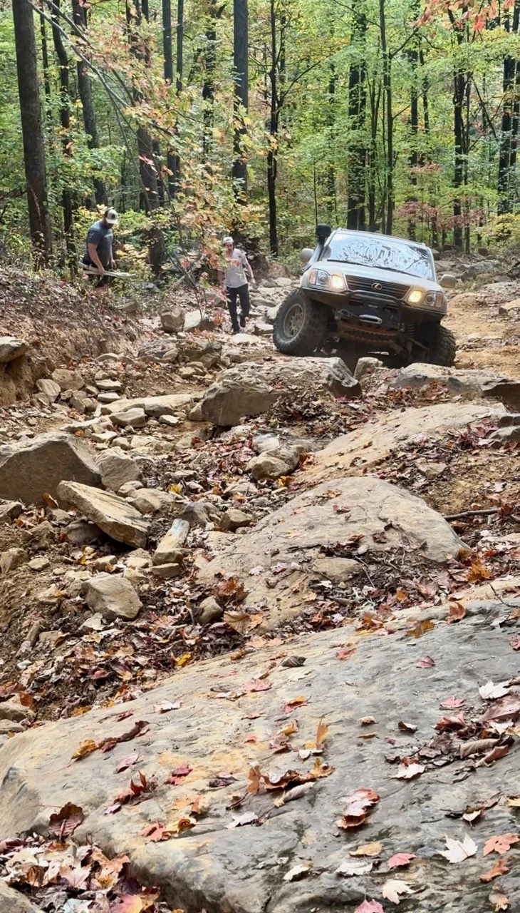

IDK his Instagram but it's Russian Alex. He bought a donor truck and it took him maybe 6 months? We texted about it the whole time as I was hoping it was possible for me to produce bracket kits for it on my plasma table. The new set up has allowed him to run 37s on his truck comfortably (with trimming. Pics show it after the body work, which he did himself as well)
View attachment 3797753View attachment 3797754View attachment 3797755
