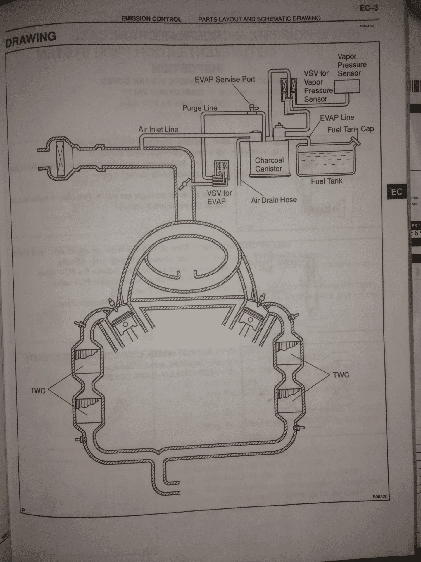

This is partially helpful, but I wonder if the FSM has some descriptions of how the purge is activated, and how the air inlet and air drain hose work, and how the vapor pressure sensor works? I asked in your other post if you could see how the charcoal had been damaged by the liquid fuel getting up there?
upload_2017-8-27_21-38-41-png.1525884
I couldn't tell a difference by just looking at the charcoal. My understanding is that the charcoal works by using its massive surface area (its very porous) and the fact that its carbon to bind with stuff that travels through it. Its like a big sponge. Its purpose is to absorb the ordor when the evap system is venting. If the only problem was the damage to the carbon itself (getting gummed up with too many impurities) we'd be ok, because the system would still vent. The issue is that the vent passage gets blocked, either by liquid fuel, or the valves getting stuck/blocked.
I have not found a nice explanation in the FSM about how its supposed to work. I can infer some stuff from the diagrams, and the methods to test it.
