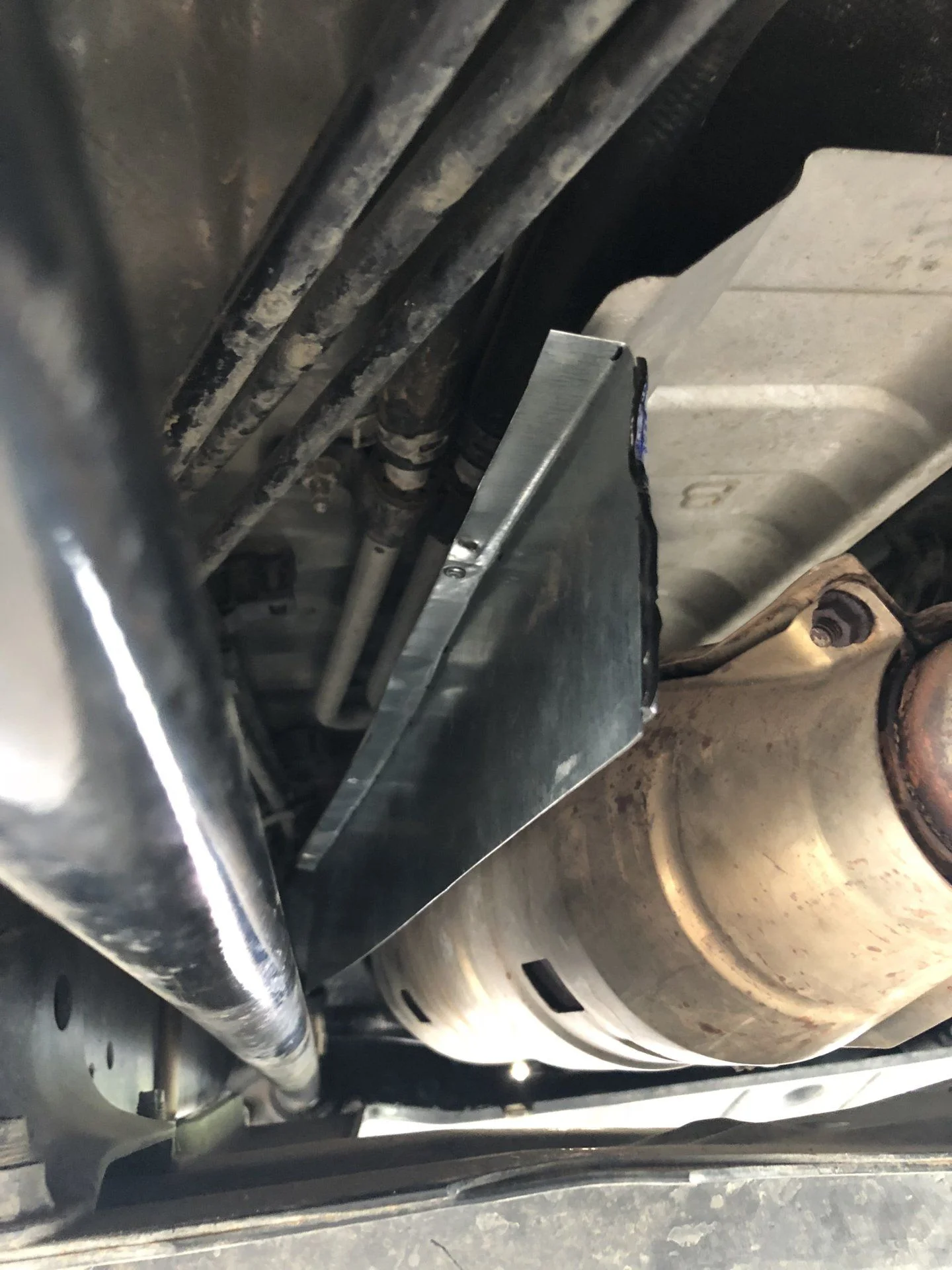

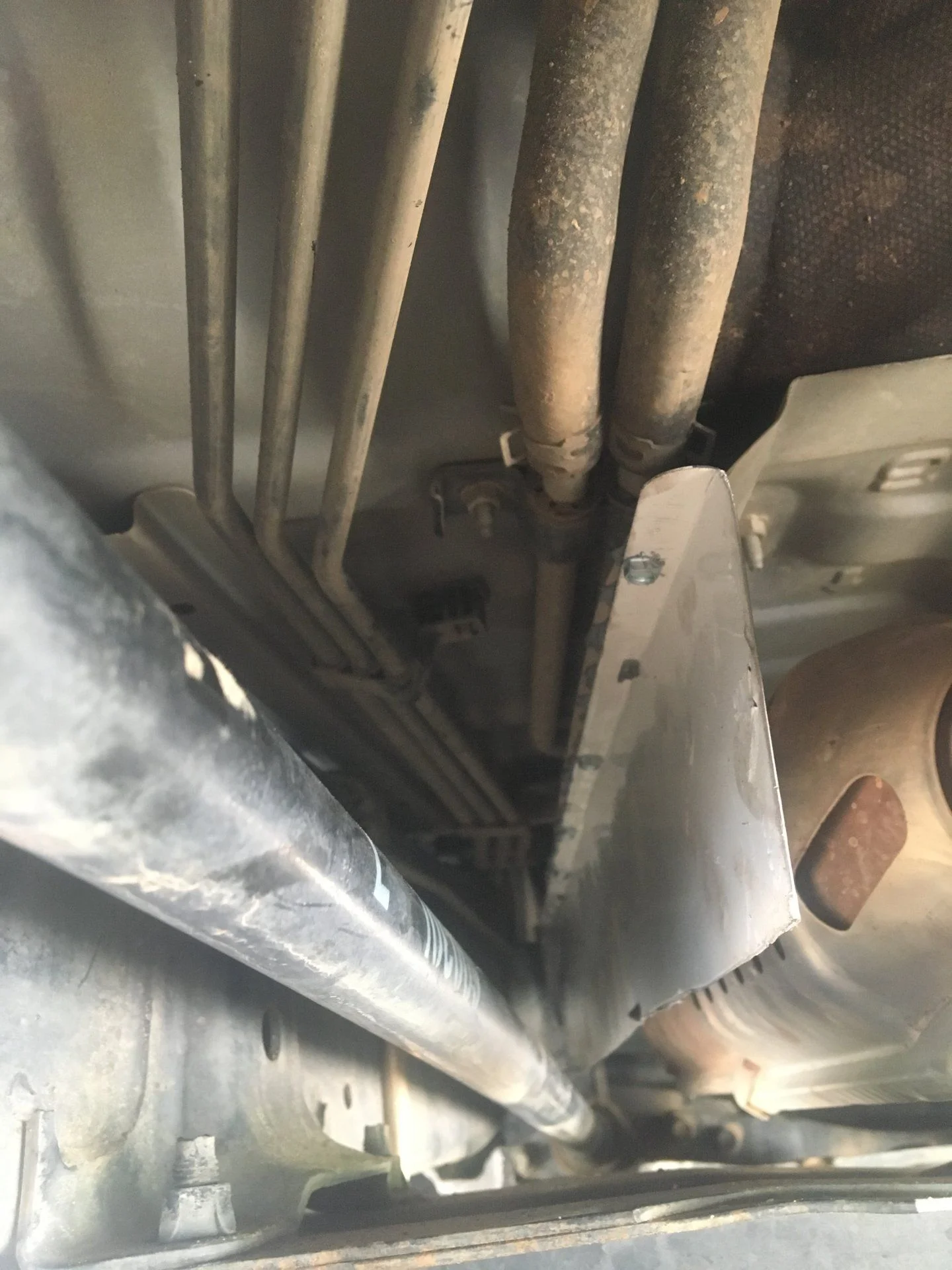

UPDATE: I went on a fishing trip in early august. The temperatures were 90-110 the entire way. It's been an early and hot summer this year in s. california. I filled up the land cruiser with a full tank half way through the trip. There were no symptoms whatsoever. No vacuum when opening the gas cap, no hissing, no gas boiling or even smell of gas when driving. This trip had the high temp and elevation gains which has CONSISTENTLY caused the symptoms mentioned previously, but the LC experienced no such symptoms this time!
I believe there are 2 problems on these LC's, one is a charcoal canister and fuel tank vent which caused the engine to sputter and die and on 06-07 models (possibly earlier as well), need to be replaced with updated units. The second are the fuel lines run near catalytic converter causing to fuel to overheat.
Lastly, i added a heat shield near the catalytic converter to block radiant heat which caused the gas to get hot, taking off the previous temporary heat wrap i had wrapped the fuel lines in. The heat shield is 24 gauge sheetmetal, 23" by 3.5", riveted to the existing cat heat shield. I added thermotec heat shield to the sheetmetal, only because i had it laying around, i believe it is NOT necessary...
I'm posting detailed work and results on this topic because, frankly, this was a huge PITA for me and had me considering selling the LC but i believe it's solved once and for all...

Yep that'll boil your gas in a couple hours, alright. Good catch. I thought something like that might be happening in my #2 scenario on the last page. I will be doing the same mod to my truck right away. Hot gas makes more fumes too which would exacerbate #1.
#2, fuel boiling in tank. ... Perhaps a heatsink on the return fuel line may help. I also don't know if there is exhaust or coolant hoses that may be running close to fuel lines or the fuel tank.

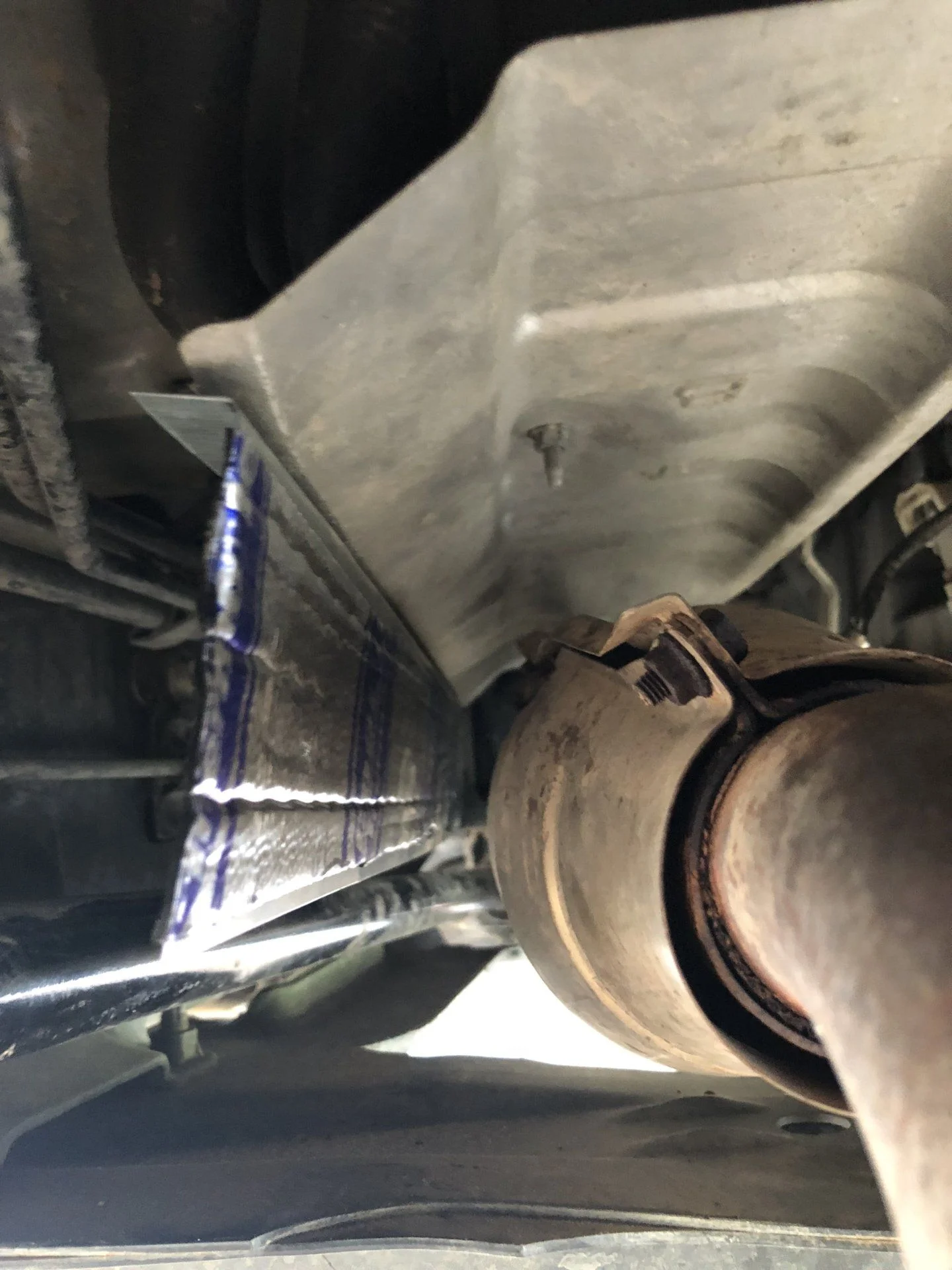

my attempt at copying your shield, its 4x24” it makes sense that these lines are to close to the cat . I used heat reflective tape because I had it here, but like you said it’s probably not necessary. Hopefully this will have the results that you achieved
