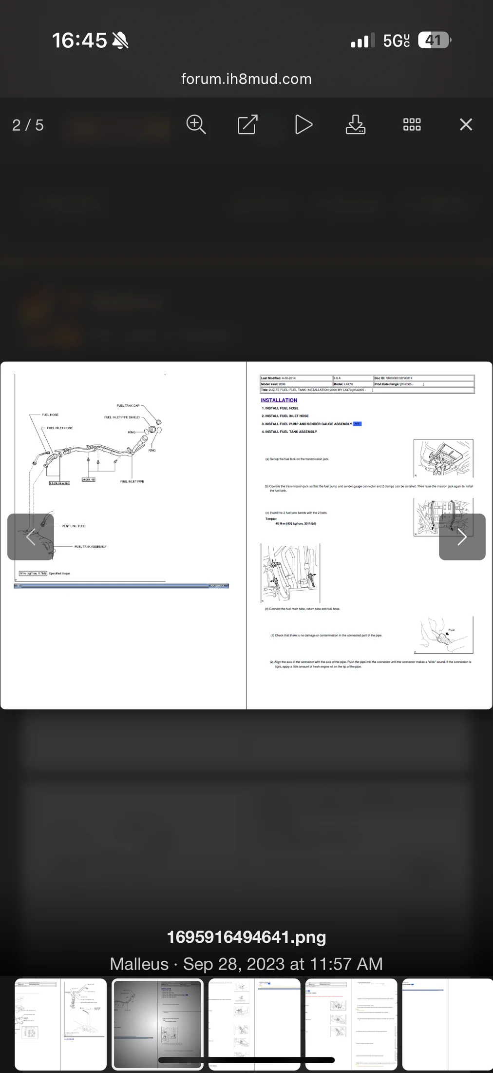

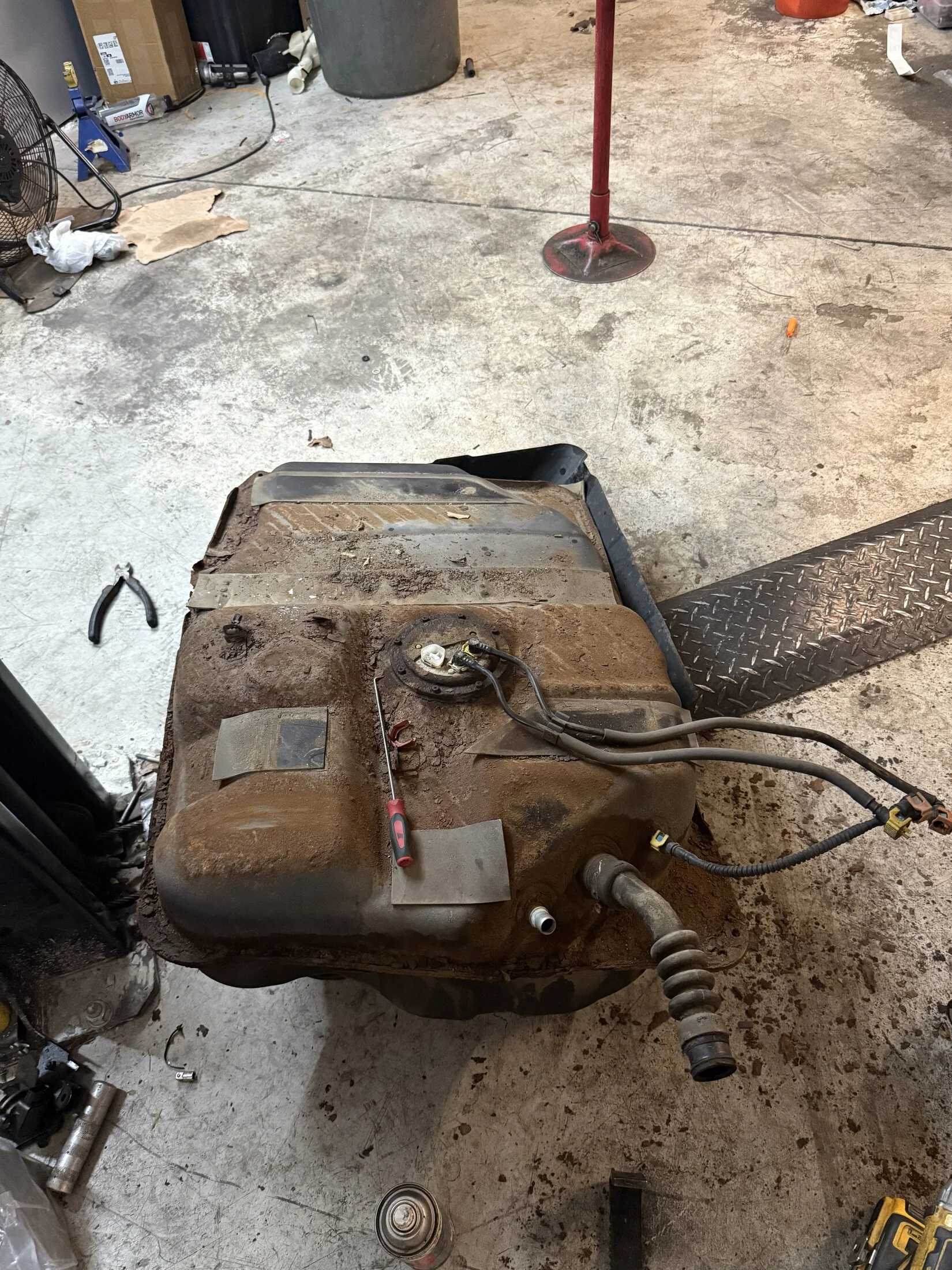

I recently purchased a 2006 LX470 and am replacing the gas tank. I bought the TRQ one that said it’s a guaranteed fit on many websites and it does not fit the lines for 2006 gas tank. I actually can’t find a single ACTUAL 2006 gas tank anywhere. None of the ones I see online have the three connections on the side with only one hole on top for the fuel pump. Pictures provided of my tank, tank I bought, and also the replacement instructions that show the proper tank lines. I literally cannot find this gas tank anywhere. I’m wondering if my only option is to retrofit all of the lines by buying the individual parts from the other tanks. Pls help lol

Are you able to swap your items from the old tank over to the new? That's what I did when I replaced my tank with another used one.
Though, I'm not sure if there are any differences between my 05 and your 06. But, I would suspect the tanks themselves are pretty identical across all later model trucks.

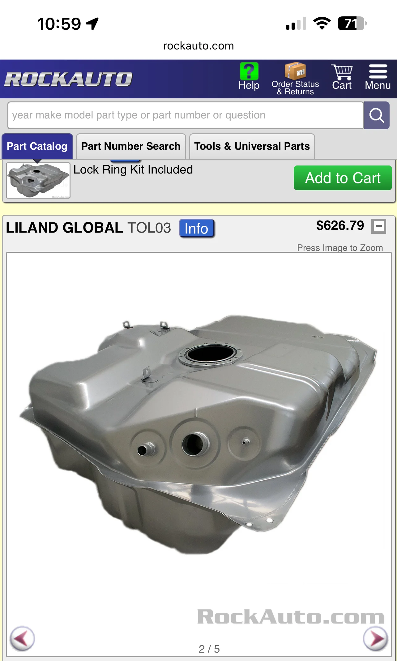

I recently replaced the fuel tank on our 06 LC. It looks exactly like the one you have with the three inlets on the end corner. Leland makes an aftermarket tank or you can find a used one in a salvage yard. RockAuto
Do you have a link? I see the Leland one but it looks like the one I bought
Thanks for the help. My first forum post and it was solved in a day! IF anyone ever has this problem or needs to replace their LX470 2006 gas tank you have to search 2006 Land Cruiser tank and get the one with only one hole on the top and three inlets on the side! Rock auto has it as well: I was able to get it cheaper elsewhere using a Memorial Day code. 2006 TOYOTA LAND CRUISER 4.7L V8 Fuel Tank | Shop Now at RockAuto - https://www.rockauto.com/en/catalog/toyota,2006,land+cruiser,4.7l+v8,1432856,fuel+&+air,fuel+tank,6268
