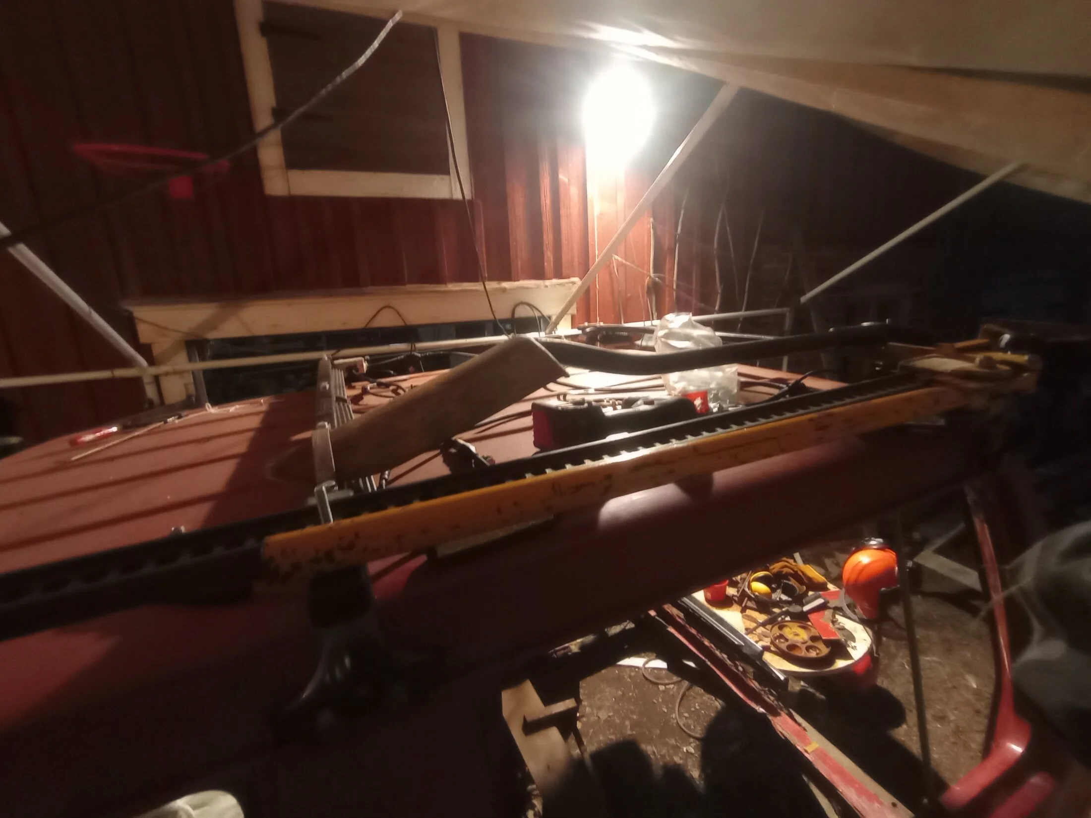

Working on accessories that won't be relevant for a year or so continues with the roof rack. I guess I'm getting tired of welding or something.
The base is two Thule Squarebars, 75kg capacity each. This is the cargo space, the side bars are just for mounting lights to. The local dollar store had a sale with work lights for 6€ each and LED bars for 40€ each, so I got six work lights and two bars. The bars will be mounted under the front rack and I'll have two work lights in each direction. On the left side of the racks I'll mount a hi lift, shovel and possibly some traction boards, and the right side will be reserved for cargo.

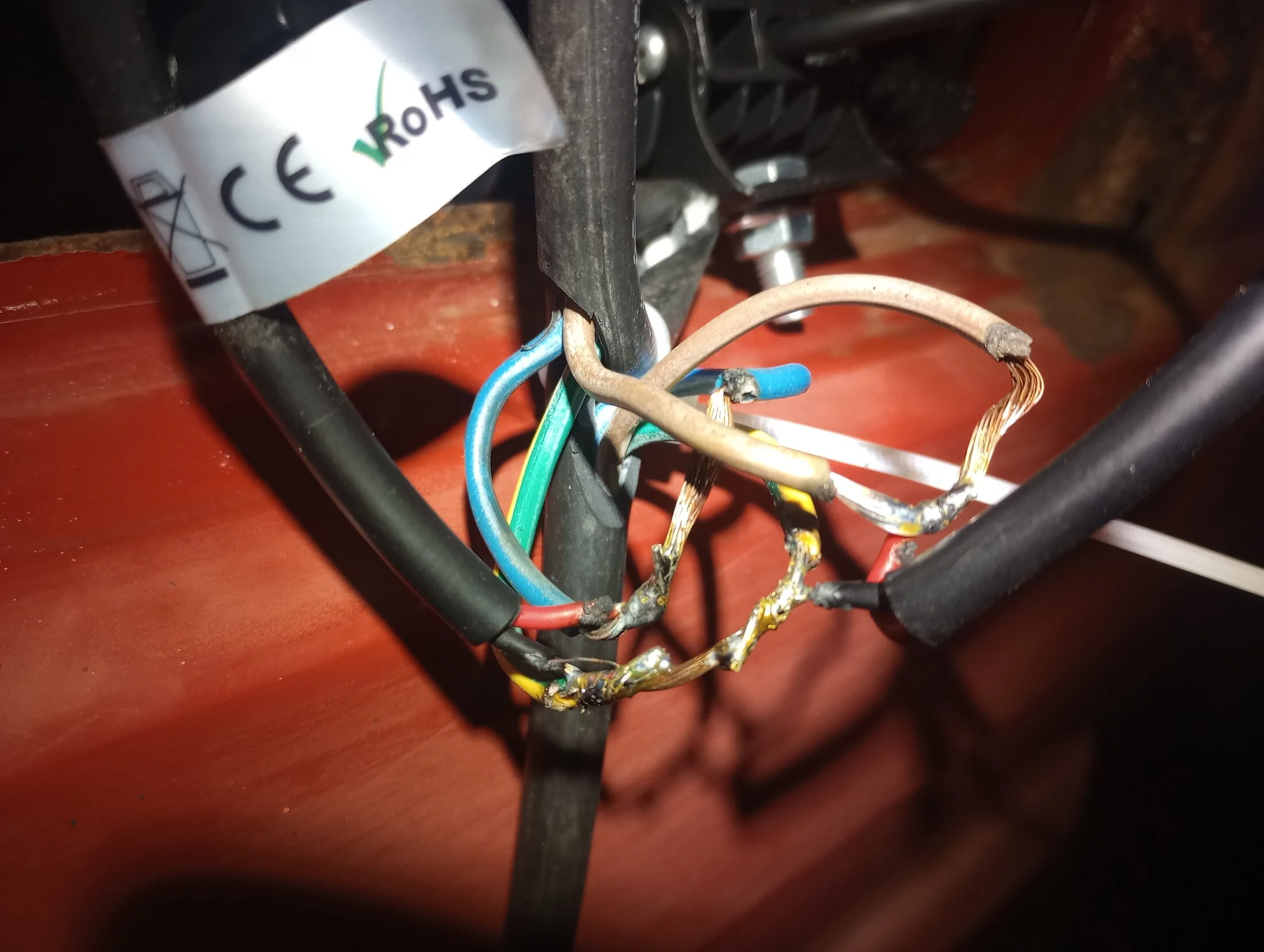

The charging is fixed! I got a new original regulator from a scrapped Tercel. I also had to fix the dashboard as I accidentally burnt a wire while testing.
Originally I planned to solder it, but then I noticed there's screws on both sides of the break, so I came up with a much easier fix:

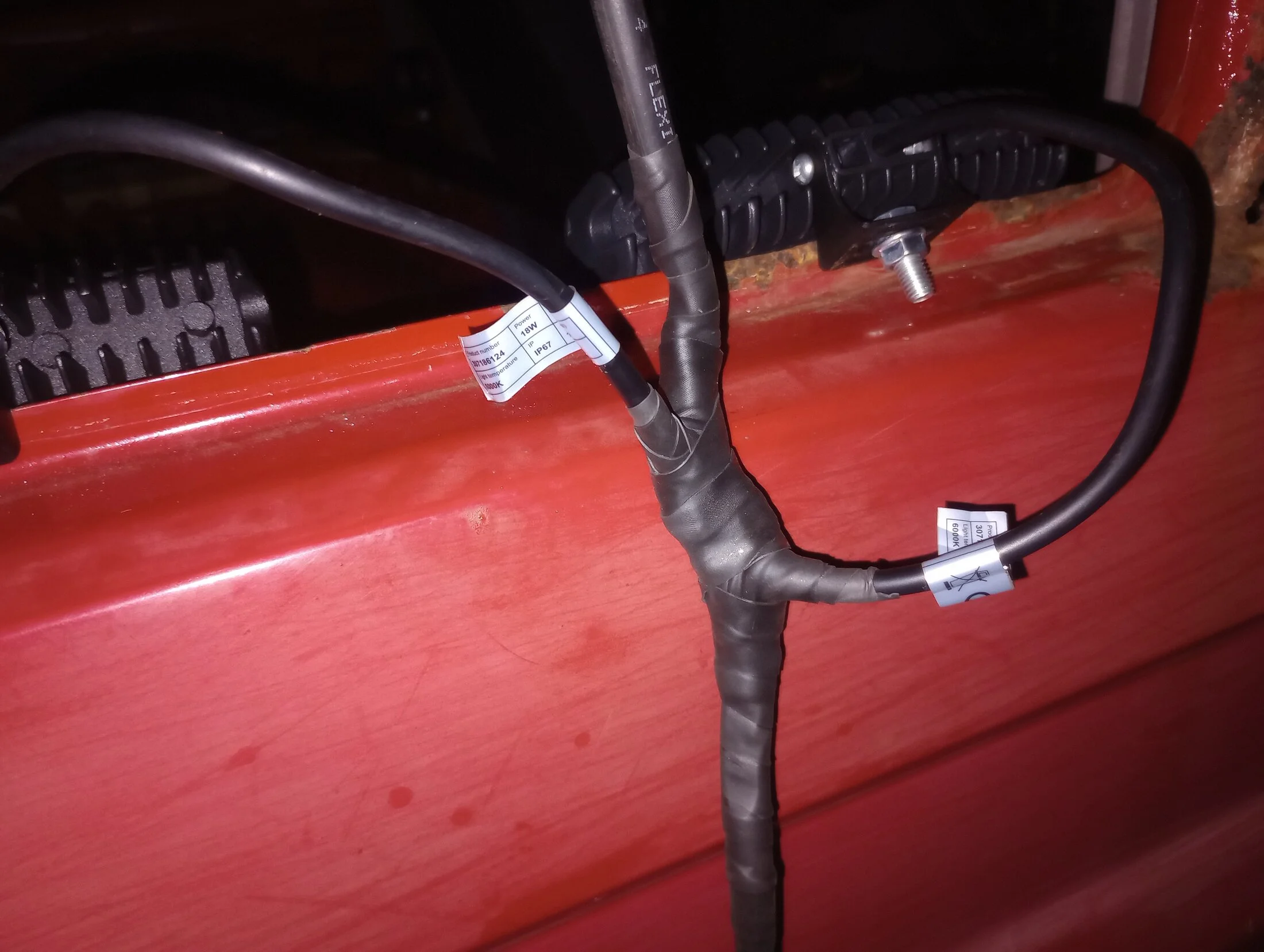

After I had the charging figured I decided to connect some more work lights. I usually botch together something with screw terminals and crimp connectors, but since this will live on the roof of a car I decided to do it properly. I soldered the wires...
...insulated the connections with self-vulcanising tape...
...and covered it all in self-vulcanising tape to make it sturdy and waterproof.

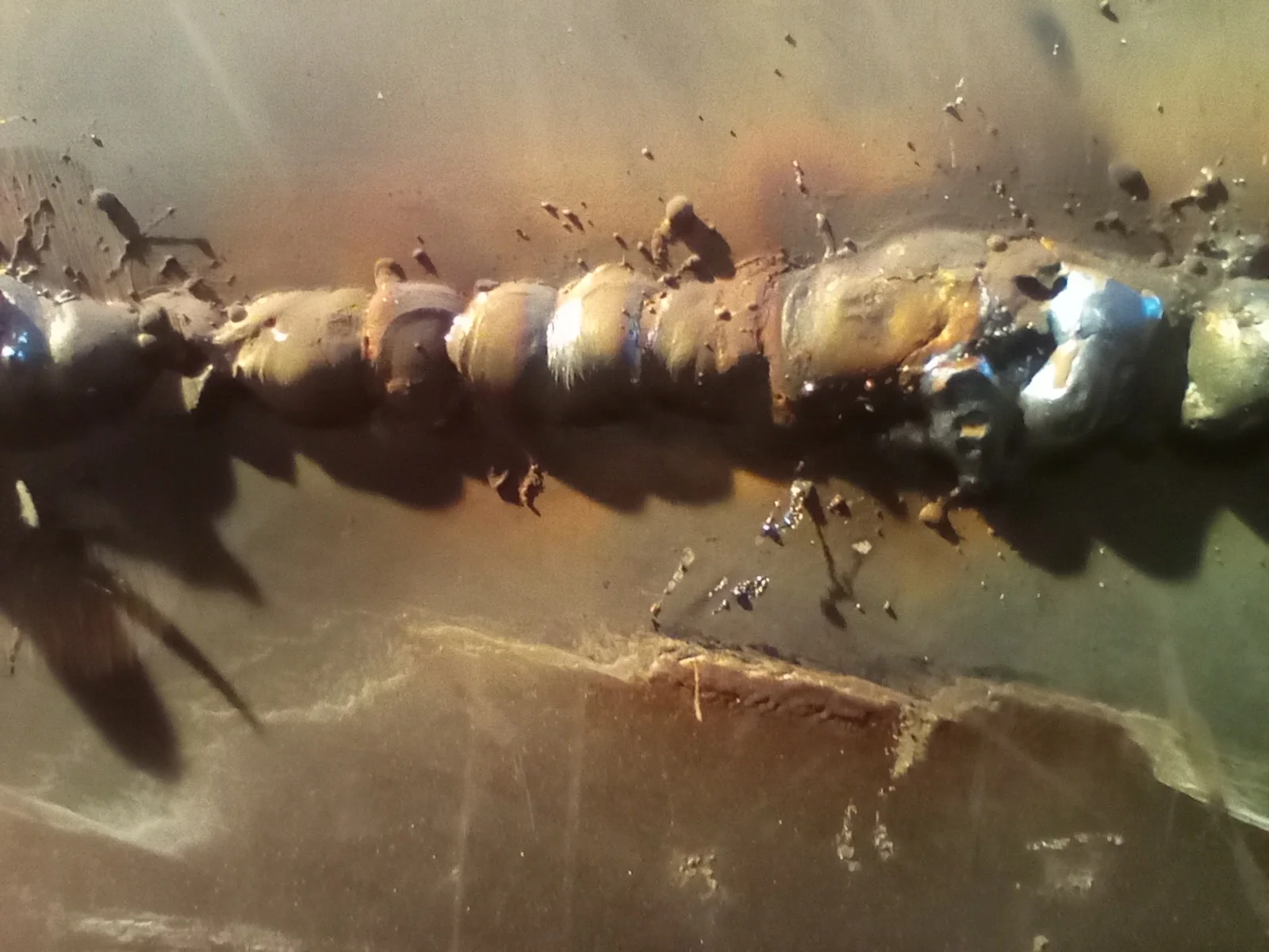

Got a little bit of welding done today. It got extremely porous for some reason, I'm not sure why. The gas flows fine and the metal was pretty clean. Shouldn't be too much of a problem though, it's not exactly a critical load bearing component.

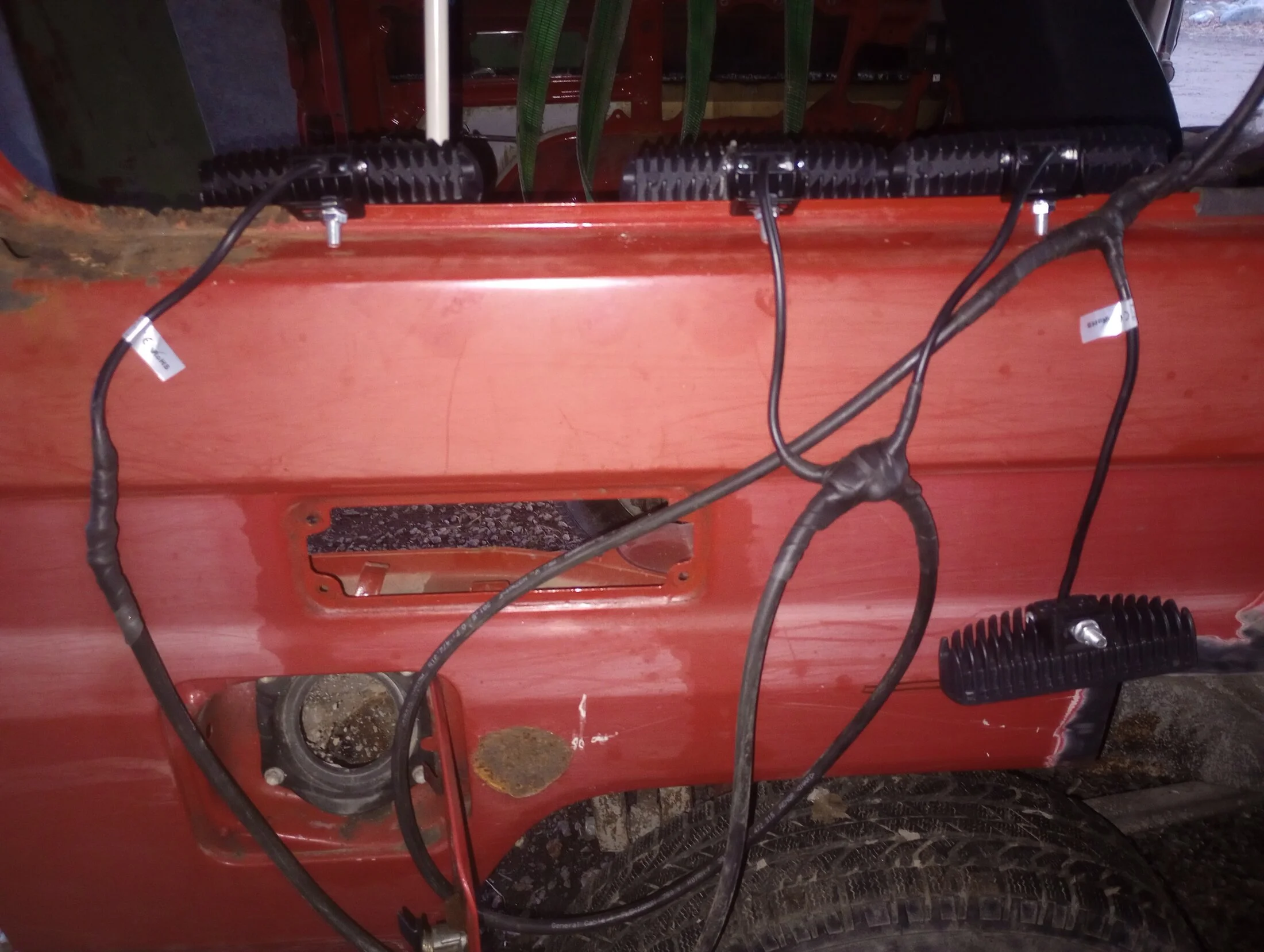

I have a lot going on in April, so there hasn't been and won't be much time to work on the Cruiser. Today I found an hour to get the roof wiring done though.
All six work lights are connected along a wire. The sides will be on one switch and the back on another, to be able to use them as reversing lights in public places without blinding everyone.

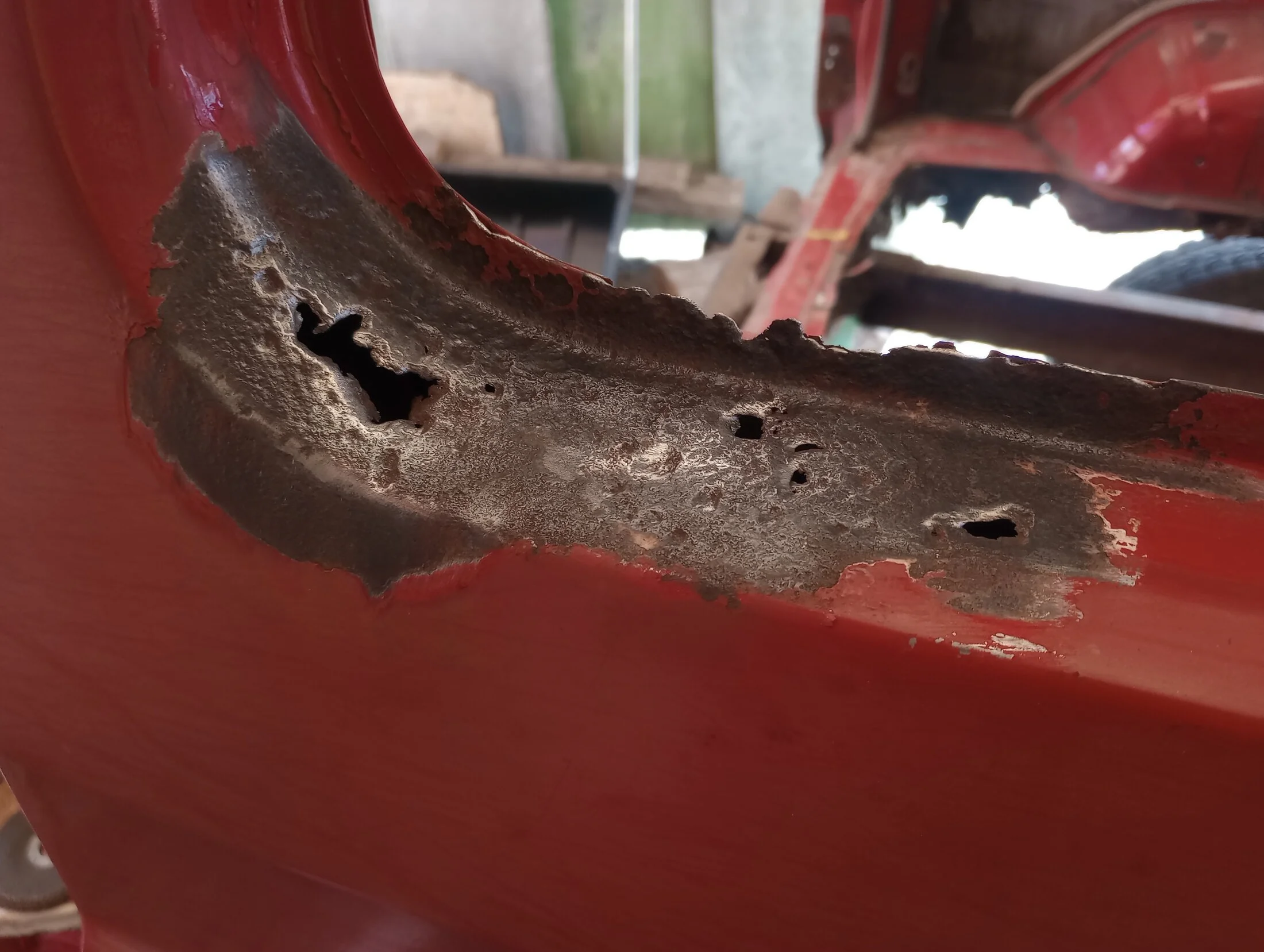

Got the final fender piece tacked in place today. Now I just have three rust holes left and then I can pick the body off the frame.

Today I was about to finish welding the wheelarch, but the porosity problem has gotten serious enough that even I am starting to get concerned.

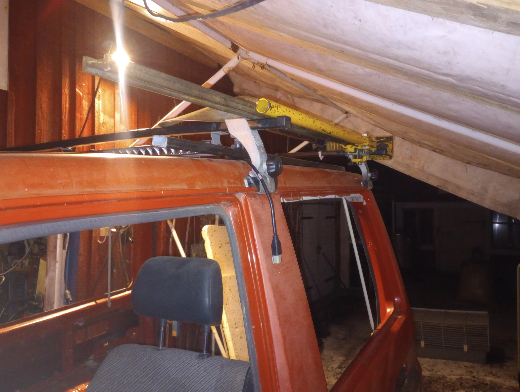

So, I decided to finish the roof rack instead. I didn't get it completely done since I was troubleshooting the welder through Reddit at the same time, but I have the LED bars as well as two more work lights mounted, and most of the assorted metric and imperial bolts of various lengths and conditions that used to hold it together has been replaced with fresh M8 bolts, nuts and washers.
The chickens weren't very good welders. The welder works fine now though, so I got everything that doesn't need filler sheet welded.

The roof rack somehow isn't completely done despite it being all I could work on yesterday. It's getting close though, I just have to replace a bolt, drill two holes, bend a piece of metal and cut the bars to exact length.
I also went and bought three Hella Rallye 3003 for the fantastic price of 30€. They aren't in perfect condition, but I already have the LED bars for when I need a lot of light. The Hellas should give me plenty wide light pattern for offroading while also giving me a bit more brightness in the warmer halogen tones for foggy and snowy conditions.
Have I not gotten anything significant done since 19th april? Anyways, I did get a little work done today. The roof rack is completely done with tool mounts...

I planned to also get at least something done on the rust holes underneath the side window...
