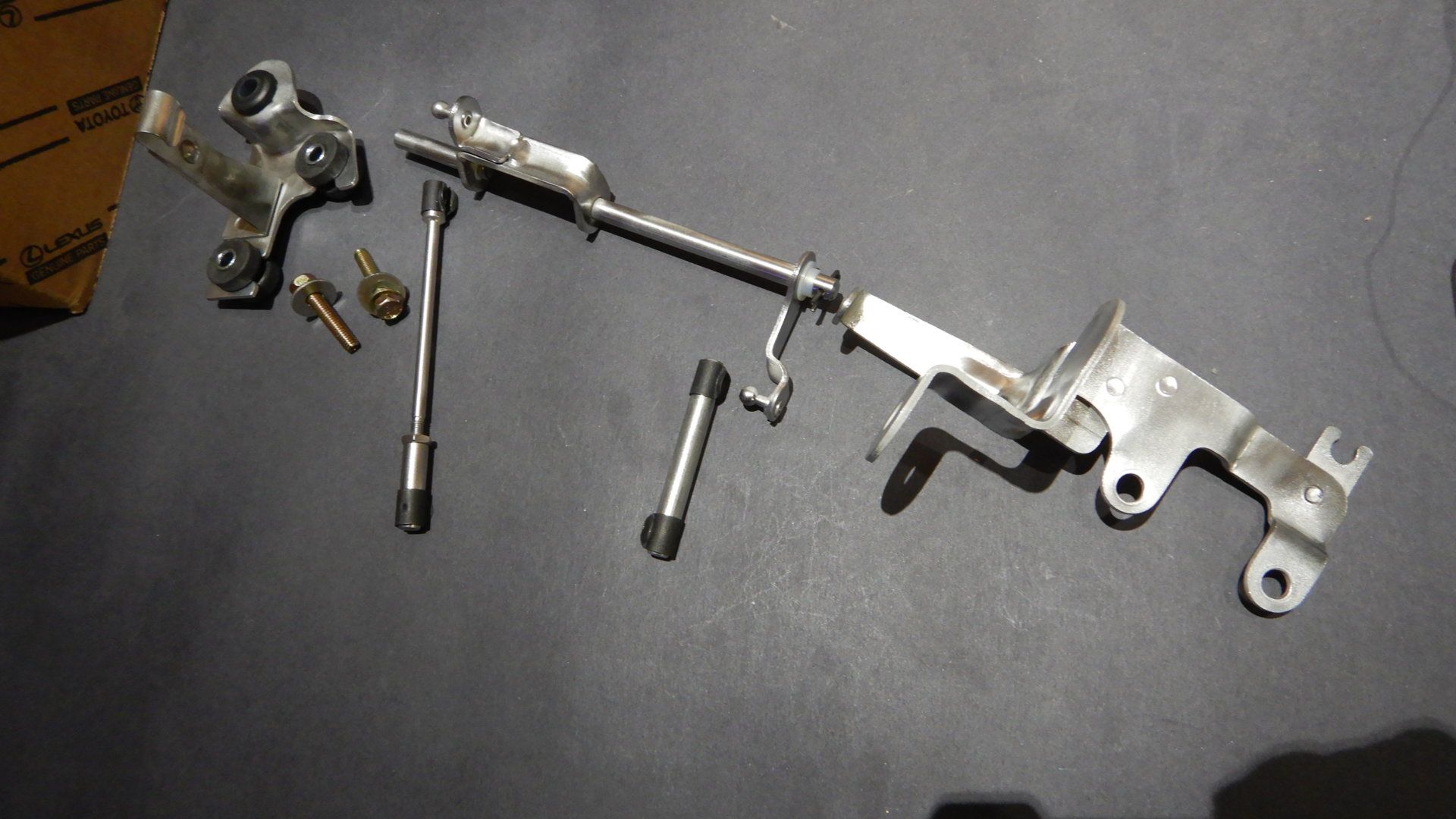

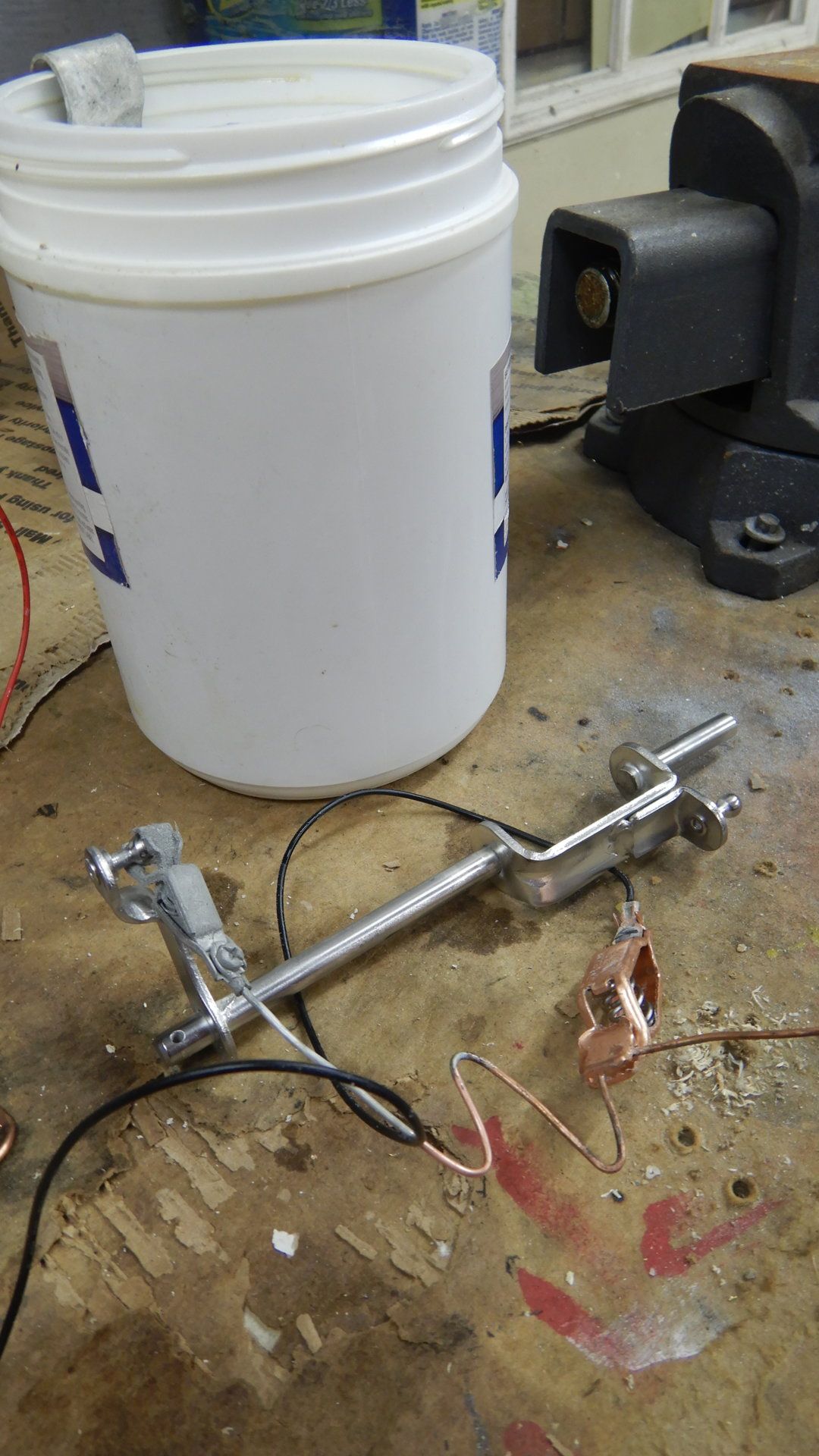

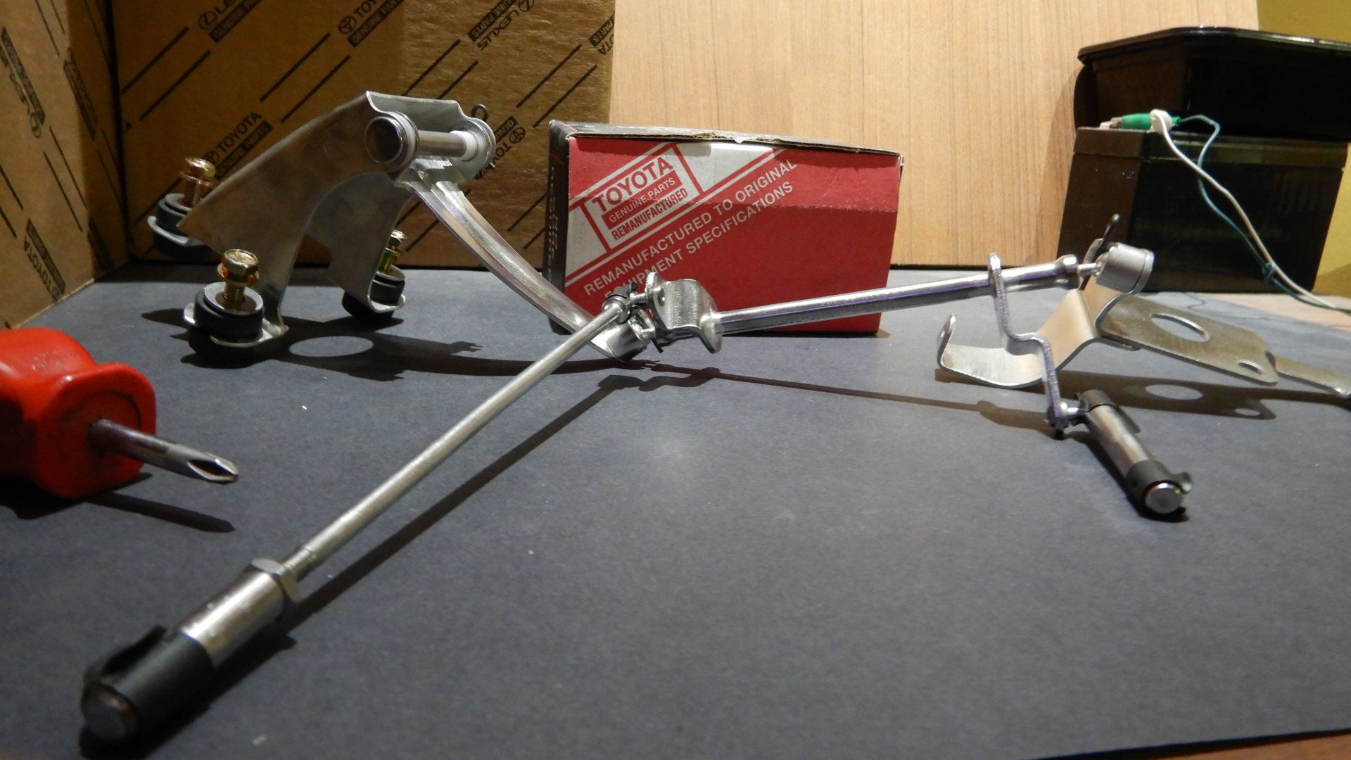

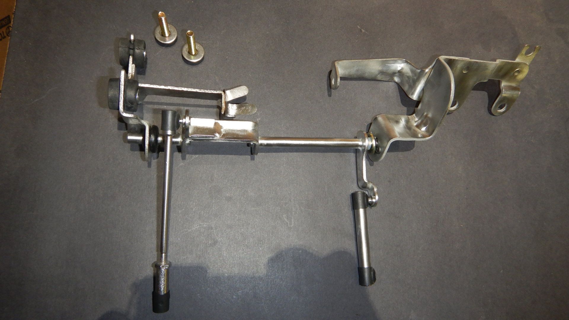

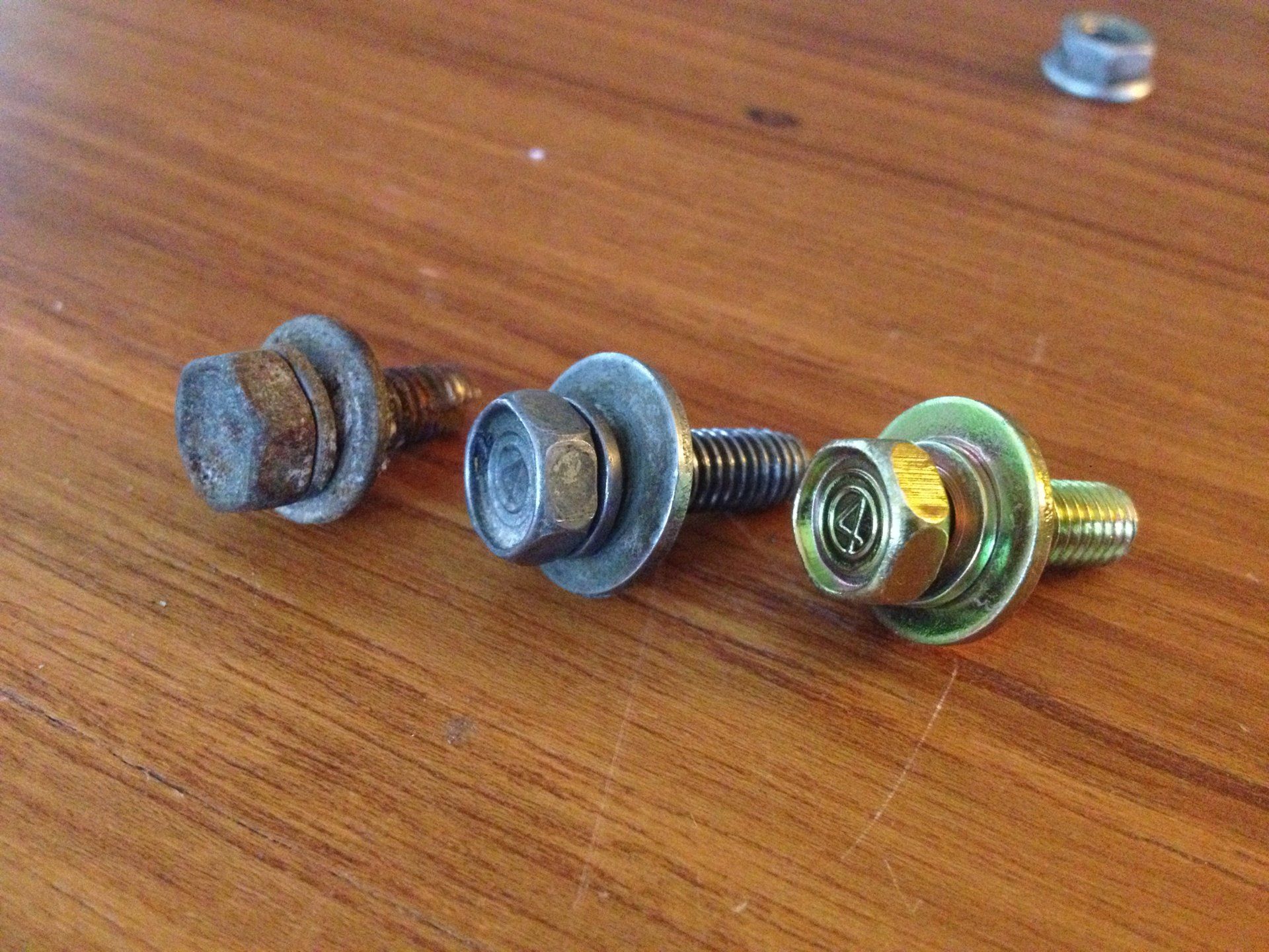

I may just be a bit anal when it comes to the details but The place in Nashville will do up to 125lbs for $55.00. They have told me they love to do my stuff because smaller clean batches get better quality control. I either Metal Restore, parts cleaner, wire wheel, and or blast then thread chasing all the hardware and brackets I want plated. I don't keep track of all of it only because I somehow remember nearly every bolt for every application. Don't ask me how. I've tried testing the rust resistance on their work and it has passed every time. I suspect it takes 20 hours at least to go through the entire process this way but it pays off every time. (At least I think so.)
Before/during/after

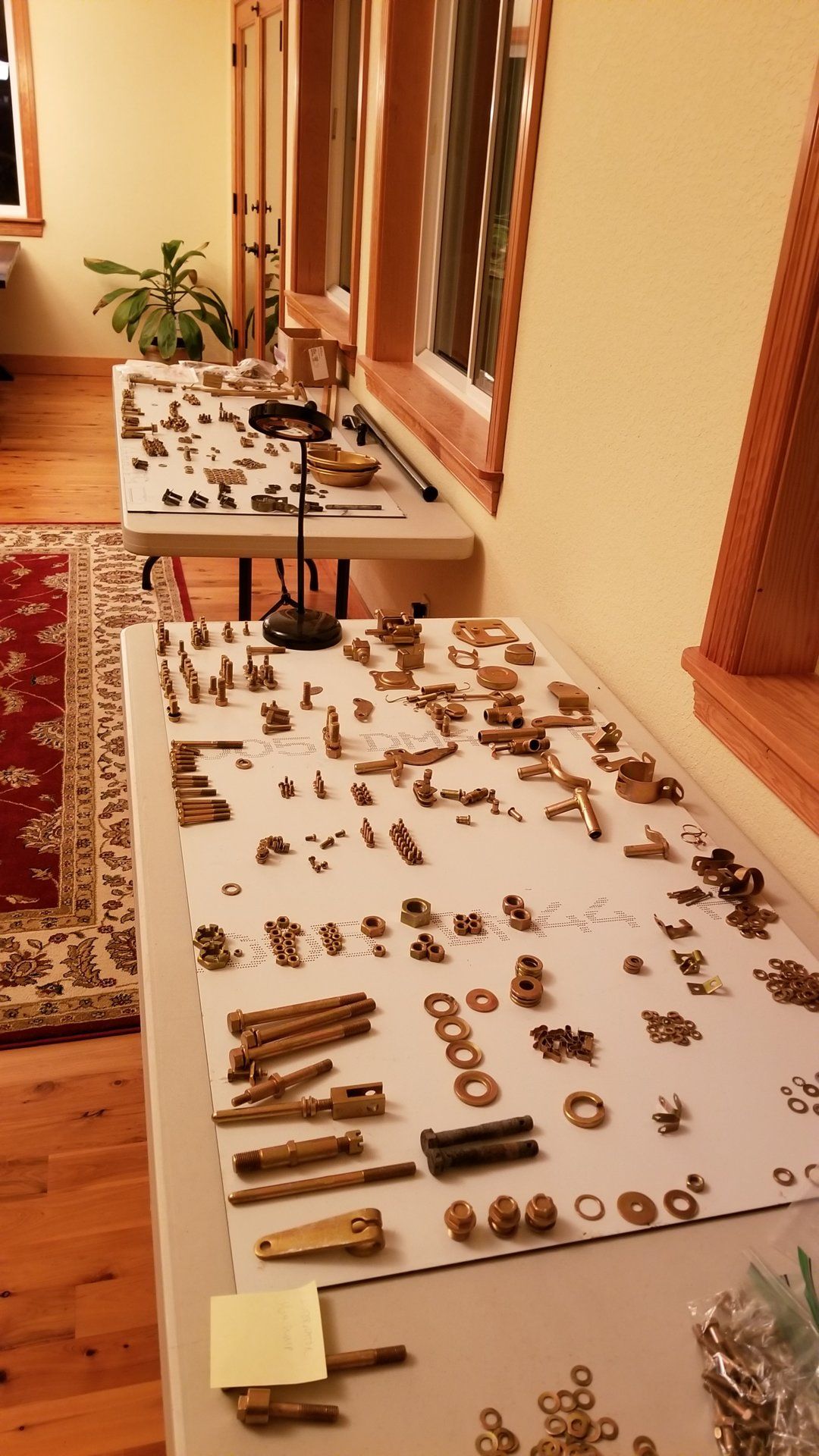

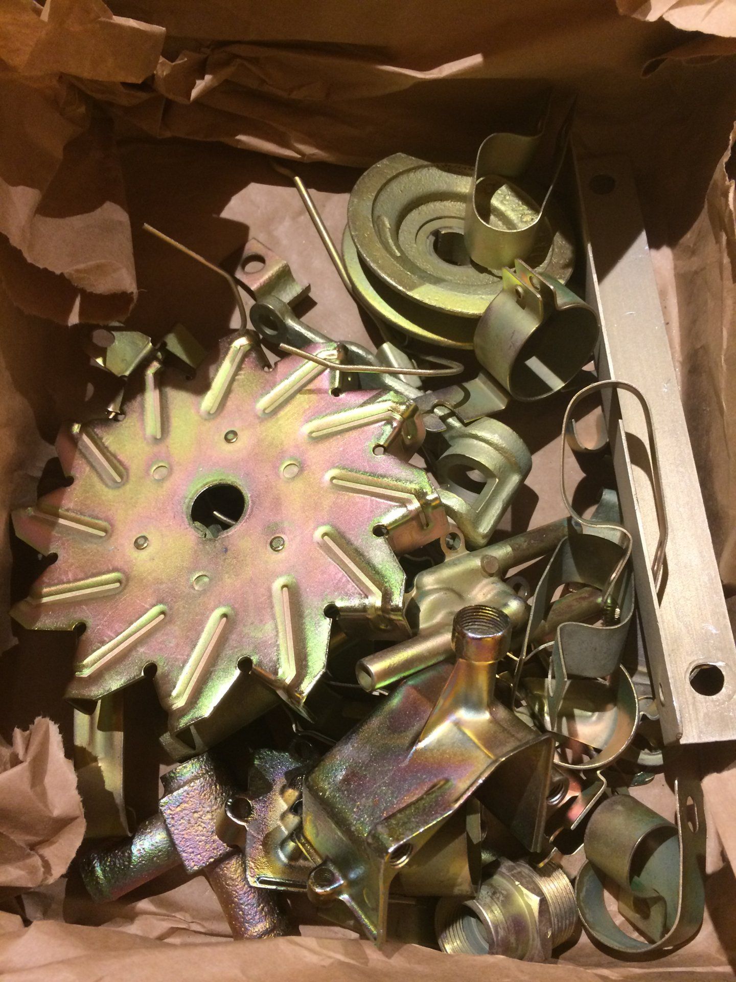

I sent my stuff (I sandblasted it first) to a place in Portland, Oregon (TFC Plating) and they did great work for very little money. Like $60 for a good sized box of stuff... just don't include anything aluminum, like the vacuum switch casing for the early Front Drive in the foreground of this picture. Looks good, but big mistake.
It's like Christmas when they come back!
Before/during/after
