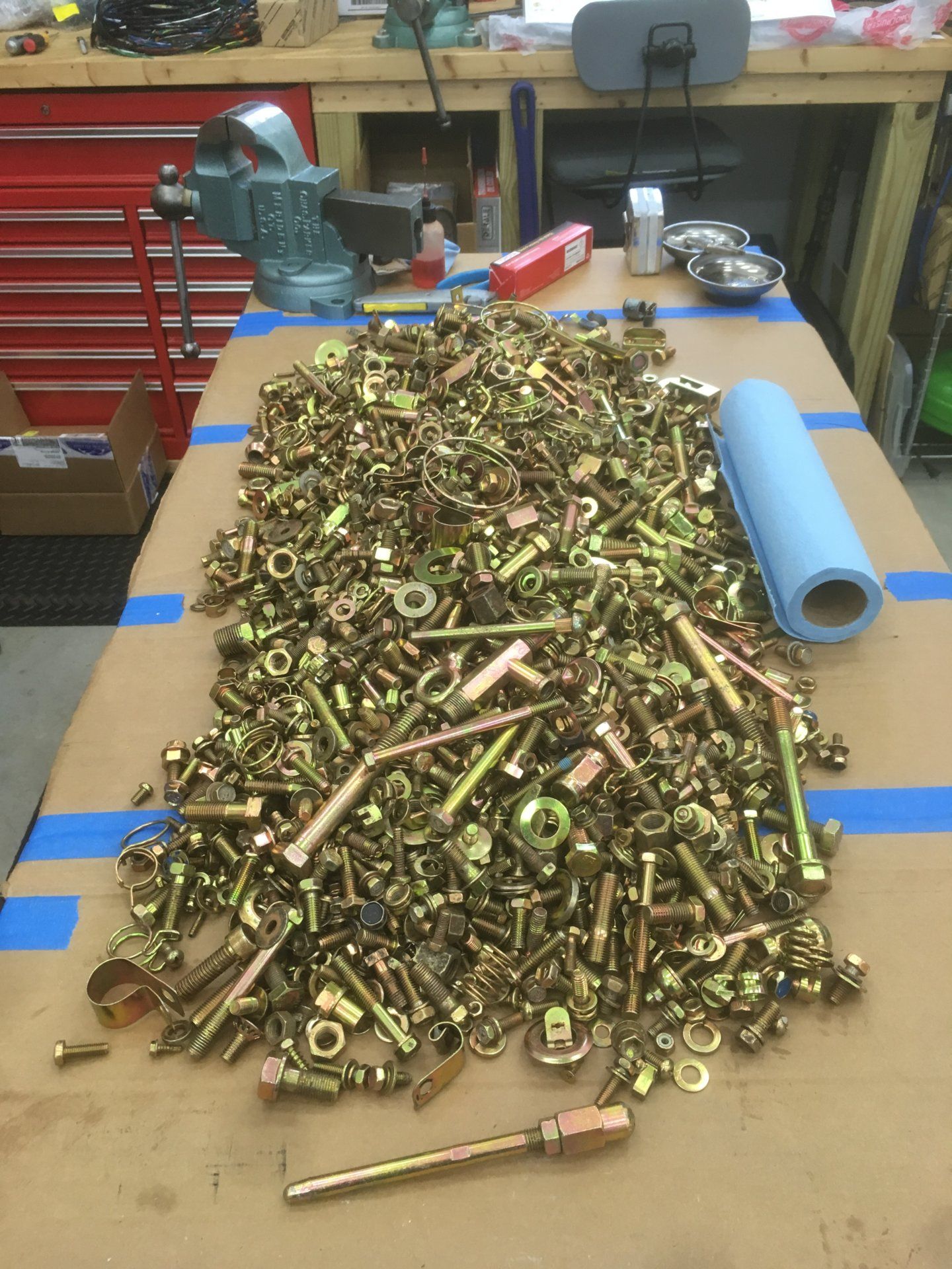

Obligatory pic of said hardware pile. Sorting it was a chore!
Also some hindsight and for future plating I do...ALL and I mean ALL paint must be removed. Their cleaning and acid bath will remove rust but doesn’t remove paint. Some of the bolt heads still had paint spots on them (I just tumbled all these parts in the large HF vibratory tumbler with walnut shells).
If you want the parts to be as close to perfect as possible then blast them with a glass bead. The zinc plating will magnify any imperfections...which may or may not be an issue depending on the part. There was zero chance I was going to blast all this hardware...

Yeah how in the world do you remember what goes where?
