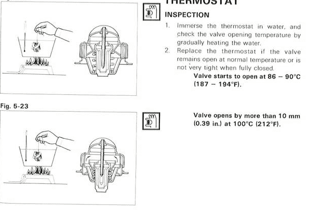

Just for some context, I build my own engines in my hot rods and have quite a bit of wrenching experience. The display on my factory gauge, the temperature of the air blowing through the heater cores and the not-too-hot-to-touch thermostat housing and limp upper radiator hose ALL suggest that the engine is running well below the temperature that it should!
Unless there is something plugging the system from properly circulating, and the coolant inside the block is just COOKING, and my factory temp gauge is broken, which is possible, but seems somewhat unlikely. Just a lot of signs pointing towards not getting up to operating temp. While I didn't test it by seeing when it opened in a pot of water on the stove, the old thermostat came out in visually good condition, and there was no change with the new thermostat. I can check it by checking the actual opening temperature in a pot of hot water, I assume that the opening temp of the thermostat is not the culprit, unless it's very common for the thermostat for this application to not open at their intended temperature. I'll check it tomorrow, to be thorough.

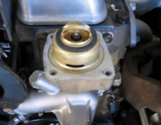

Neither the old or new thermostat is/was stuck open. the old t-stat gasket was in place, and I carefully placed the housing over my thermostat and gasket that were placed like those pictured above.
Though, I do recall thinking while looking inside the thermostat housing that an awful lot of coolant would be able to flow around the thermostat! I cannot picture exactly what made me think that, but I remember it looking odd to me when looking into the housing, from the bottom. Seemed like even with the gasket in place, it would easily flow around the thermostat, at least to the smaller 5/8" ish heater hose. I'll take it apart tomorrow and take some pictures. It didn't seem modified, or aftermarket, so I assumed it to be correct.
The below quote is what I did recently when my truck was running cold.
Maybe I'm just crazy but I put my t-stat on very differently than most. I unbolted the lower housing from the head. While the thermostat was still inside the housing I could look in and see the top gasket was dislodged. That top gasket can easily slip out of position during install. After cleaning up the mating surfaces, I put the thermostat housing assembly together on a bench. I turned the top of the housing upside down and put the top gasket in first, then put the thermostat in upside down making sure the gasket is centered and the thermostat is sitting flush on it. Next I coated with rtv the lower gasket on both sides and put it on the lower housing. I turned the lower housing upside down and carefully put it on the mated surface of the top housing. Then holding it all tightly flipped it over and installed and tightened the 4 bolts. Next holding my thumb over the oil cooler hose attachment I blew in the top hole to make sure that I had a seal and no air was getting by. Lastly I replaced the lower (housing to head) gasket and with some rtv, bolted back on the head. This can get a little tricky with other stuff in the way but is doable. Probably not the normal way but made sense to me to be able to check the top gasket.
Get an OEM thermostat so you know your at the right engine temps. Check the old one for cracks. See if the spring is holding it tightly closed.
