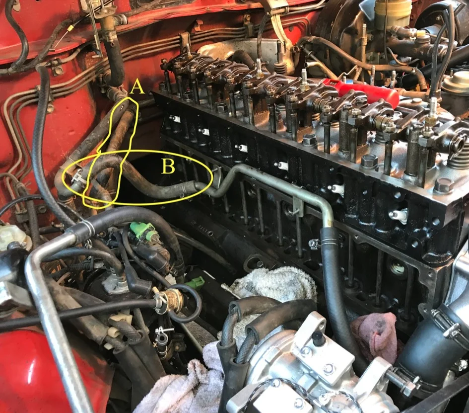

Makes sense. Do you know where I might be able to find a diagram? I woukd like to visualize the layout so I can trace it. Thank you.

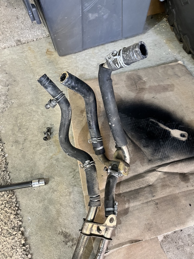

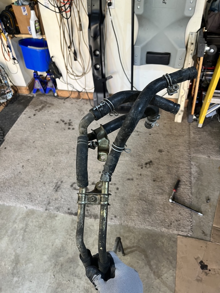

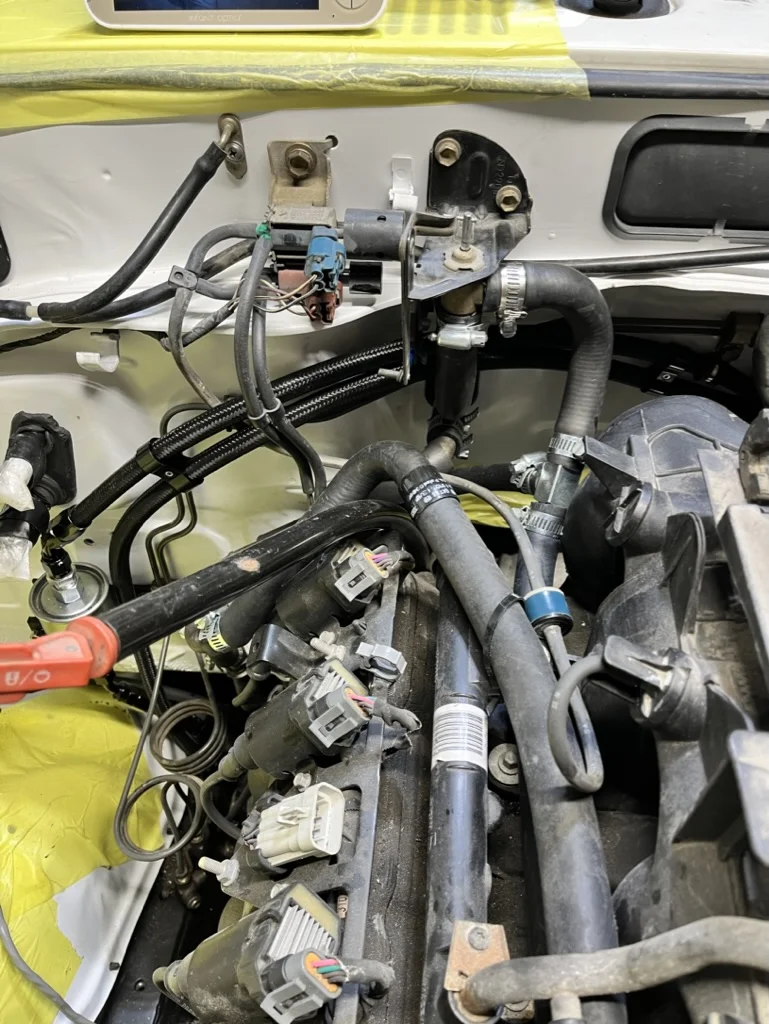

Here are a couple pics in case they are helpful. First pic with the red firewall is someone else's stock setup. Bottom pic with white is on my 5.3 swap. Middle pics are the rear heater hard lines with soft lines still attached.
