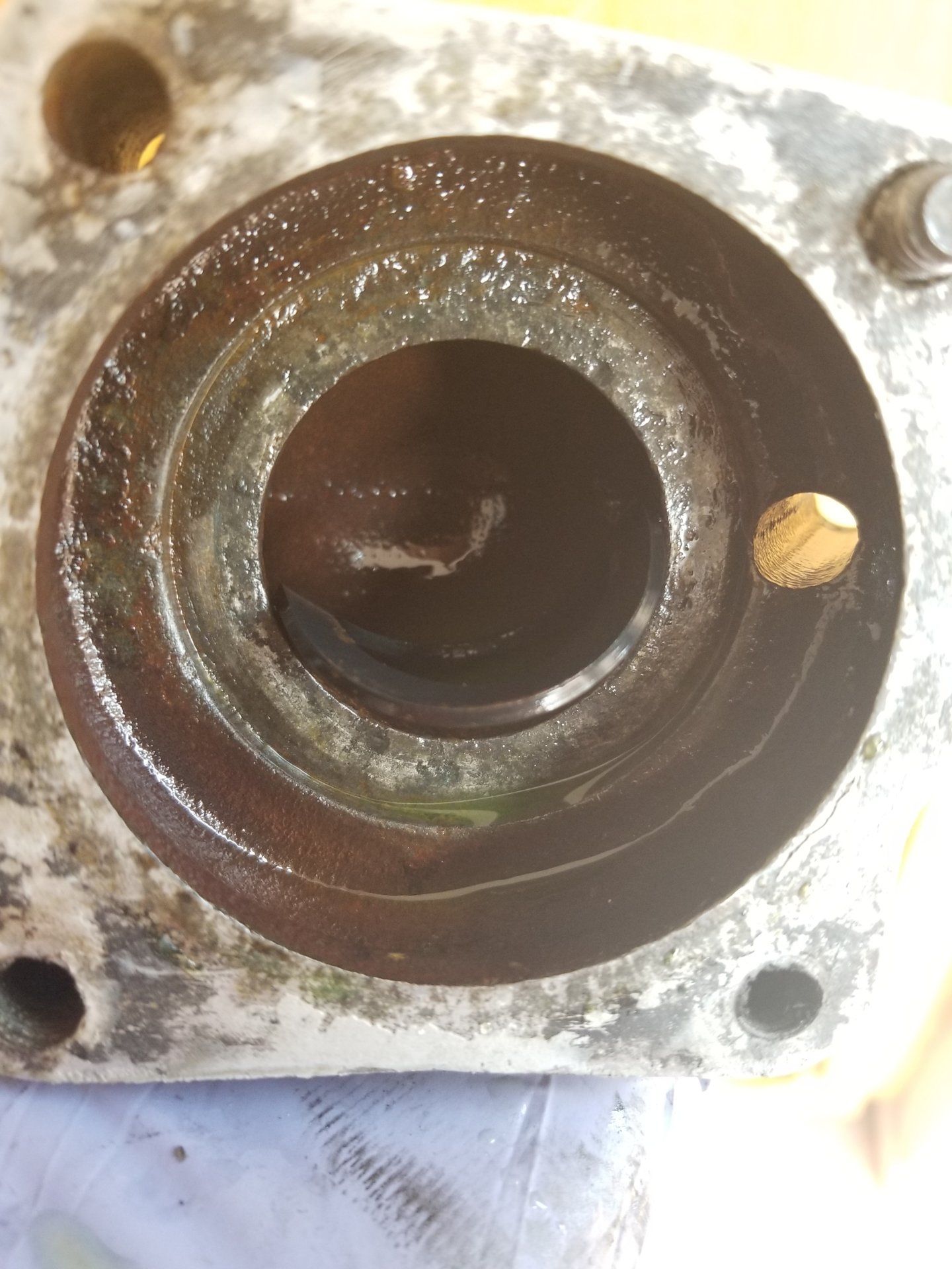

Here it is! This is exactly how the gasket looked when I pulled the housing off. Wasn't careful enough! Gonna go grab at least the Toyota gaskets, MAYBE the Toyota thermostat, too.

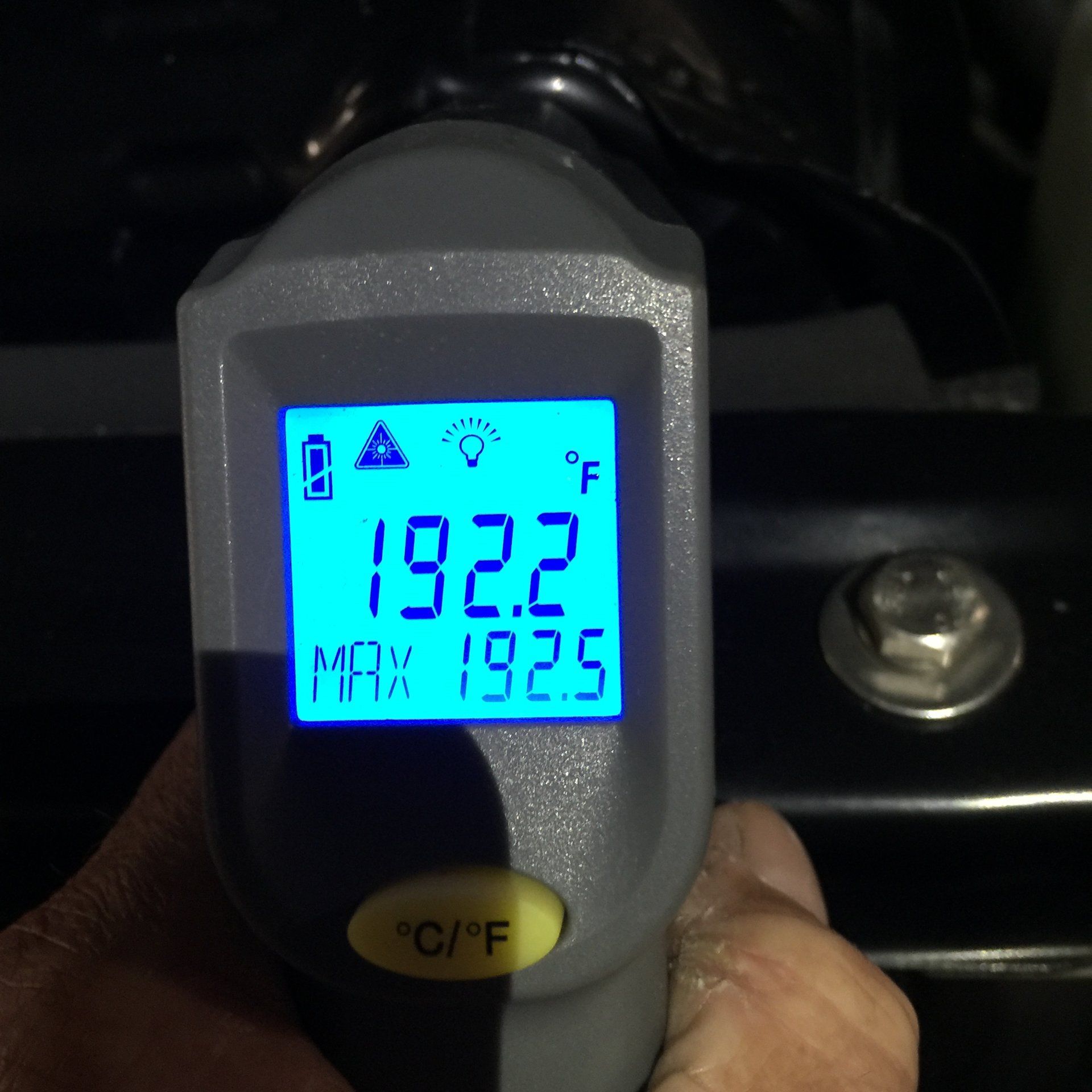

Thermostat opening and closing correctly. I also learned that my laser thermometer is not all that accurate!

I don't see a gasket here. Looks like the lower t'stat housing. can you explain what I'm looking at.
looks like the upper part of the housing, the rubber gasket is up inside the opening, you can see it inside the opening at 6 oclock
ahh! now I see it. stuffed up in the passage.
