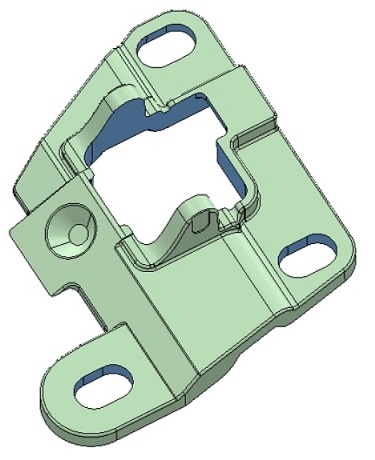

Yeah... a few things to answer there. Shapeways already upped the price of that technology - now it's $5 plus a part volume fee. Each part is coming out to $29. Jerks. That's an awful lot to pay for a non-molded part, IMO. Even if it does perform just as well as the real thing. Regarding having the part molded, here is my math...

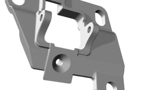

  • Injection Mold Tooling: $2200 (Aluminum Tooling, quoted by both Protomold and Xcentric Molding). At that price I'd still need to drill some holes after molding (called a secondary operation) since the "side actions" for the holes would double the cost of the tool! Not a deal breaker, but adds some time. Out of the mold it would look like this, before the hole drilling:
It should look like:
  • Per Piece Cost: $3 (Glass-Filled Nylon)
  • Anticipated Volume: 400 pieces (Assuming 100 pig owners in the world want a set of 4...)
  • Total Cost: $2200 + $3*400 = $3400
  • Recoup Cost: $3400/400 = $8.50 ea
Seems reasonable, right? BUT the questions are 1) how many folks would actually purchase these and 2) what might they be willing to pay? They're NLA parts, but at the same time they're just dumb pieces of plastic. My gut tells me you have a hard stop around $20/piece. If you sold them for $20/piece (bordering on highway robbery) you wouldn't break even until you sold 170 of them (about 40 complete sets).
So... my local molding resource, that when to sh!+, was looking like $1000 for the tool! If you do the math there, you see I'd break even much earlier (110 units) OR I'd be able to sell them less, say buy 3 get 1 free. Parts houses like SOR would charge more because they're pirates and because they'd spend the up front engineering costs. In this case my cost is free because I love my cruisers and this forum.
End of rant, for now!

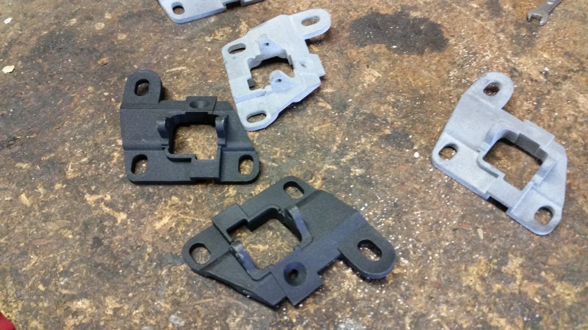

I had a couple extra printed. These are from the badass HP Nylon 12. If anyone is totally handle-less right now I can spare one. Think of it as beta testing 3D printed parts... You'll be obliged to give feedback to the forum!
Let me know.
