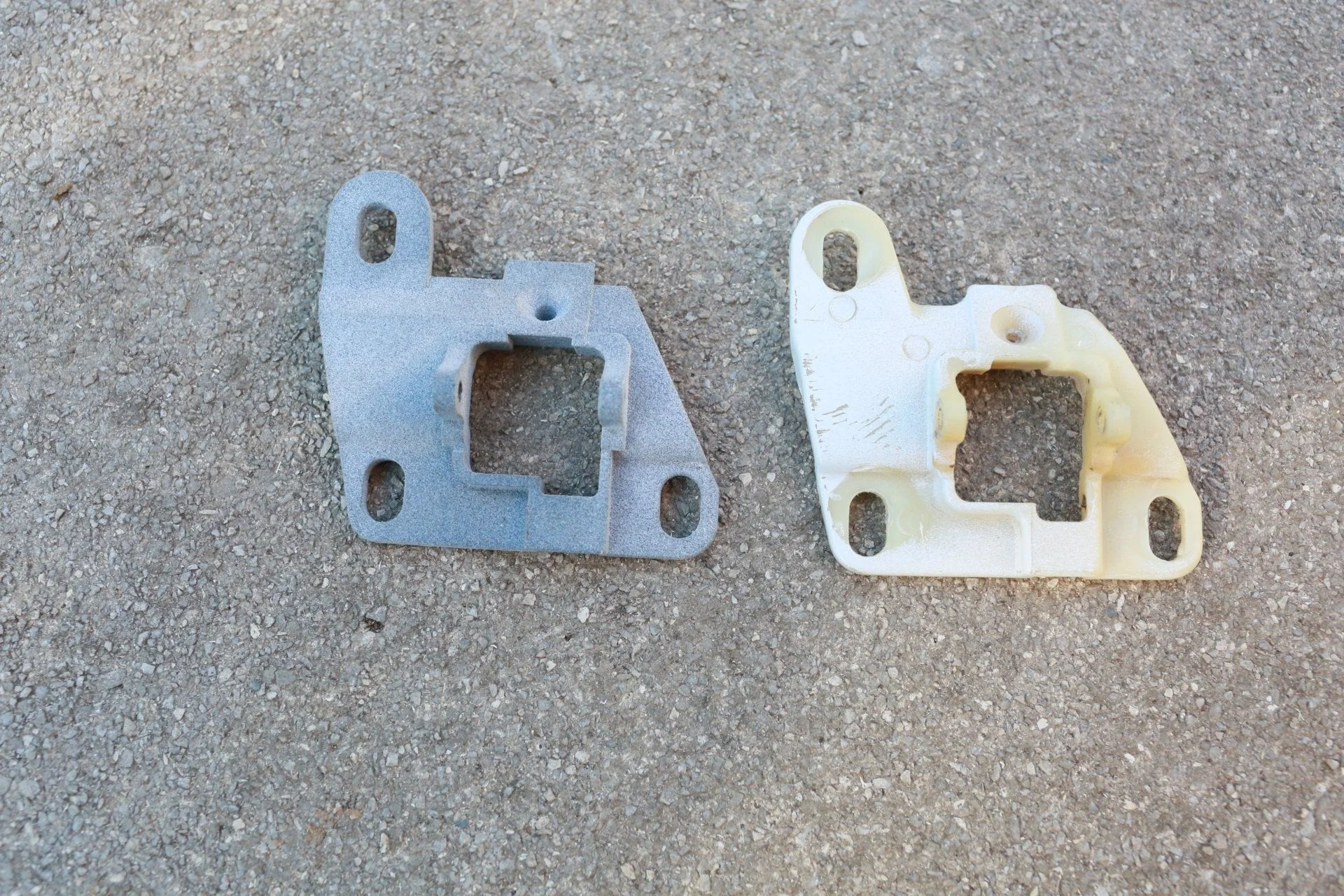

All right! Installed on my own piggy. Everything is friggin spot on EXCEPT I oversized the hole that secures the metal faceplate to the piece. Super easy change to the CAD model. Check it out:

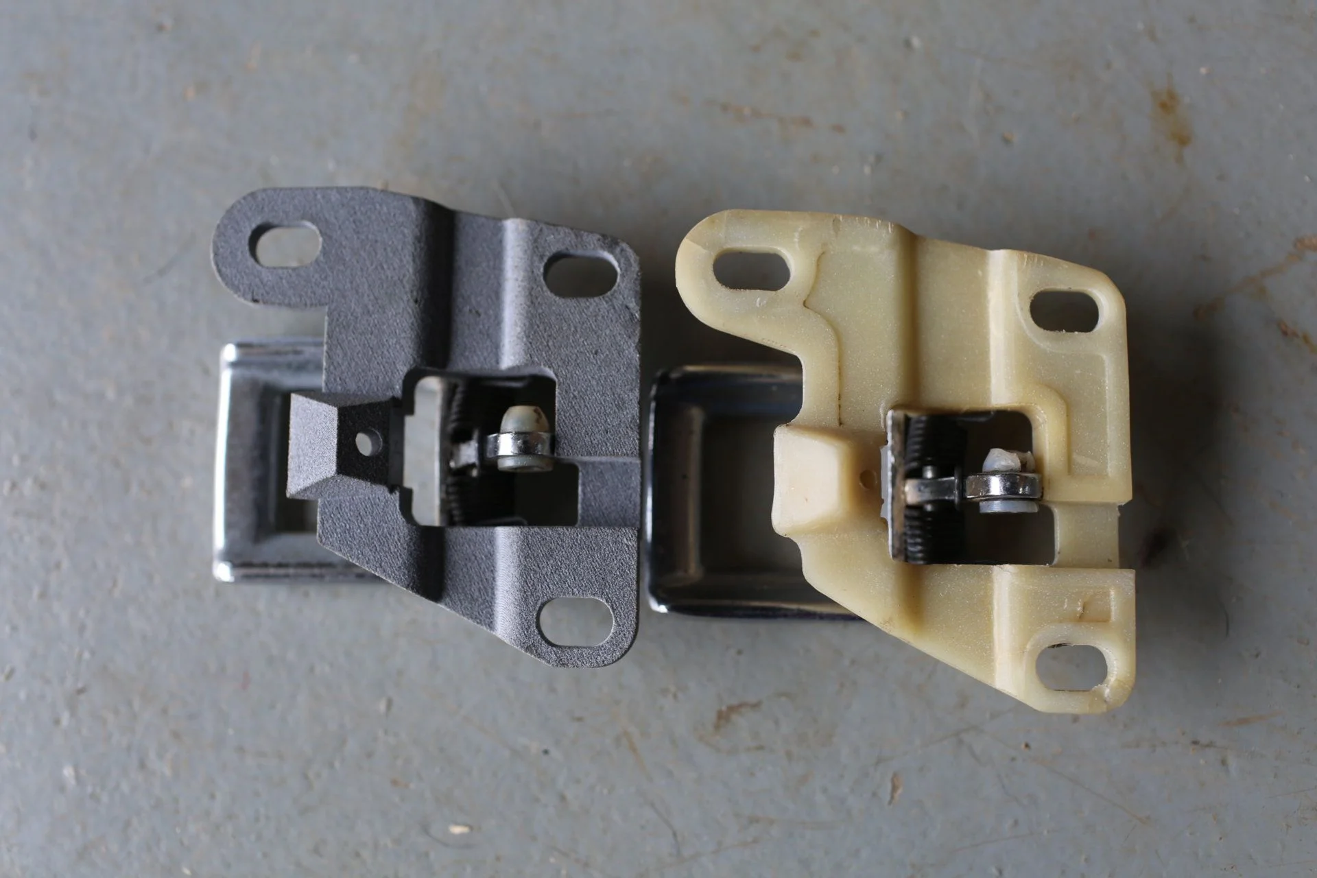

The results are in....
I tested the bracket and overall I think it was very well done. All the holes line up and the dimensions are very close with exception to the oversized screw hole for attaching the bezels (which @DoubleNickels already mentioned).
I checked for flexing when pulling on the door handle and it looked to have about the same amount of flex as the original bracket. This is to be expected for the Nylon material used and I wouldn't expect any breakages. Flexing is a characteristic of the Nylon and I think it is a good choice for this application.

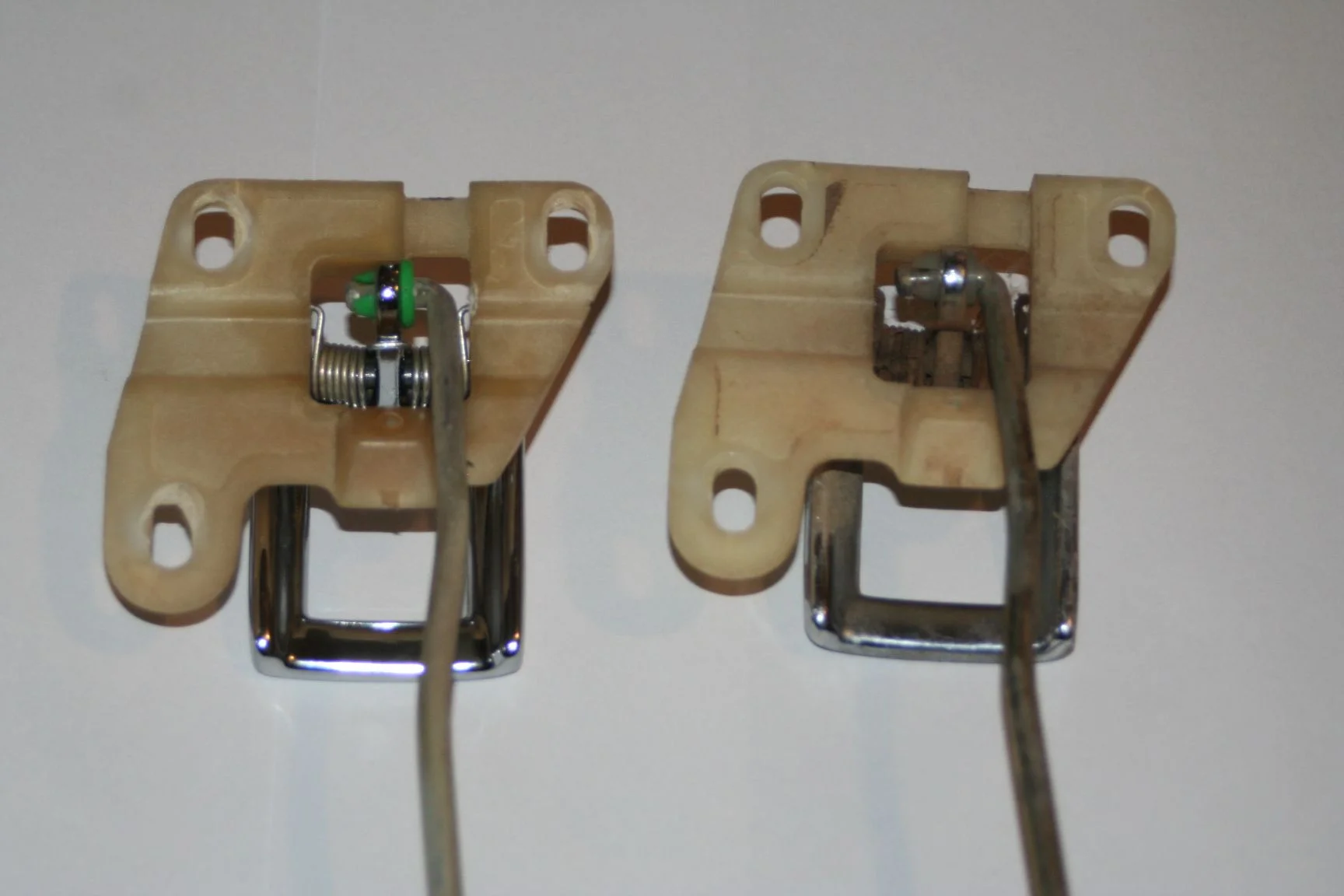

On the downside, I broke the little plastic clips that keep the rod in place. Does anyone know where to get these?
Here are some photos that I took.
