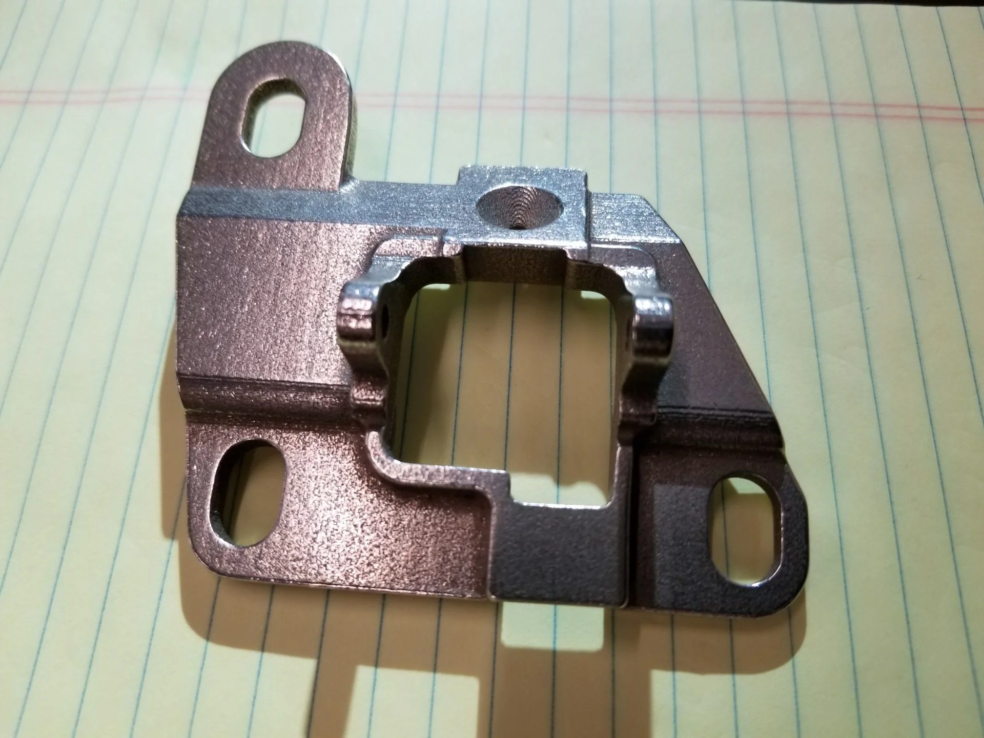

So we can print in sintered stainless?
@DoubleNickels said he put a 2.50mm through hole for the bezel screw, you would need to run a 2.5mm drill bit in that hole to confirm and tap that hole to M3 x 0.5 and use the appropriate screw if you have these made with stainless.

I received my brackets from Shapeways. I haven't had time to try them out yet, but I will post pictures when I do.
ok i orderd one in stainless , was 88.54 , . Now the aluminum looks good , mabey i will try that one next month

metal , damm its nice , heavy and solid
PS: that sintered metal polishes up extremely well. Hit it with your wheel of choice, make it shine!
