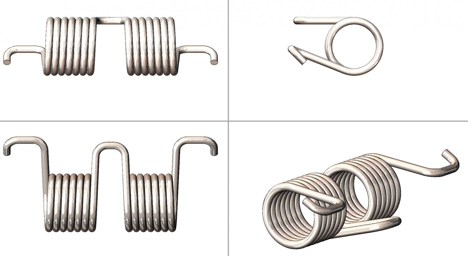

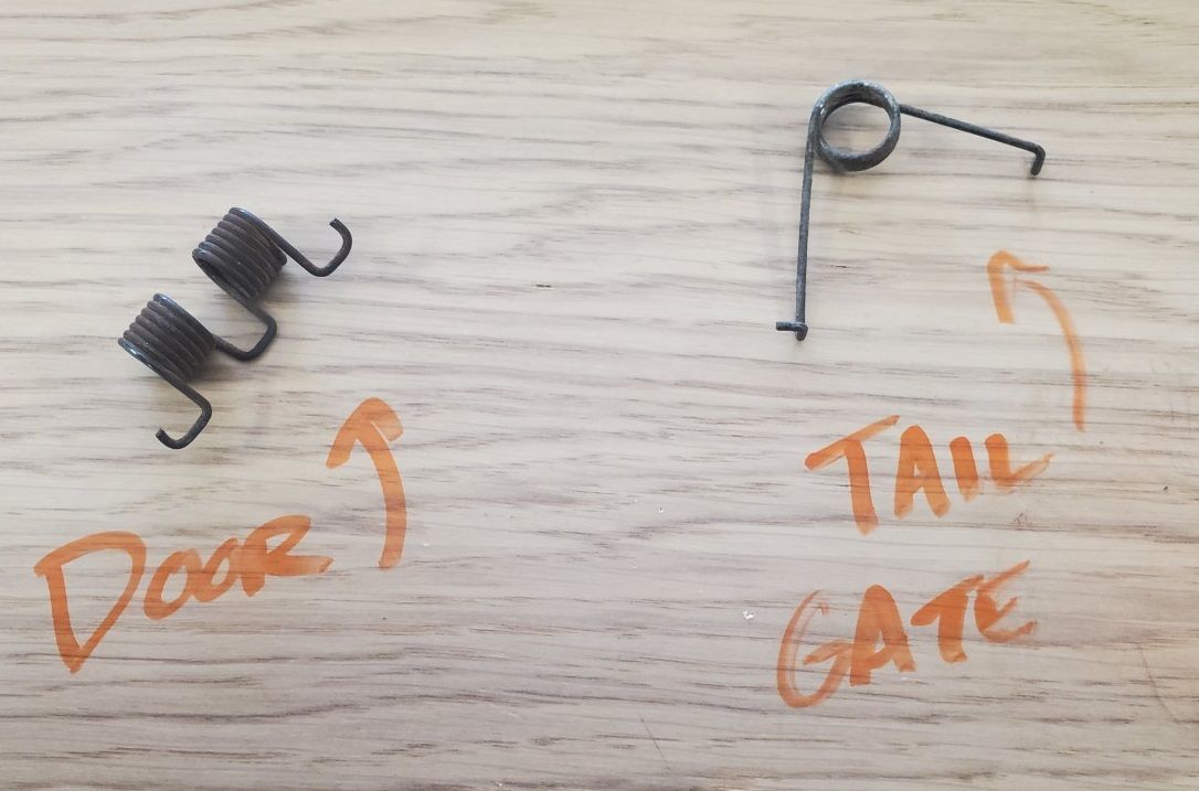

Carrying on from the previous thread regarding tail gate springs and door latch springs (this thread), I'm undertaking recreation of both. Ron (@scrapdaddy ) generously mailed me one of each.
I have a spring kit and am feeling confident I can hand-build the tail gate springs. I'll post pics of my attempts and refinements. The door latch spring is a finicky little part, however, and I'm going to try and source a small production run from a spring vendor. With springs, you don't typically see massive discounts when you order in quantity since there is rarely any tooling required. All vendors need is a CAD file, and I'm already there:
I'll see what vendors are asking for this part, and will meanwhile try to verify my geometry via 1:1 prints and perhaps a 3D printed version with representative dimensions. Stay tuned, and thanks again to Ron for helping this happen.

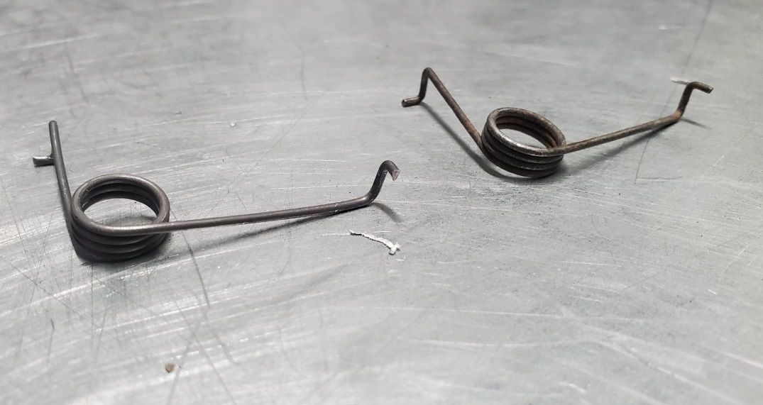

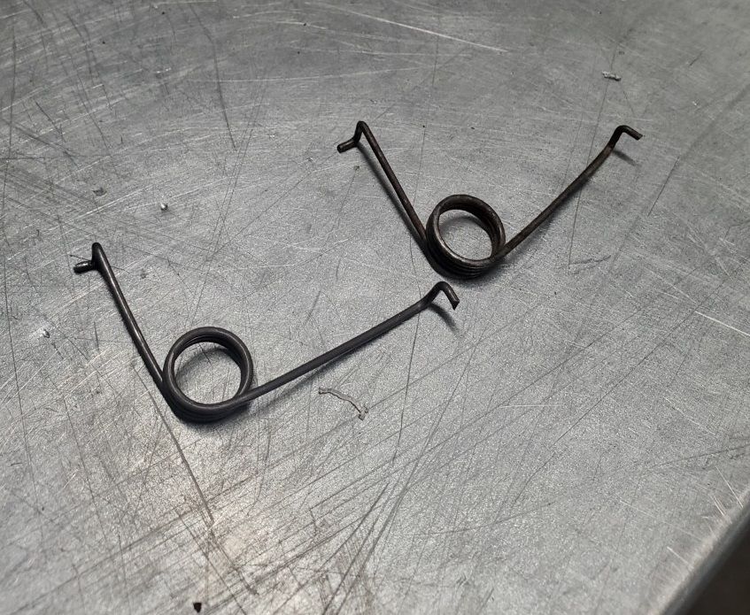

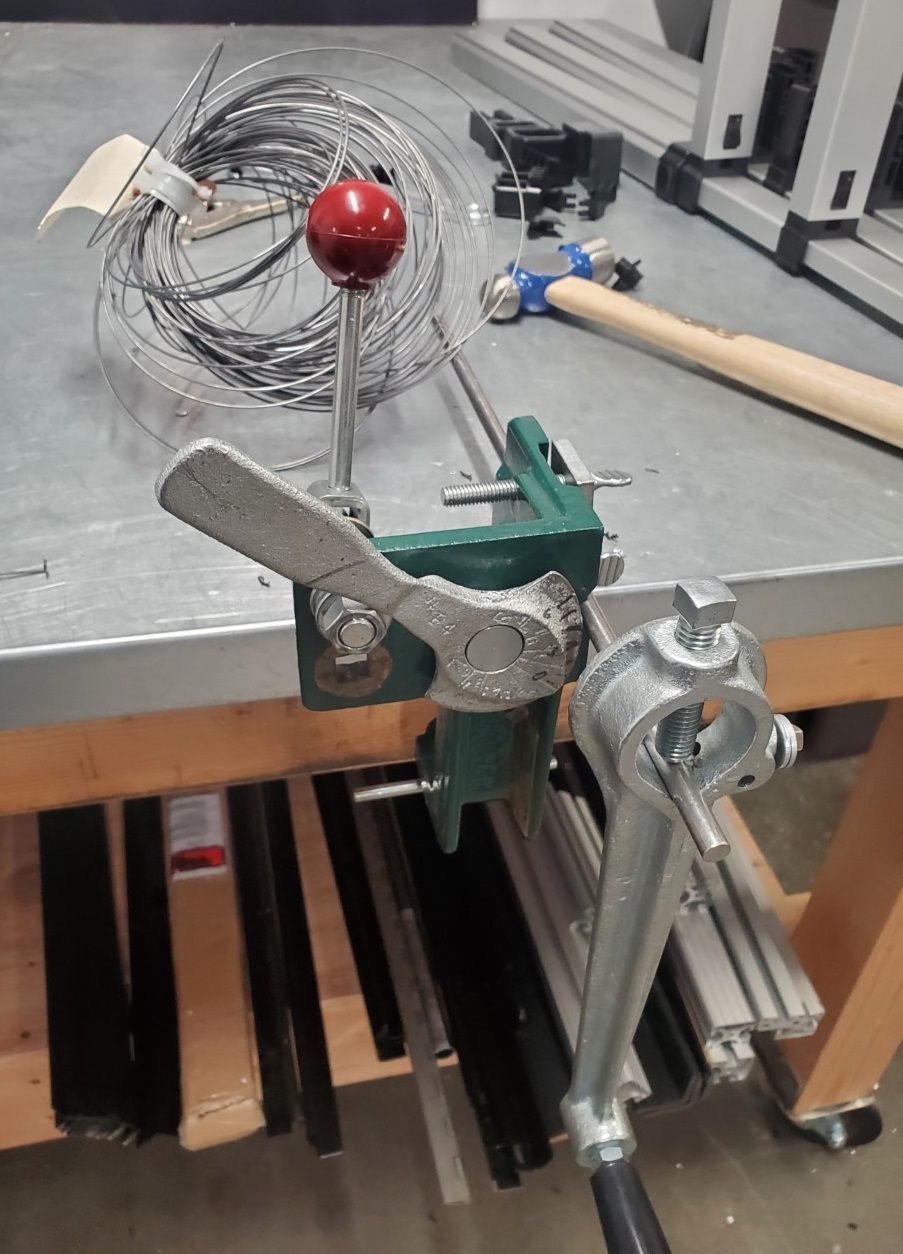

Well well now. Pretty darn good results for my first pass on the tail gate spring. Here is the little bench-top spring former I'm using:
And here are the results. Original on the right:
A wee bit labor intensive. I'll refine more and report back. Cheers!
